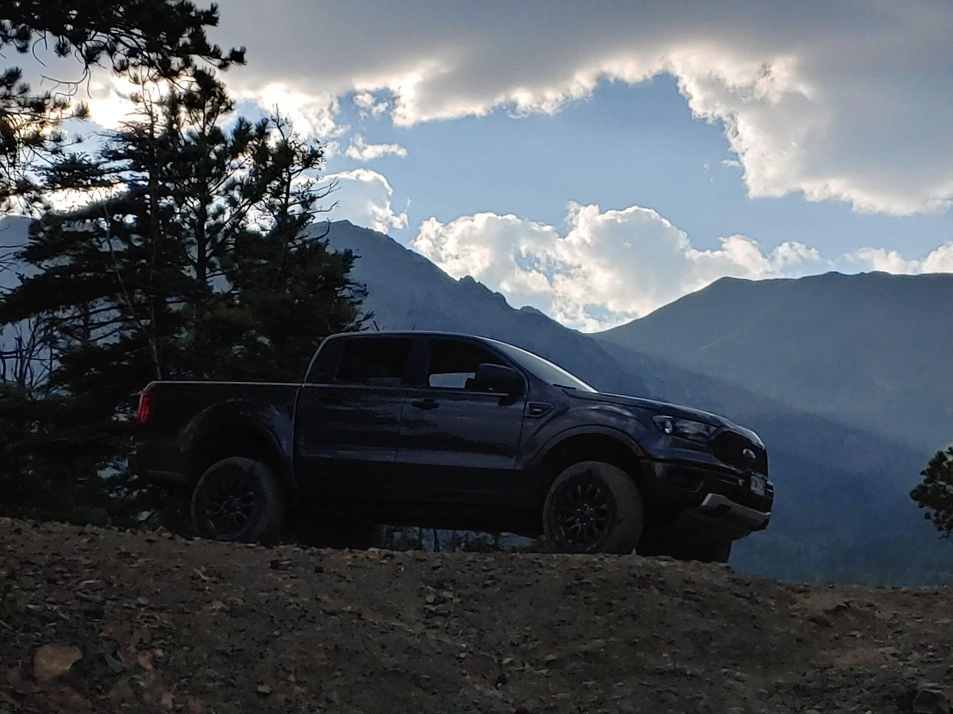

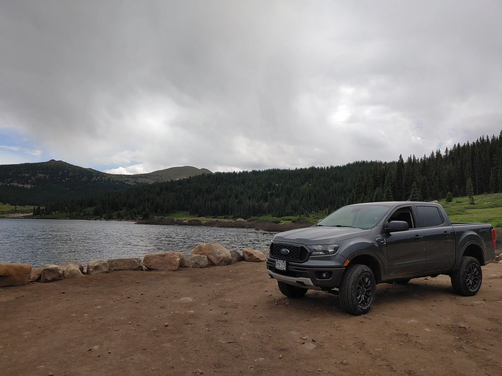

So hopefully I can provide you the best answer on this. I myself own a 2019 crew cab 4 by 4 sport model. Yes it is an XLT no I do not have the FX4 package. I myself took some time to decide on what I was going to install on my truck for a lift or level. Why did it take me a bit of time? Well I wanted to make sure I was going to get the right stuff for my truck for going off-road while keeping my truck good enough for a daily driver. Originally I was going to go with a fox kit and probably find either blocks are shackles depending for the rear because 4 off-road you're better to lift the truck versus just leveling it. It wasn't much longer after that that old man emu by ARB released a lift kit for the Rangers here in the United States. I decided to pick that kit and I can tell you I am very impressed. You get shocks on all four corners along with new springs for the front and the rear. The front gets lifted 2.4 in and the rear gets lifted by 1.6 in. It does not come with any control arms or any other parts because no other parts are really necessary. On top of that I also put bigger tires on. The tires I went with are 265 70 17 Bridgestone Dueler a t Revo 3. Overall I'd say it's a good combination but I do plan on getting bigger tires in the future when my tires do wear out. How has the right quality been? The right quality overall has been very nice compared to stock. Can I still tow with this suspension? Absolutely I can. I actually have towed 5500 pounds with it and it did just fine. How well is the clearance going off-road? The clearance is very well and it could be a little bit better with bigger tires which is why I'm considering that in the future. Now you're probably wondering why I only went with the old man emu lift kit versus other lift kits. It's quite simple when you think about it. This lift kit provided replacement leaf springs for the rear which allowed better articulation in the rear versus if I were to just add blocks or change the shackles. I was able to prove this in one little area in Colorado for off-road both stock and modified. Mind you I don't have a locker in my truck.
I should also add that for most four-wheel driving the most practical lift kids are going to be between 2 to 3 in overall anything higher than that starts to make the vehicle unsafe to drive.
I hope this helps you out. And here are some pictures of the truck.
