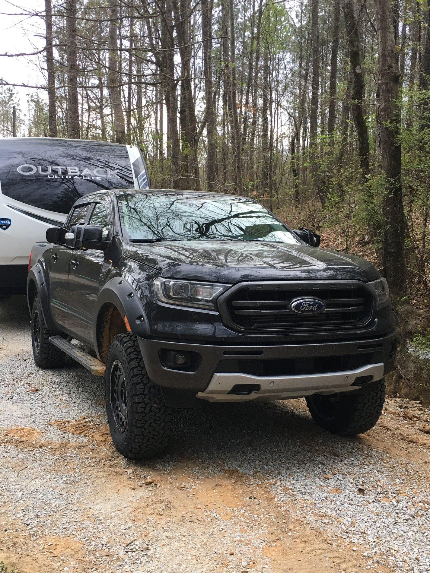

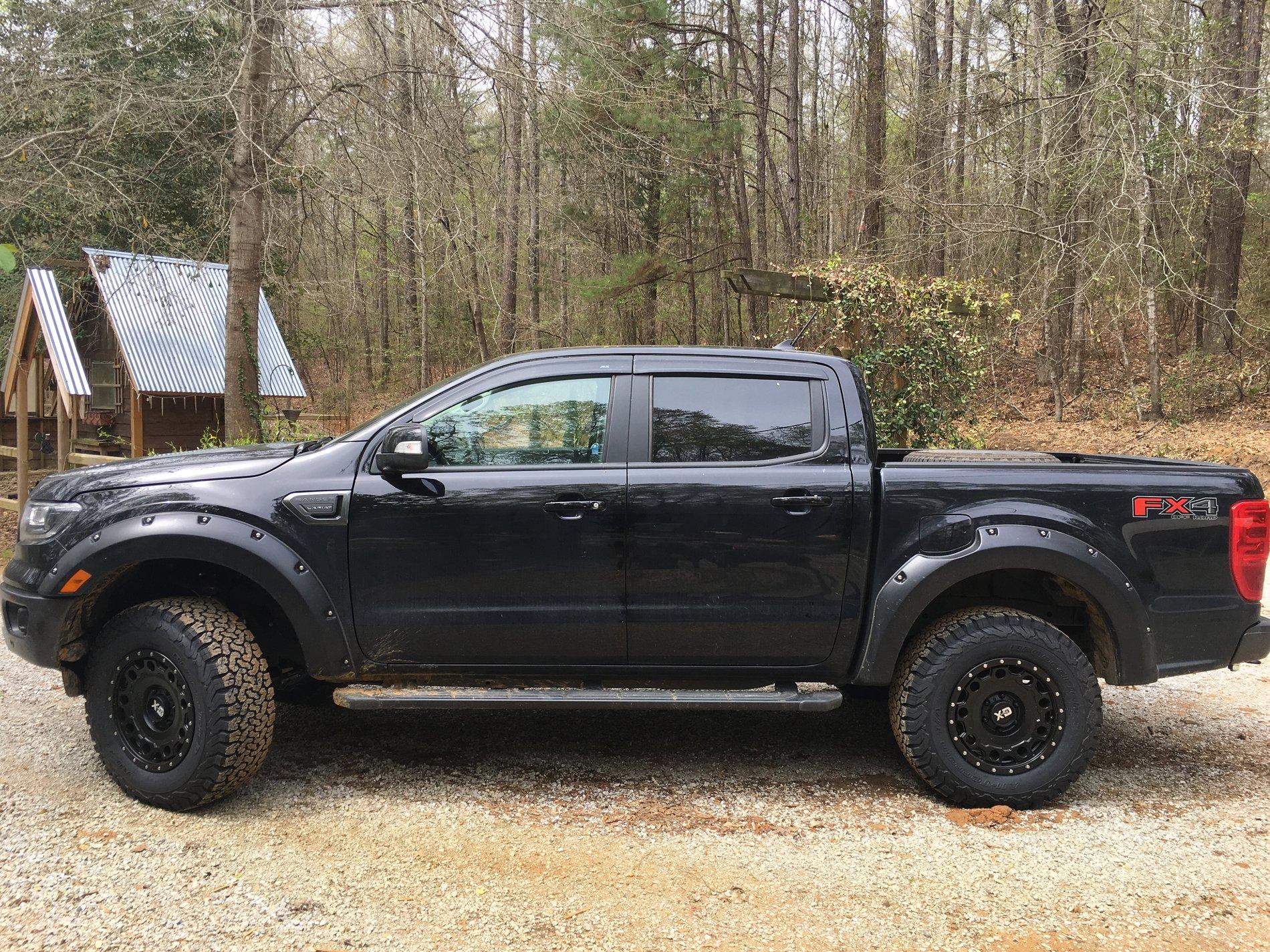

I tried the Rough Country and had some issues but it’s ok, rides rough. I replaced it with the ReadyLift 3”SST lift (which lifts the rear 1”). It fixed the roughness. It rides factory smooth because they preserved some rake with the rear lift. I really like it and for just over $300 bucks it ads the truck look a little more tough as well.

Another view
Sorry, not trying to hi-jack the thread! What offset are those wheels you're running? I'm considering the Bushwacker flares as well, but want my tires to be a little more flush than what you've got.

If you want flush with the flares, go with 25 positive offset. These are 34 positive and kept them where I wanted, just inside the flares. I drive a lot of gravel roads and didn’t want to sling gravel up the side and ruin the paint
