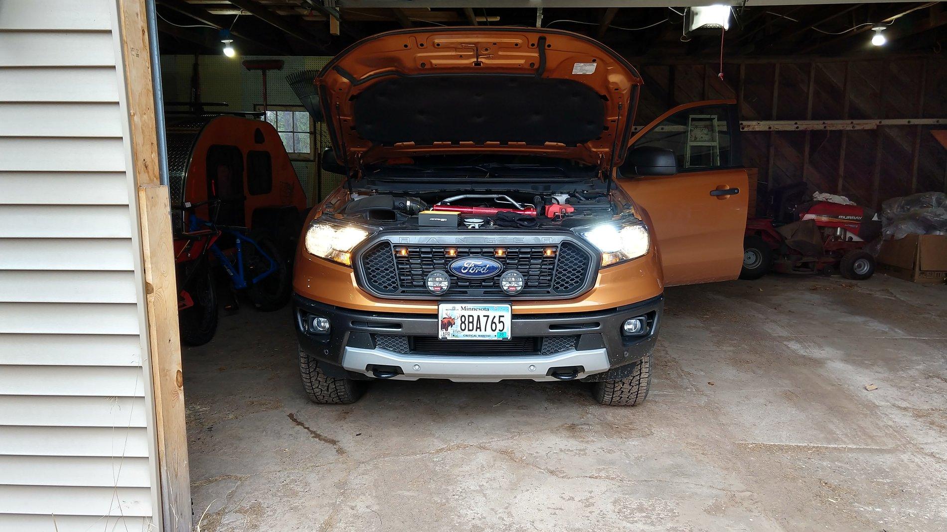

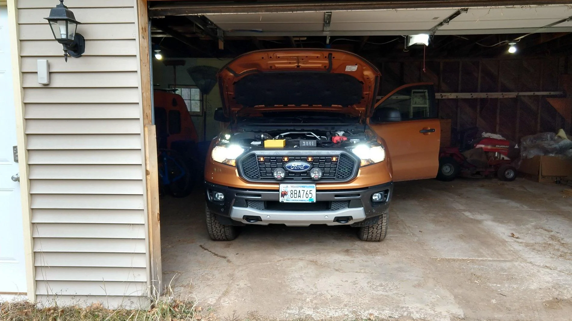

Got my LED high beams on Saturday and installed them on Sunday. Took all of about 20mins to change out both, and most of that time was spent taking pictures and looking at how bright they are. Hard to tell in the pictures since it was daytime out and the light messes with the camera, but the new ones are crazy bright! Tried them out quick this morning during twilight and I have a feeling I'll enjoy them very much! Should get quite a bit of use out of them now that it's dark going to work, and coming home from work.
Fog upgrades should be arriving today. We'll see when I can get around to installing them.
Driver's side LED high beam, passenger side still the halogen high beam
Both low beams still halogen
Both high beams upgraded to LED
