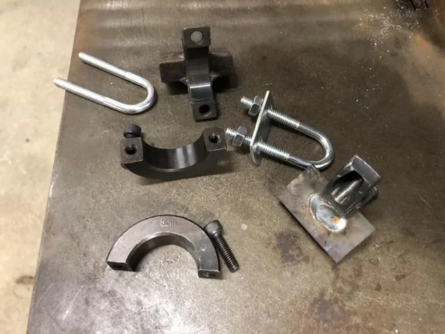

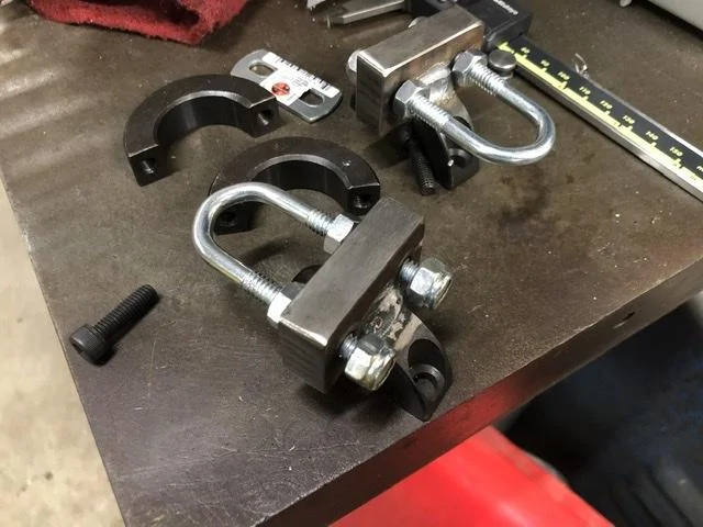

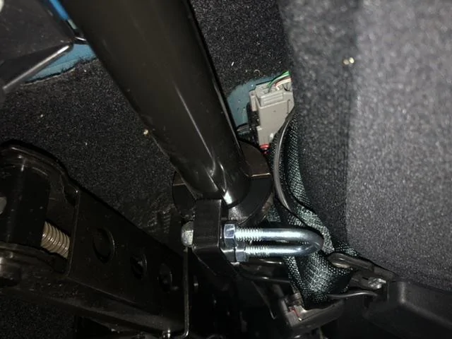

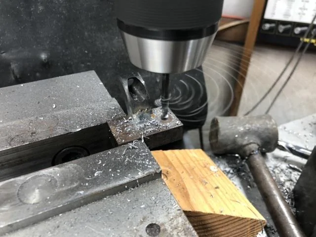

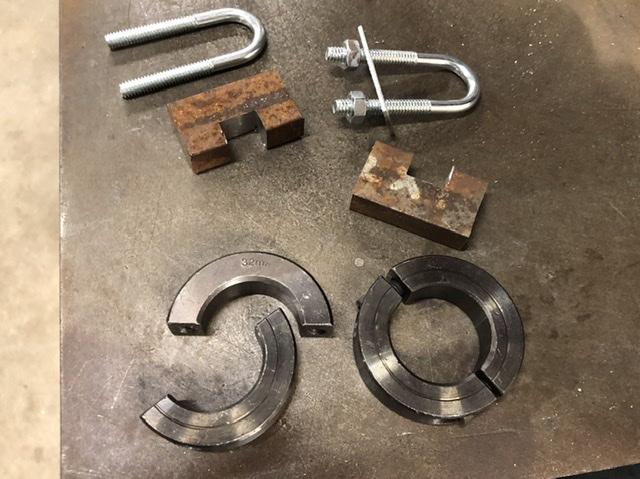

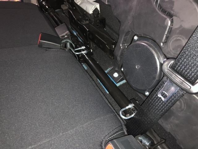

Our first curtain climber arrives in October ? Putting the passenger seat on the dash to get a rear-facing infant seat in is a no-go. Besides, the center is safer in a T-bone situation. I was surprised to find that the center position doesn’t have any LATCH anchors. Fortunately, the support bar that runs behind the seat makes things easy to attach to. I used a 32mm shaft collar, a 1/4x1” U-bolt, and a bit of stock that was laying around.

I personally would much rather use the manufacturer-specified and tested solution for a safety-critical application than something homemade.
Very true. I will see if using the side anchors makes the side seats unusable. That would be my only concern.

I’m still using these but by now we have switched to forward facing. The side anchors were too wide to get hooked up.
