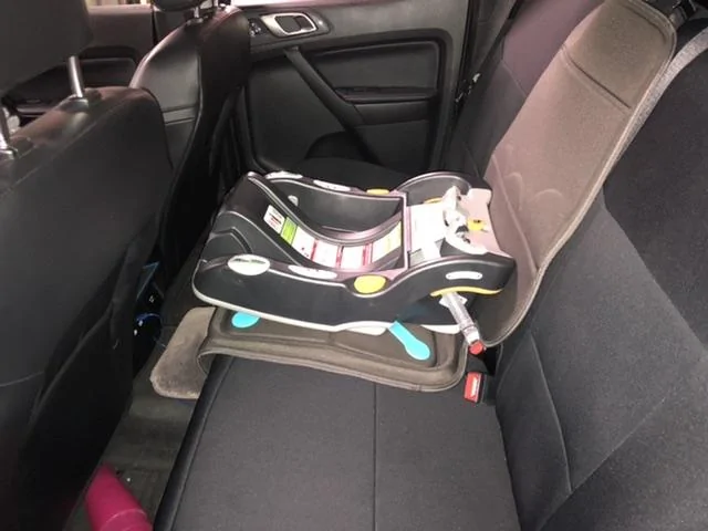

Our first curtain climber arrives in October ? Putting the passenger seat on the dash to get a rear-facing infant seat in is a no-go. Besides, the center is safer in a T-bone situation. I was surprised to find that the center position doesn’t have any LATCH anchors. Fortunately, the support bar that runs behind the seat makes things easy to attach to. I used a 32mm shaft collar, a 1/4x1” U-bolt, and a bit of stock that was laying around.

Sorry about your trouble @rltriumph I was able to confirm today that we don’t have an in-car inspection here in MO. I think we have to bring a car seat inside to prove that we at least own one, and maybe watch a video or something. Anyway for me it would have been a smile-and-nod situation too.
The seat fits really nicely between the two front seats. I didn’t have to move either from our normal positions.

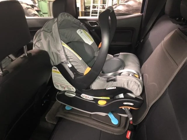

This is what I do without issue.
I couldn’t get my belts to reach out to the outer seats. If I could have, I wouldn’t have messed with the new anchors. We are doing this in our Escape though. I always felt like the two cabins were nearly the same size, but this exercise proved that the Ranger is quite a bit wider.
