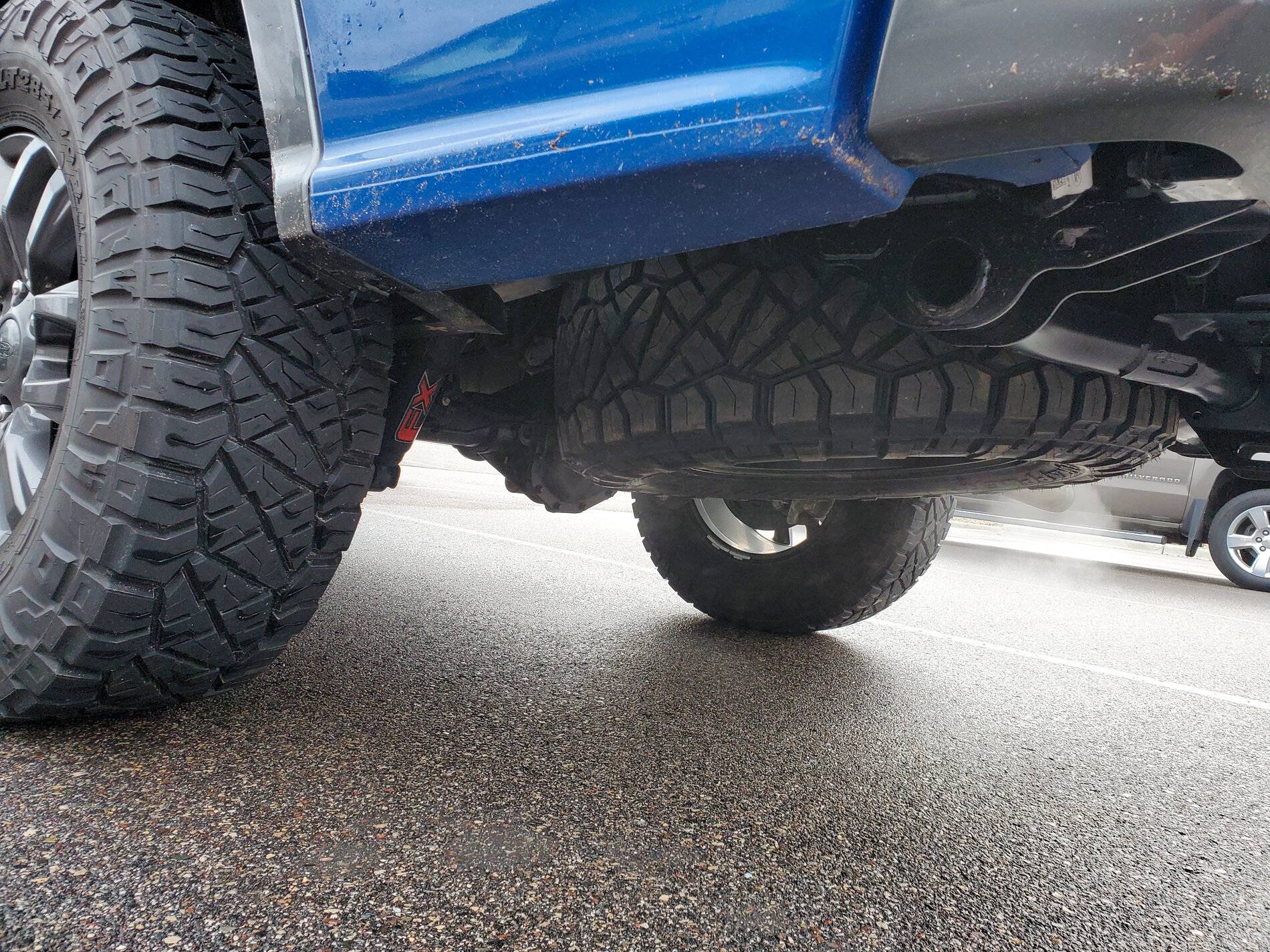

When I had a 04 F-150 I was impressed that a 35” Tire fit underneath. I assume with the ranger there is extra room as well

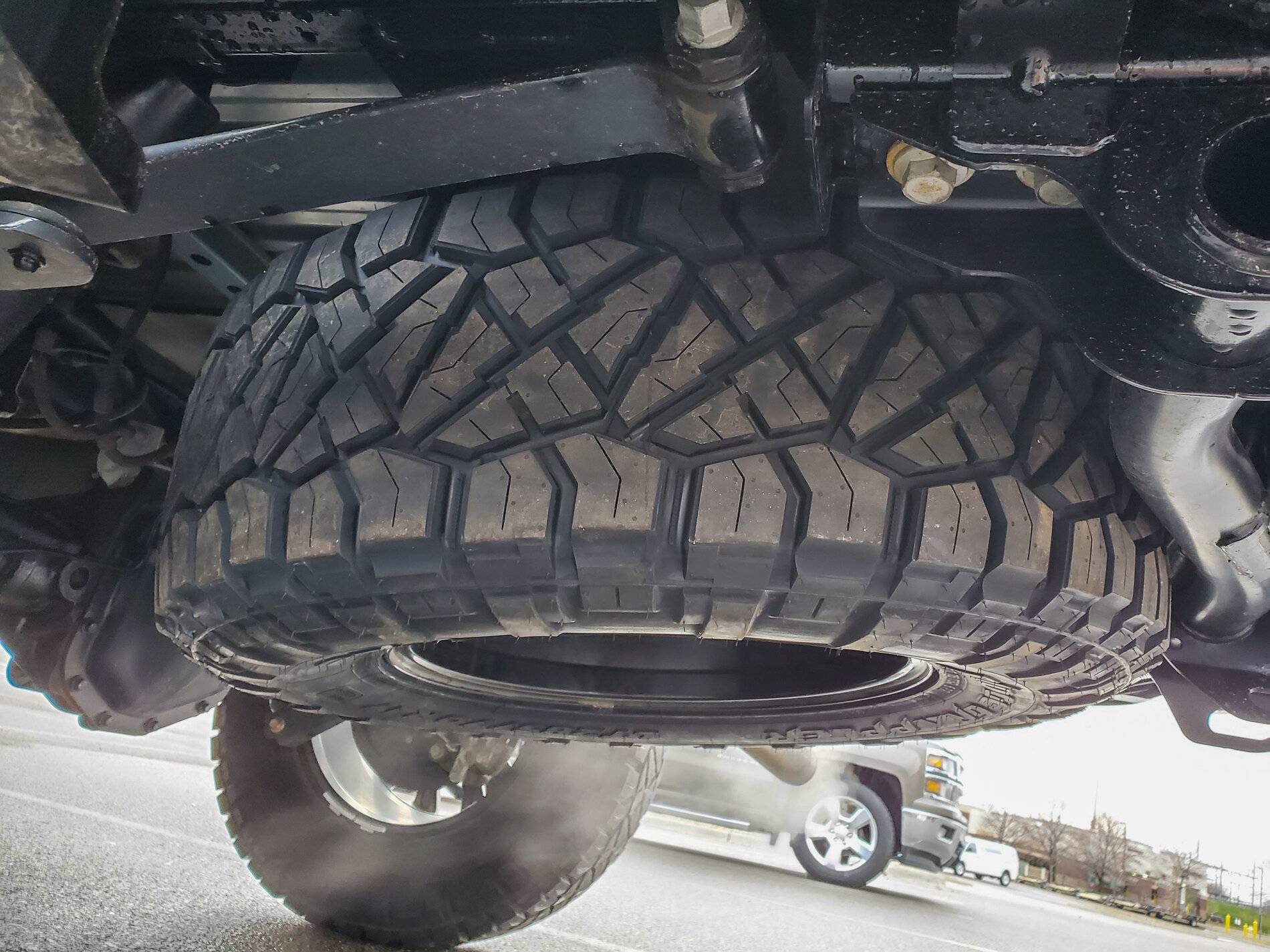

Did the 285/70R17 fit in spare tire location?
Yes that will fit. Here is mine. 285-70-17 on the factory magnetic gray wheel.
I do not know how anyone could fit any larger though as there is less than an inch between the tire and the trailer hitch. Factory tow package too.

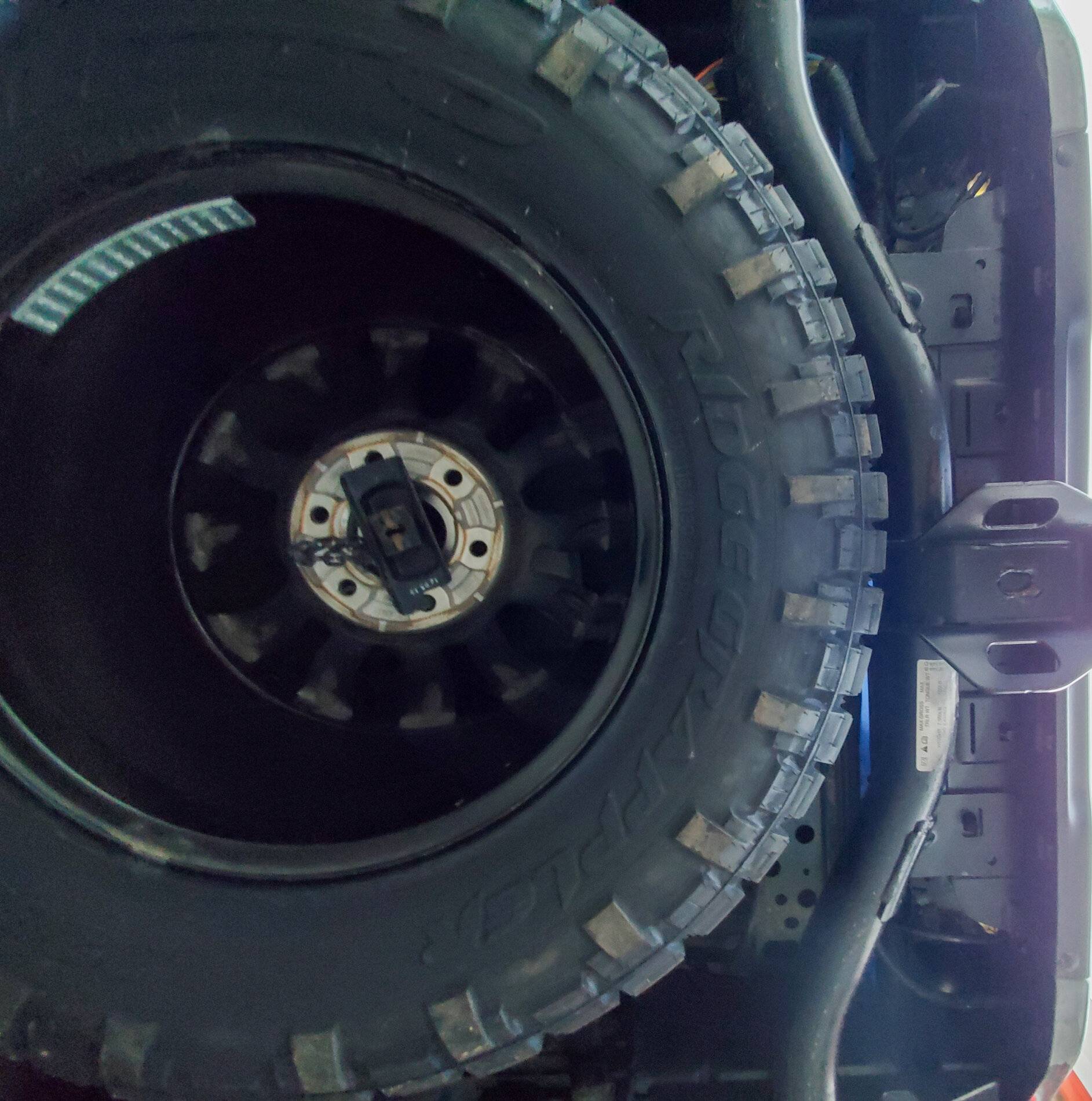

I have 285/70R17 KO2s on 17" black rhinos (12mm offset) under there and I think I could squeeze slightly more :)

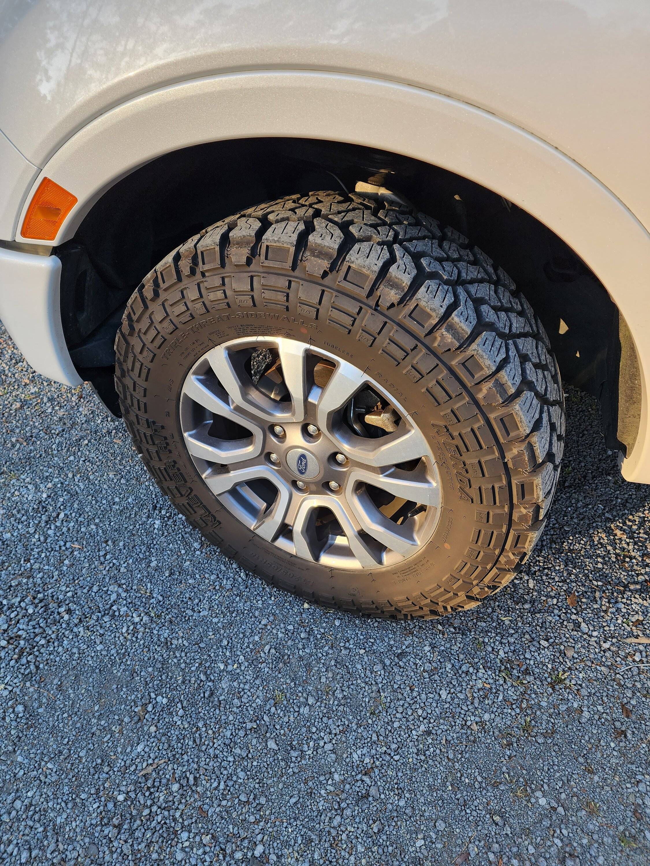

Thank you man, you awnsered my question I got 265/65/18 kenda klevers and wanted a spare mounted
