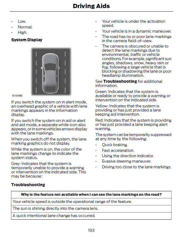

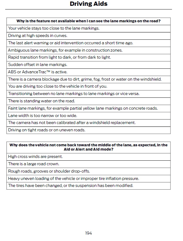

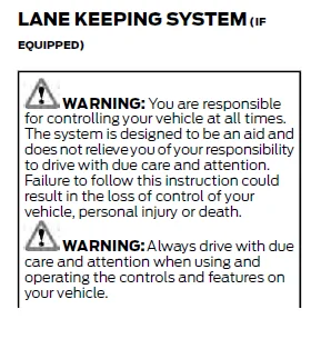

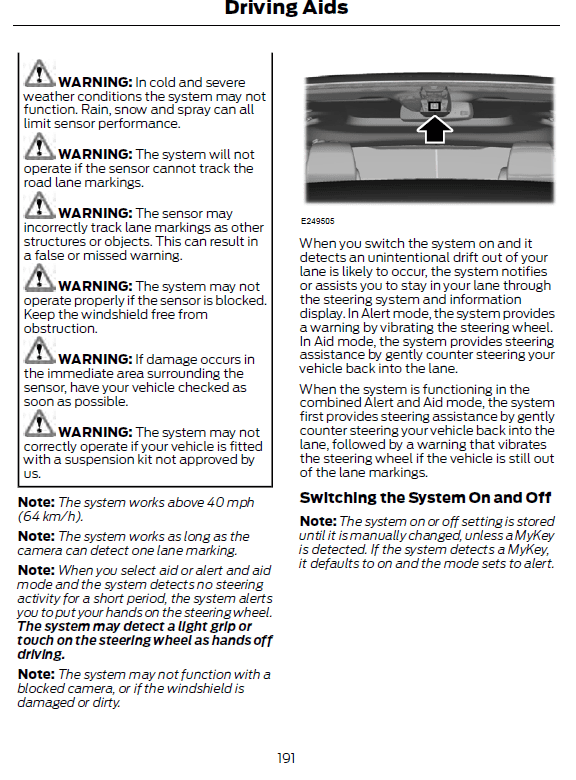

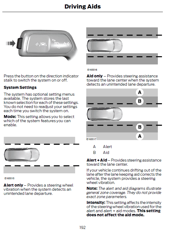

Does the lane keeping assist actually steer the vehicle if it starts going off track, or does it just warn the driver?
Depends, here's the section in V3 of the Owner's Manual.
