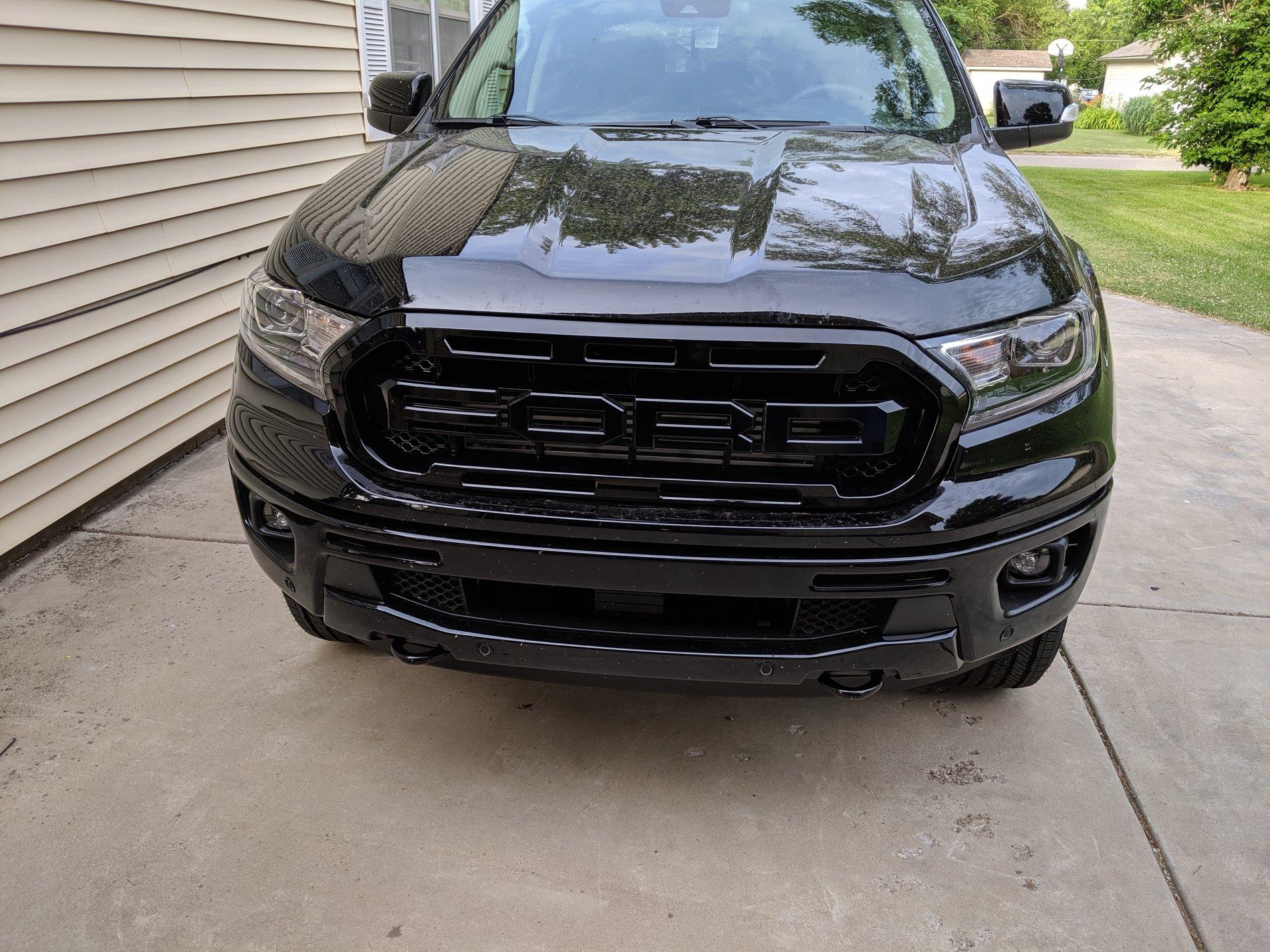

Ok, for the life of me I can't seem to get the bottom clips to release. Where exactly am i supposed to stick the stubby screwdriver, it's hard to tell in the video?

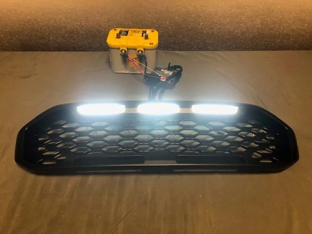

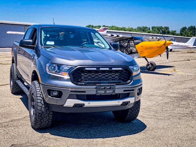

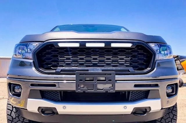

I like it....where can this one be purchased?
I'll have them in a few weeks... Should be around $$250 with the lights.

Also, go look at the video in the 1st post of this thread, gives a good reference to getting to those bottom tabs and where you stick the stubby.. there's a black tab you can see, you insert above that, between that and the grille... then, the one on each side you can just find with your fingers and push and feel those tabs release.

Ended up removing the plastic shield looking piece next to the drivers side headlight, giving me access to the one vertical tab on that side. After that was released the grill was loose enough that i could easily release the rest of the tabs, some of them with just my finger.

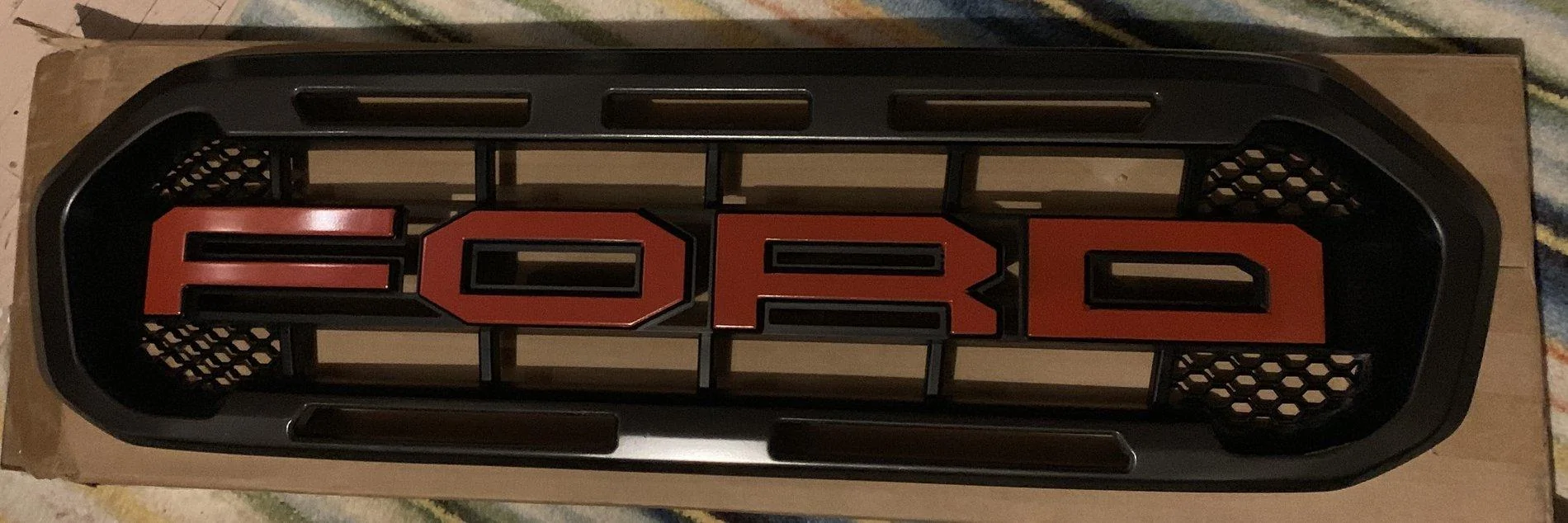

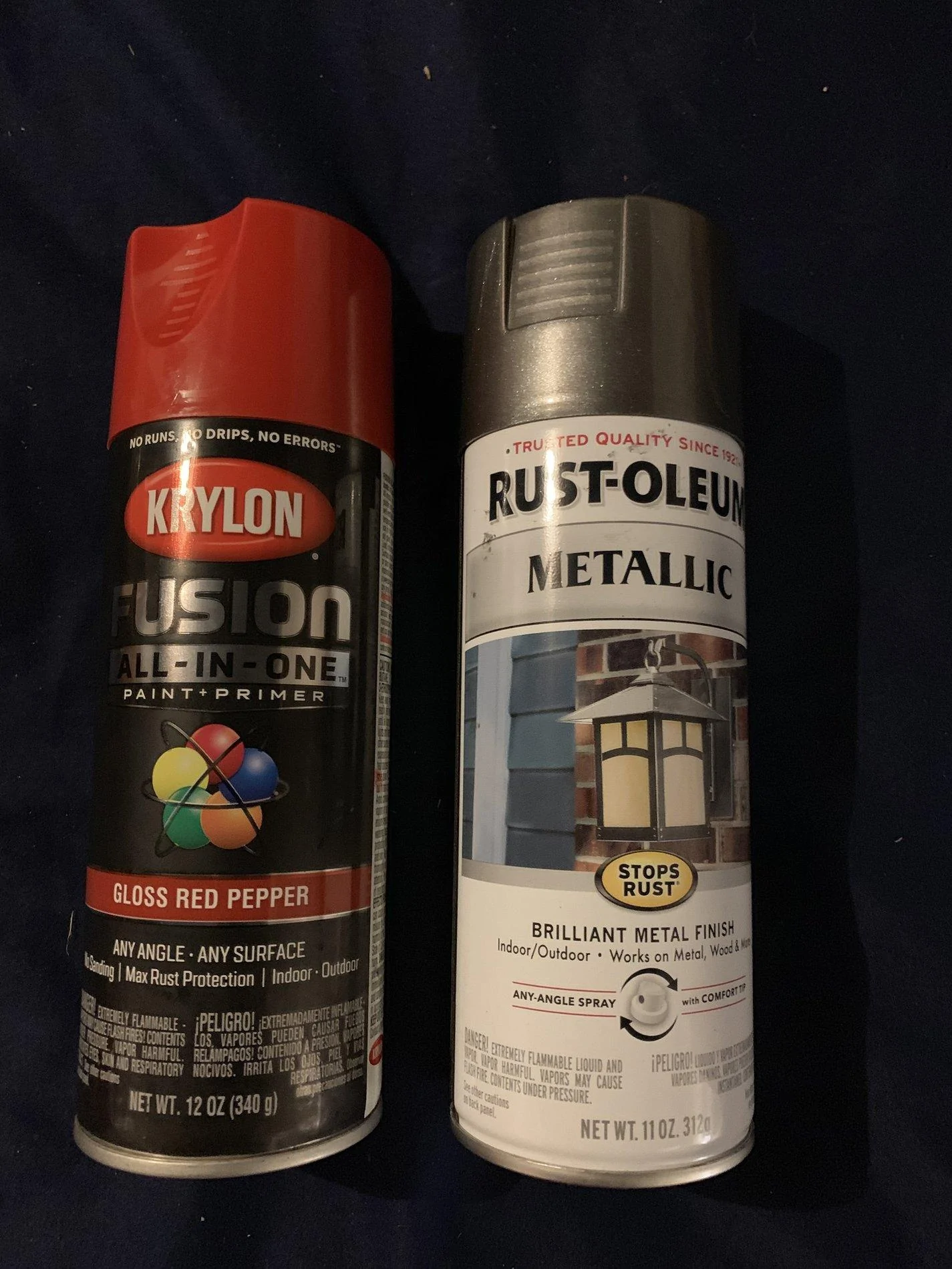

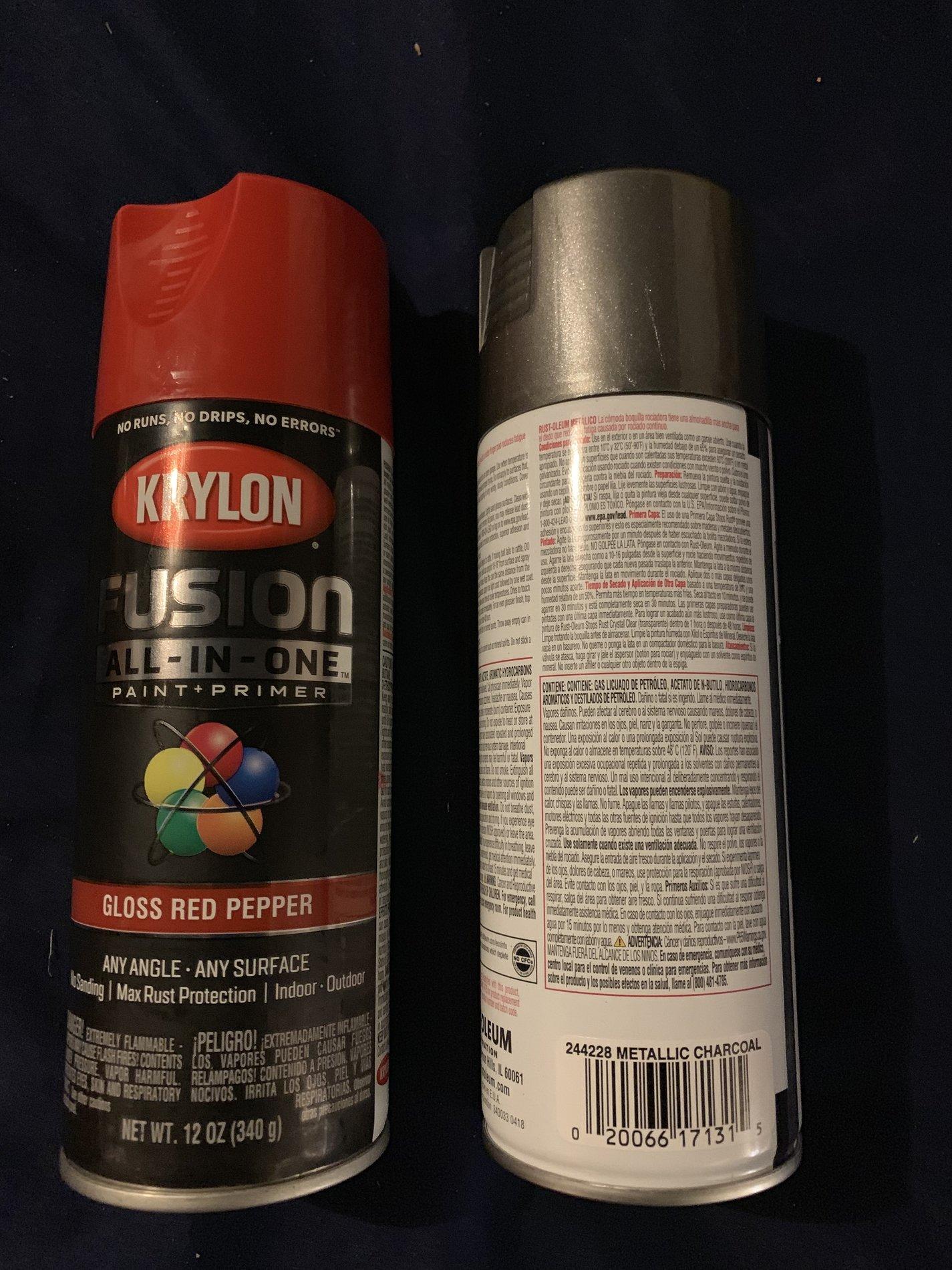

I
Nice.. I was thinking about some nice silver on mine.
did the outside trim charcoal grey , letters front face pepper red and left the middle black
