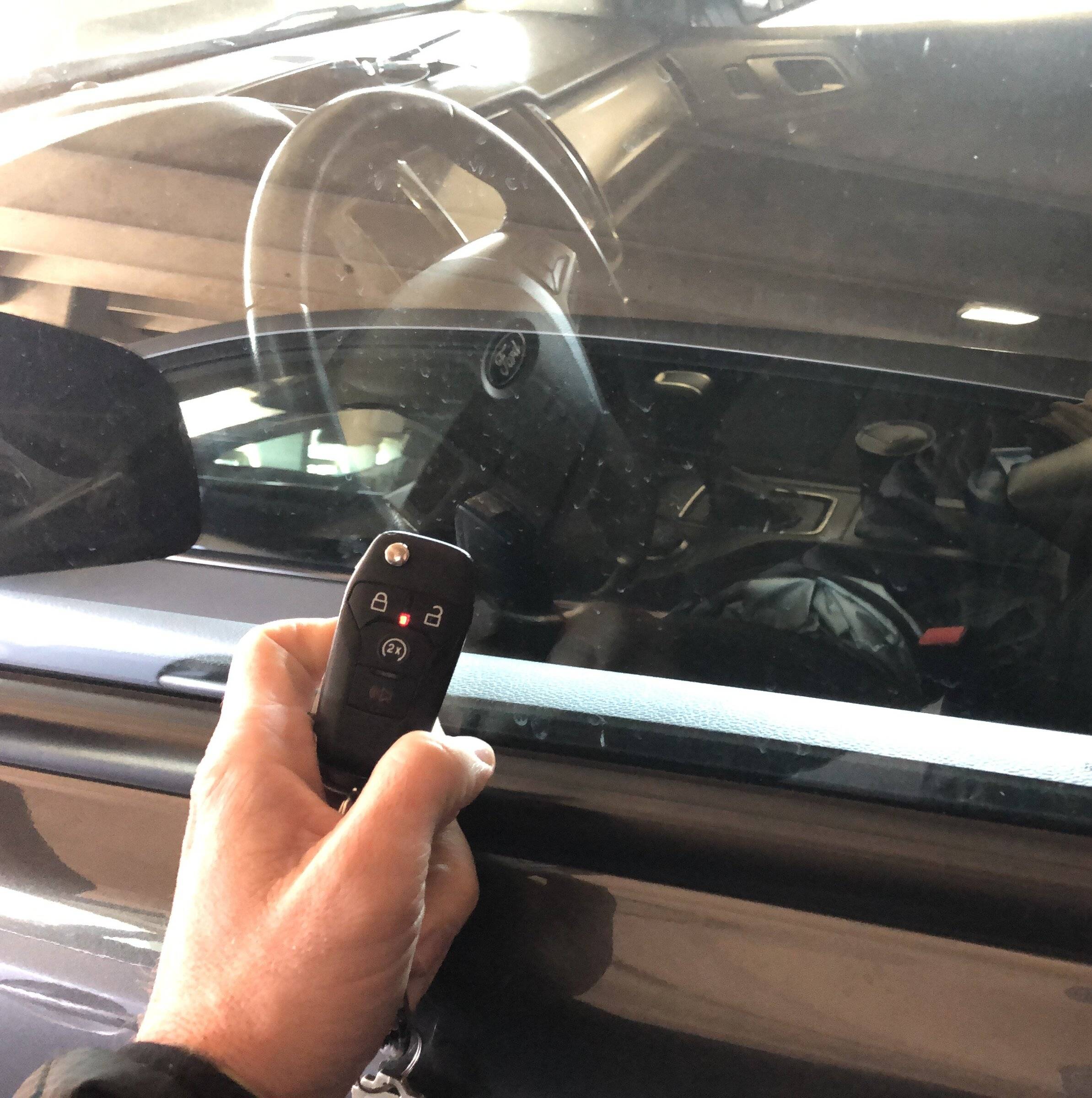

My XLT’s problem: the truck intermittently does not respond to the key fobs not app (not the recent app problem). Won’t remote start (I get the red flash, no confirmation response, so I know these fob batteries aren’t dead), won’t unlock, won’t lock, won’t SOS, just won’t do anything. I have to manually unlock it, and the alarm starts going off. It does not log the events, so I started allowing the alarm to go off every time (thinking maybe that would create a log).

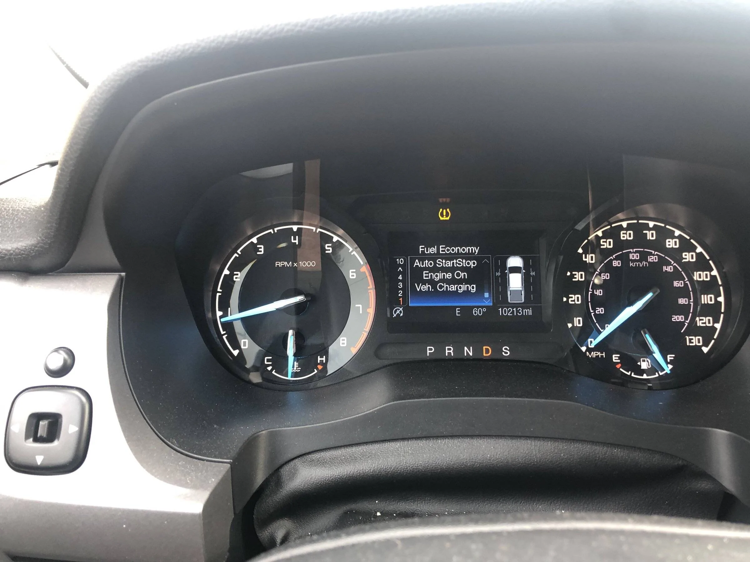

It often works first start and open of the day. Some times it won’t work for 3 days straight. A few hours later, it works. It worked 90% of the time in the summer. It doesn’t work 90% if the time when the temperature is below 70. And 90% of the time it’s not working, I have a tire pressure sensor failure notification. (Related..?)

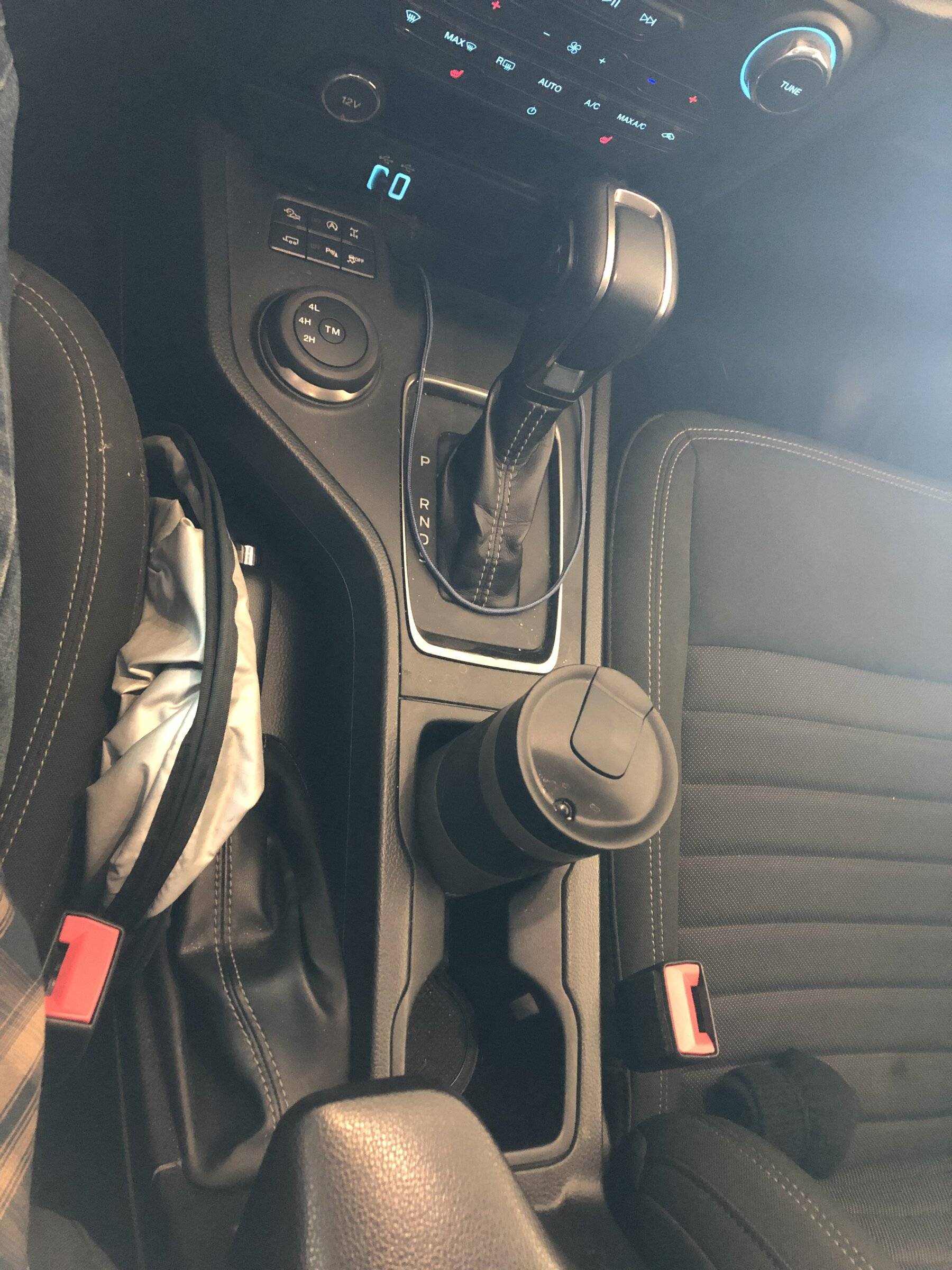

Update: (tried those things around the center console no change)
truck remote started this morning, drove 45 minutes on the highway. Did my appointment, back at the truck 1.5 hours later, 35 degrees out, key fob works, truck doesn’t respond. I had place the metal cup, water bottle, left the window shade there, and the usb cable. (Photos before and after).
Then I removed everything from the console area. Including unplugging the usb cable - since USB ports are inherently quite EMF noisy connectors. Then, started the vehicle and turned it off a couple of times. Attempted to lock the doors with the fob - nothing. Used the electronic door locks, shut the vehicle, and attempted to use every function on the key fob: nothing.
no change related to the objects around the center console.

OP Update - 1 week at the dealer and I picked it up today.
1. I'm at 10,700 miles so they performed the 10,000 maintenance as well. (The works)
2. Auto-start/stop not working. Found the system was off due to battery state of charge. Tested battery, failed. Replaced battery. Now working.
- This could also explain why the TPM and key fobs are currently working? Maybe... but...
3. The FordPass App and in dash features were not working. Diagnosis is the Telematics Control Unit (TCU) is bad. And is on back-order. But they 'expect it in 2 weeks'.
a) They said this is why the app features aren't working, but - and this is where they lost me - b) that the key fob will be having problems as well because this unit is faulty, and the key fobs talk to the vehicle through it. I agree with a, not necessarily b. The key fobs are actually working currently (but... it's entirely intermittent, so we shall see over the next week, possibly the TCU is the only problem, and the key fob being ignored is a symptom).
