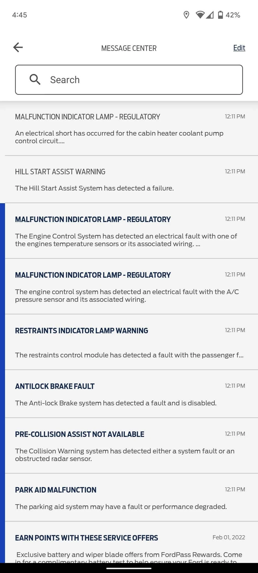

Hey all,
Haven't driven my 2019 ranger in a week or so, went out and fired it up and got all of the following errors. I shut the truck off, fired it back up and same thing. I'm about to go disconnect the battery and see what happens after, but seeing as there are multiple fails, i'm guessing a single computer has died. Any thoughts?

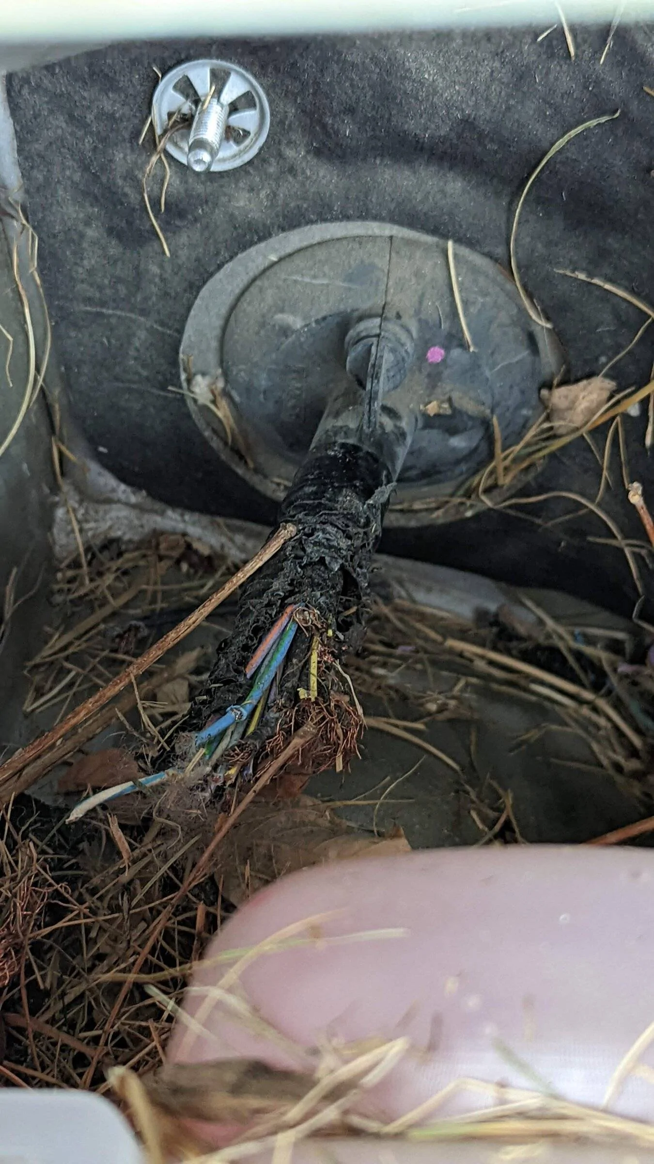

Speaking from experience your comprehensive auto policy should cover this. Happened 2 years ago to my wife’s truck and they got every bit of important wiring in her truck. The engine had to be pulled and a whole new harness run. Insurance billed $7500.

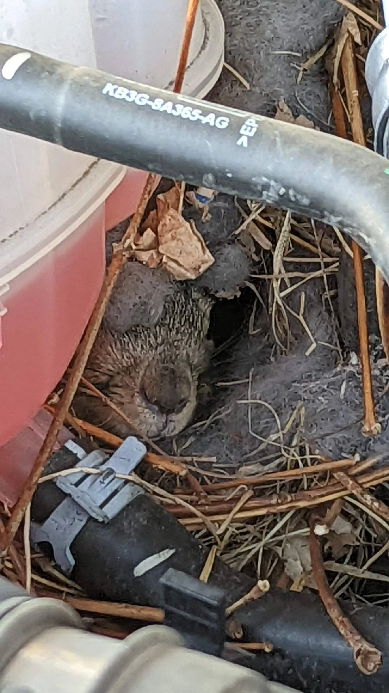

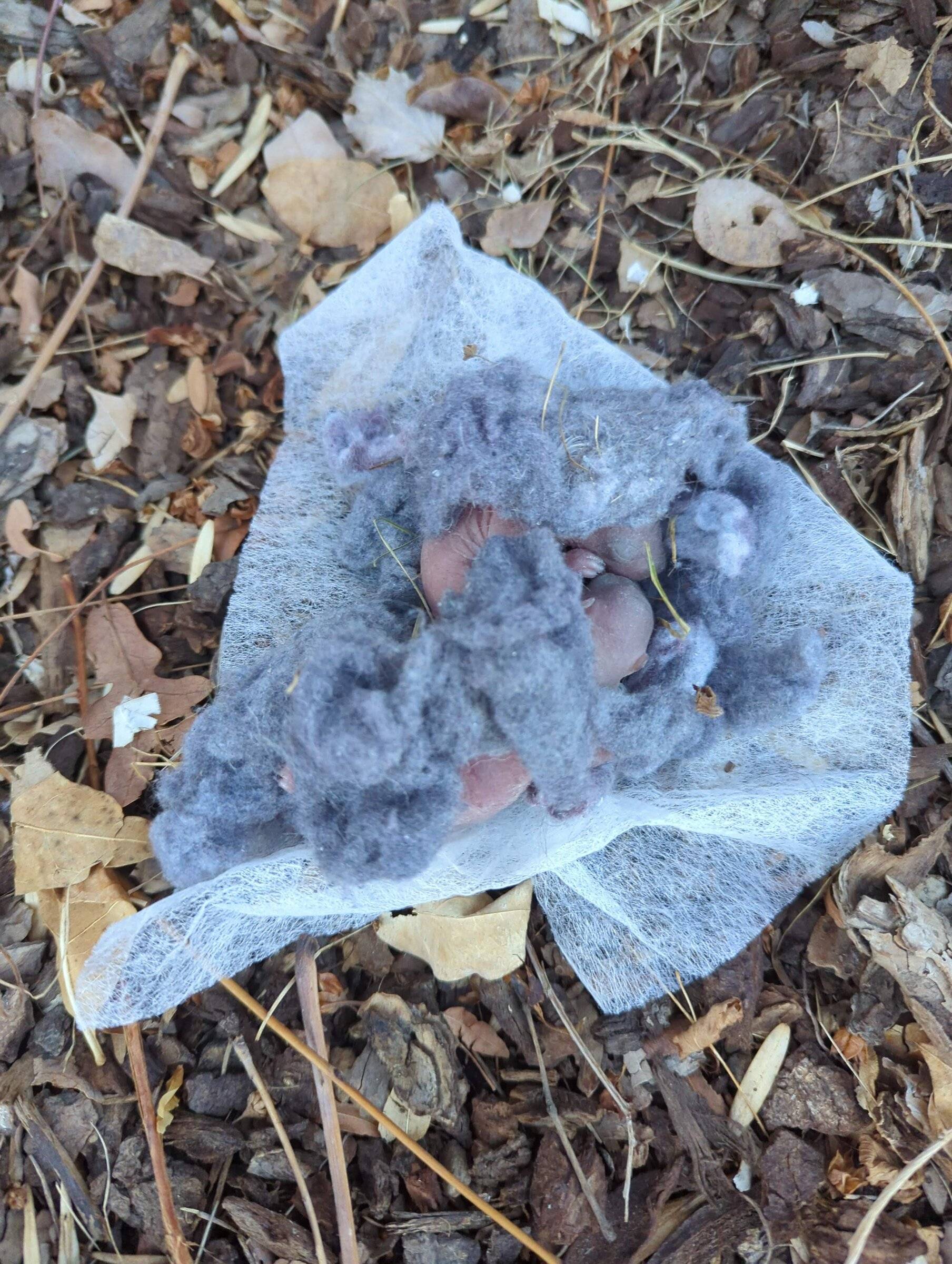

turns out when you don't drive for a week, the squirrels find a warm place to nest. :facepalm:
holy smokes one week and they did all that! lil bastard. if they did that in my area I would be in the yard with my 22 about 8 hours a day thinning them out...
