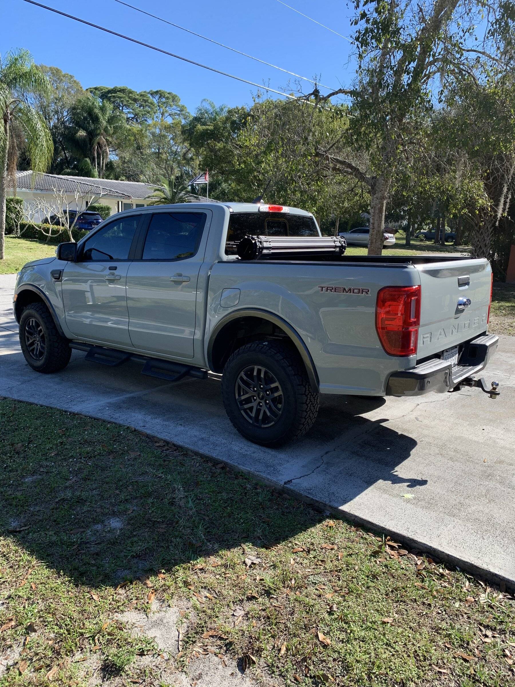

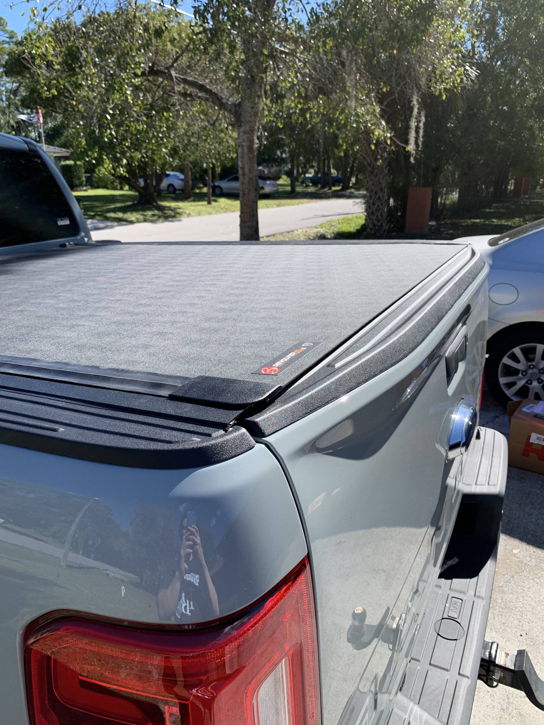

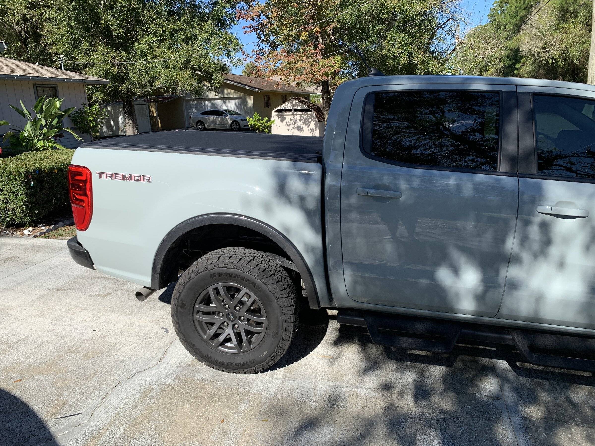

Added a Bak revolver X4s tonneau cover today. So far I really like it. Wasn’t too hard to install, just took my time with it over the holiday weekend. Prob about 3 hours total time spent over over a few days tinkering with it in between manning the smoker and holiday festivities. Spent about an hour staring at the parts/instructions and watching videos one night. The next day about an hour installing the brackets and seals. The third day I spent about an hour installing the side rails and adjusting the cover. I’ve never had one before so I didn’t really know what to expect. The instructions leave a little to the imagination when it comes to the rubber shims, but makes sense after you see it all in action.
I’ll update how I’m liking it after some use.

Have you had any rain since adding the cover? Or gone through a car wash, etc.? Curious if yours is keeping the bed dry.
Also, can you tell if there are T slots on the x4s rails for adding a rack? I've read that there are for the Gladiator but when I ask Bakflip they say no and it's not compatible with any bed racks... Trying to get confirmation for the Ranger

I have the same cover. Pretty good with rain. The issue is less about the cover and more to do with the fact that you can almost reach your hand into the tailgate gap. I get water near the tailgate.
There is no T-slot on the rails. The way the rails work with the cover means this thing fits tight. I am looking at the BillieBars and have decided I will need to trim the plastic bed caps to allow the clearance for their brackets.

I agree. I ran it through the car wash yesterday and I didn’t get much of anything in the rear, but I had some near the tailgate. It comes through the gaps in the sides of the tailgate. It’s nothing crazy, it could probably be mitigated quite a bit with a tailgate seal kit. I had my daughters softball gear back there and it didn’t get wet.
@tremorman - I don’t think there is a place for adding rails for a rack, but if I can get you some specific pictures let me know.
I had to adjust the cover one last time yesterday. I noticed that one side wouldn’t lock good and required more shims to operate correctly. The shims feel a little cheesy. Other than that I’m still really liking it.

Does the rolled up part easily remove so you have full bed access? I understand the rails would stay but does the cover itself come off completely?

Yes, 4 nuts/thumbscrews easily removed. I would use a centre-punch to mark their locations in the brackets so you don’t have to fuss with the alignment each time.

If it was really necessary you could take it off, but adjusting it is a pain in butt. It wouldn’t be something you would want to do very often. It’s basically only held on by 4 hand tightened nuts in the back, so you could take it off really fast if needed.
