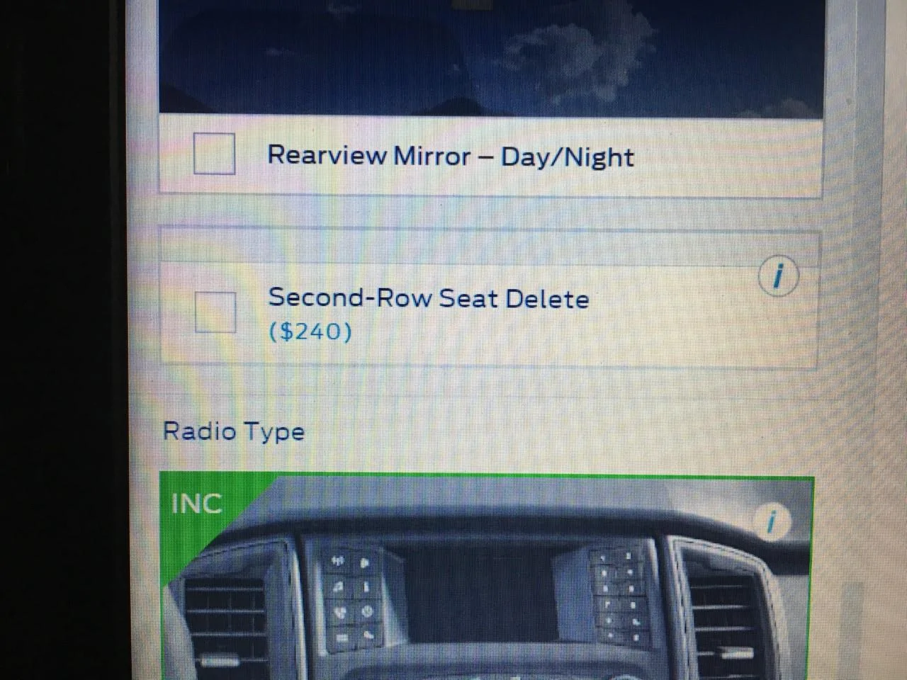

Ford does offer a rear seat delete on the SuperCab, and deducts $240 from the price of the truck.
