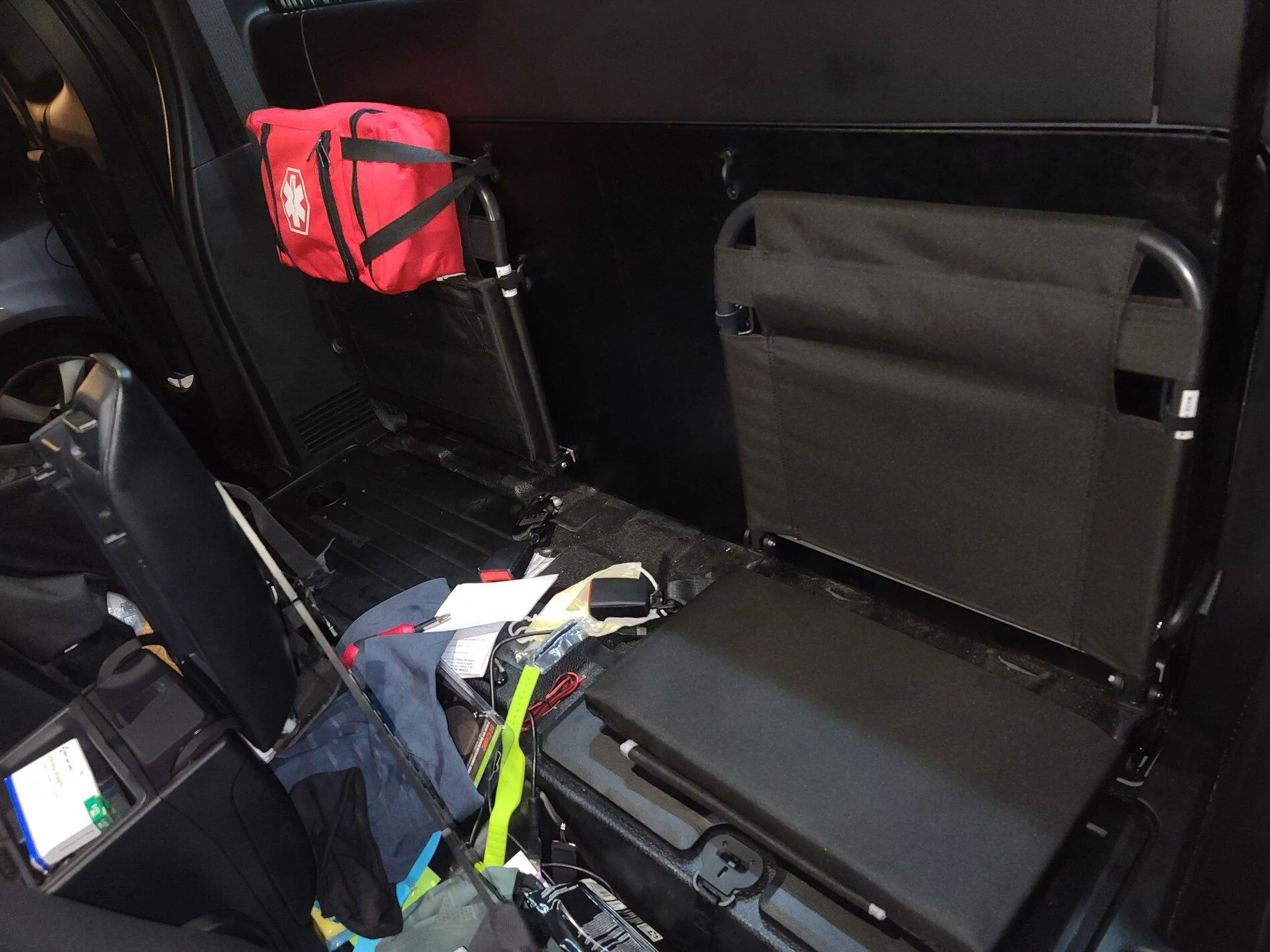

I started with the seat delete idea posted by another forum member, thank you for that!
I always wanted jump seats so I took out my supercab seats and got to modding. Didn't drill any holes and they're pretty sturdy too!
Believe it or not, the back seat passengers (if I ever have any because I've only had passengers back there once) actually have more room than before! So much more storage too!
