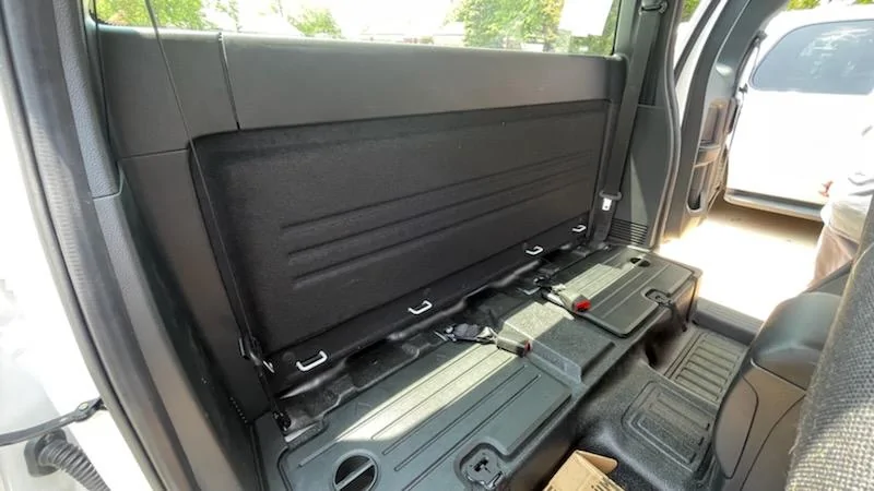

It's easy to remove the seat cushions, but has anyone removed the seat backs without damaging them? If so, how did you do it? I want them gone to make room for an organizer that has a gun safe and rod holder!

You can buy just the top trim for 60$, if I recall correctly? Then plywood for the back panel. Personally, I added jump seats back in, but they're much flatter than the oem seats.

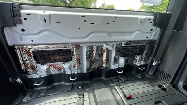

After removing the seats, I took the opportunity to install sound deadening, before installing the back panel, Works and looks great

I'm using it "as is" to get a feel for how the space works, maby a fold up platform to retain access to the jack.
