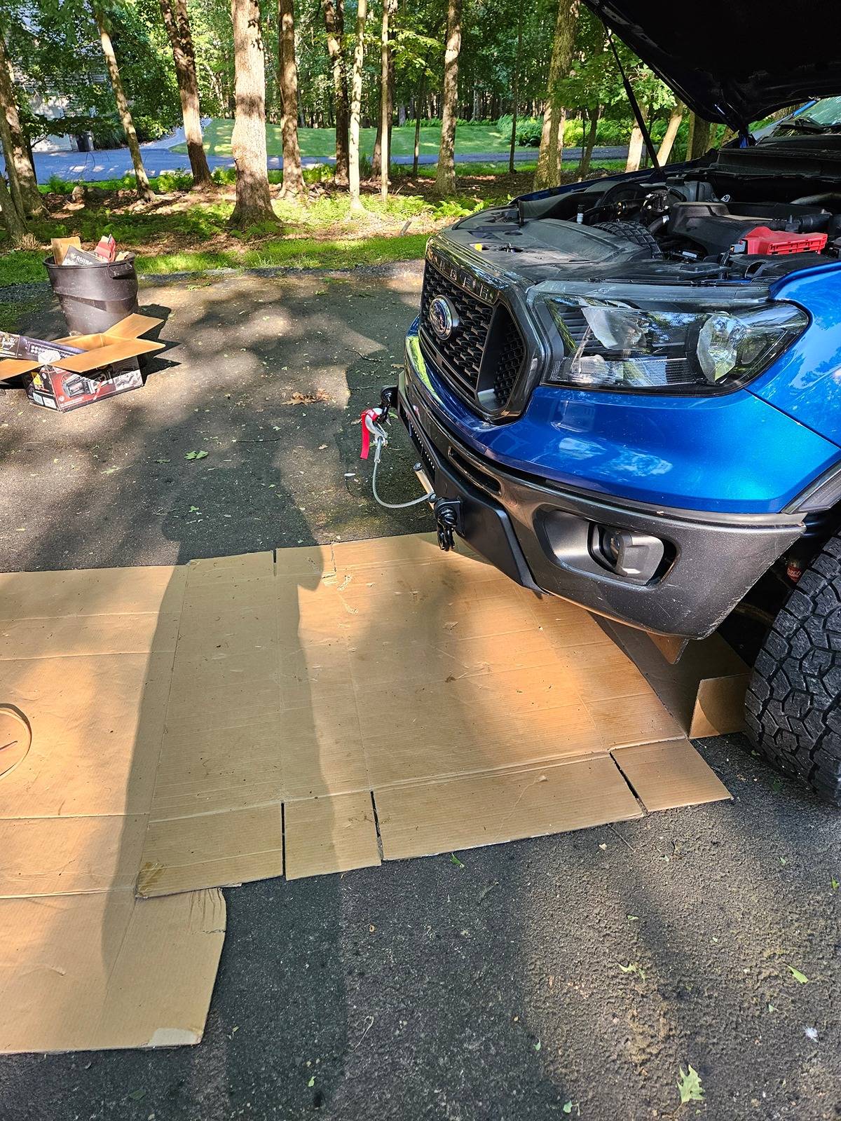

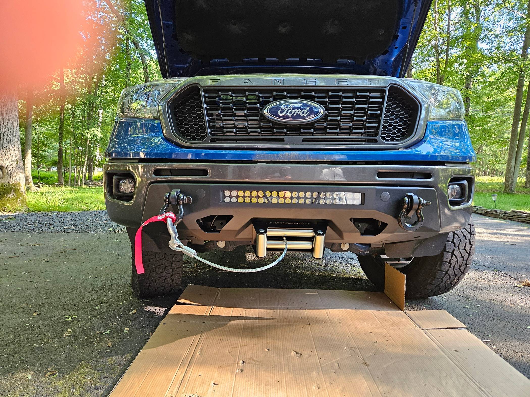

Well, my son and I spent the better part of a day getting this on. It weighs a ton after you get the winch attached. Then you have to try and get it bolted up. We used 3 6x6 timbers under it which got it close enough to get the bolts started. If you watch JCR's install video pay attention. He says leave all bolts loose until everything is in place. We ended having to go back and loosen things to get it all lined up properly. Still have some wiring to do but here is how it sits at the moment.
