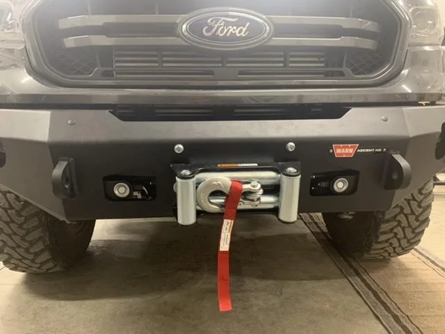

Having a hard time getting these center sensors to keep
Quite.
I’m not able to figure out how to disable them or calibrate them? Does anyone have any suggestions? I’m wondering if someone like 5star can put this into a tune for me as I need to adjust the Speedo also.

I installed a Brush guard and had the same problem.
Since I had purchased the auto start stop eliminator I got to thinking if they could do the same thing with the parking aid.... So I emailed them and explained the situation. Travis at Auto stop eliminator looked into it and made a modification to the connector. It's on its way to me. I will update when I get it installed.
Just FYI, if you go this route you will need to contact them directly.
https://www.autostopeliminator.com/
I installed it and it automatically turns off the parking aid. So no more warnings.
