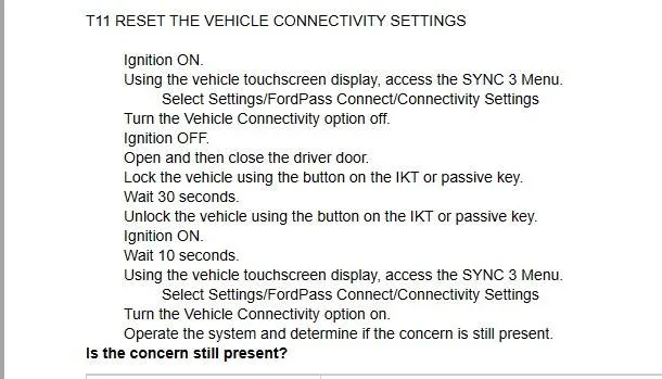

Give this a try, from the service manual, May help or may not IDK
