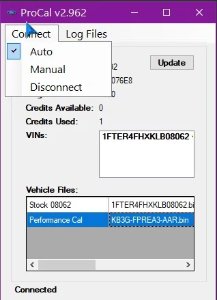

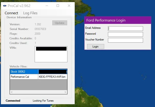

OK, you made me do it... got the ProCal4 out of the truck!! LOL
If the unit is NOT connected to your PC, you get the screen shot above... if it is, you get this (IF you have it set to Connect: Auto):
A:
(Connect: Auto.... B:
So photo A will show what's in the device Now. After logging in to Ford Performance (if Auto is on it will "press" the update button for you; if manual, you press it), it will download to your Device any "updates" and the version numbers will change. I updated mine in May, so photos above show that there has been NO updates since then.

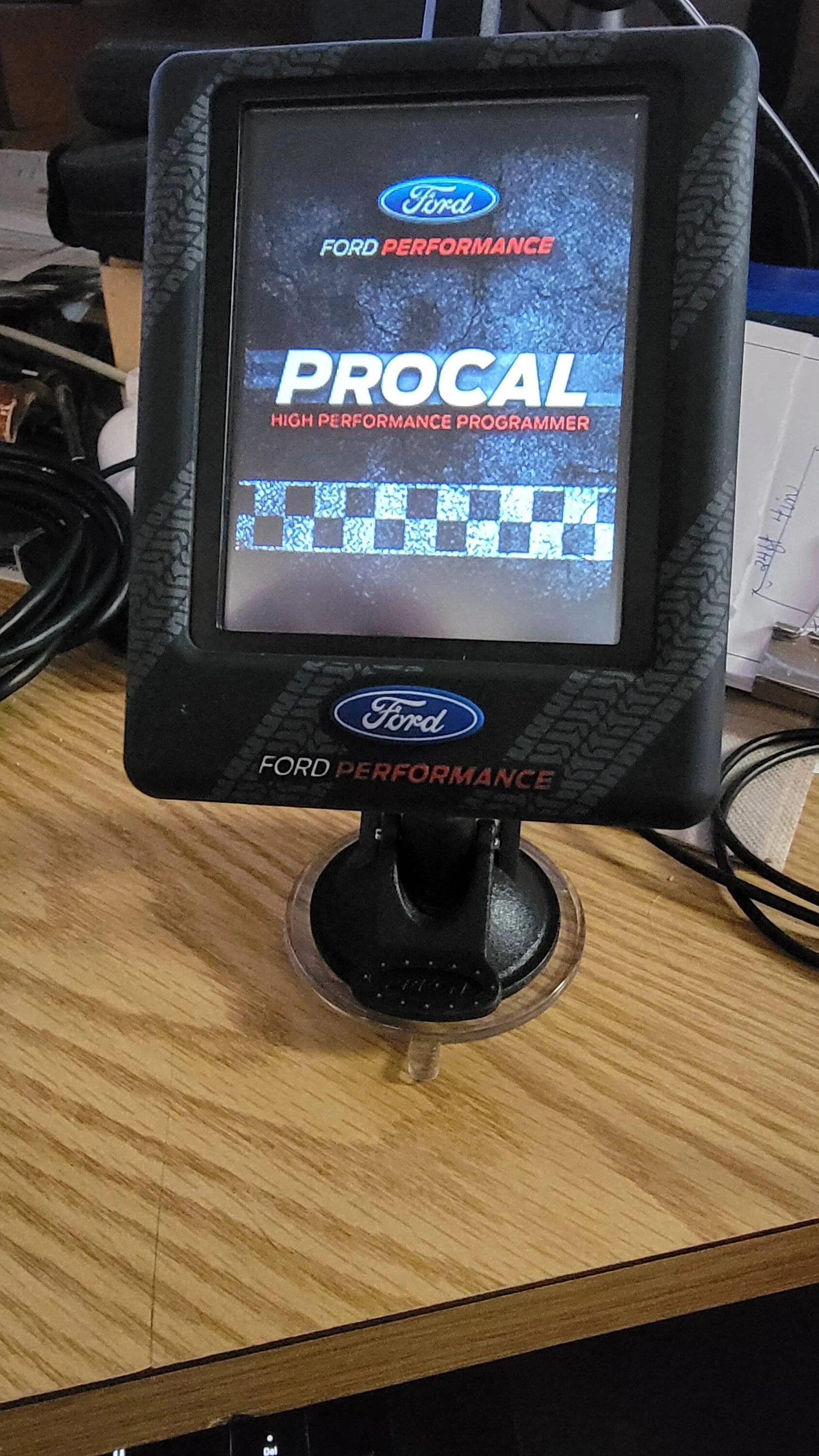

PS: The little suction mount/stand works great on the desk top to hold the device while working on it...

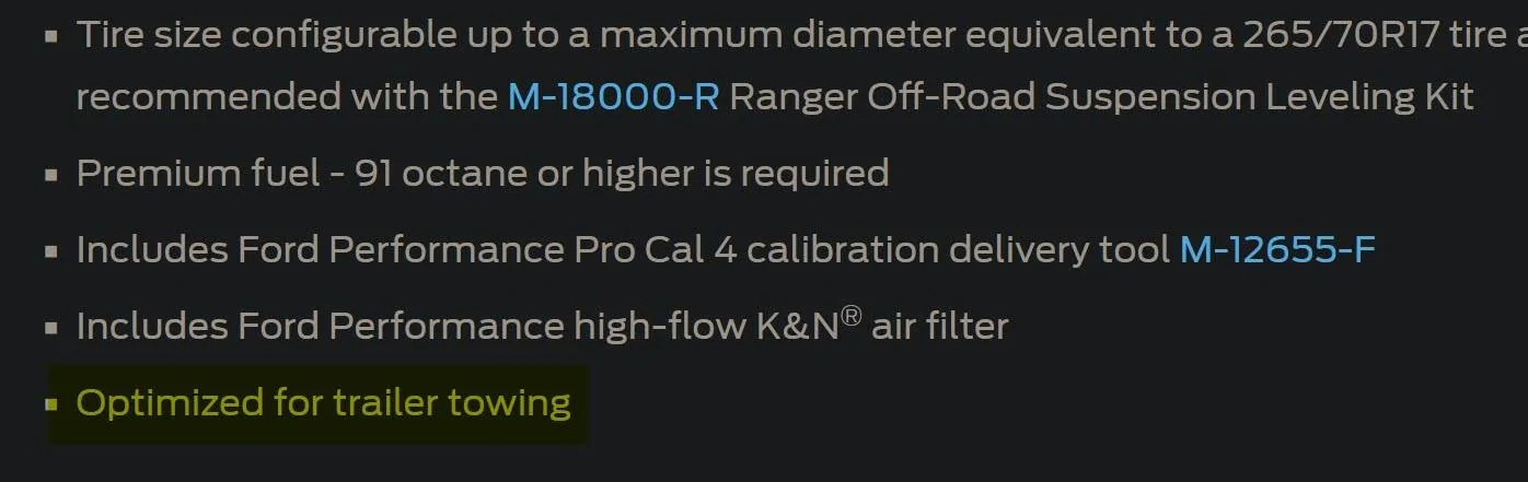

When Ford Performance first released the ProCal 4 tune back around 2020 they recommended that it not be used for towing. They latter in 20 or early 21 they revised the tune to make it suitable for towing. There have not been any revisions to the tune since and there is no separate towing tune.
The firmware that makes the ProCal 4 device work has been revised several times but that has nothing to do with the actual tune you are loading.
