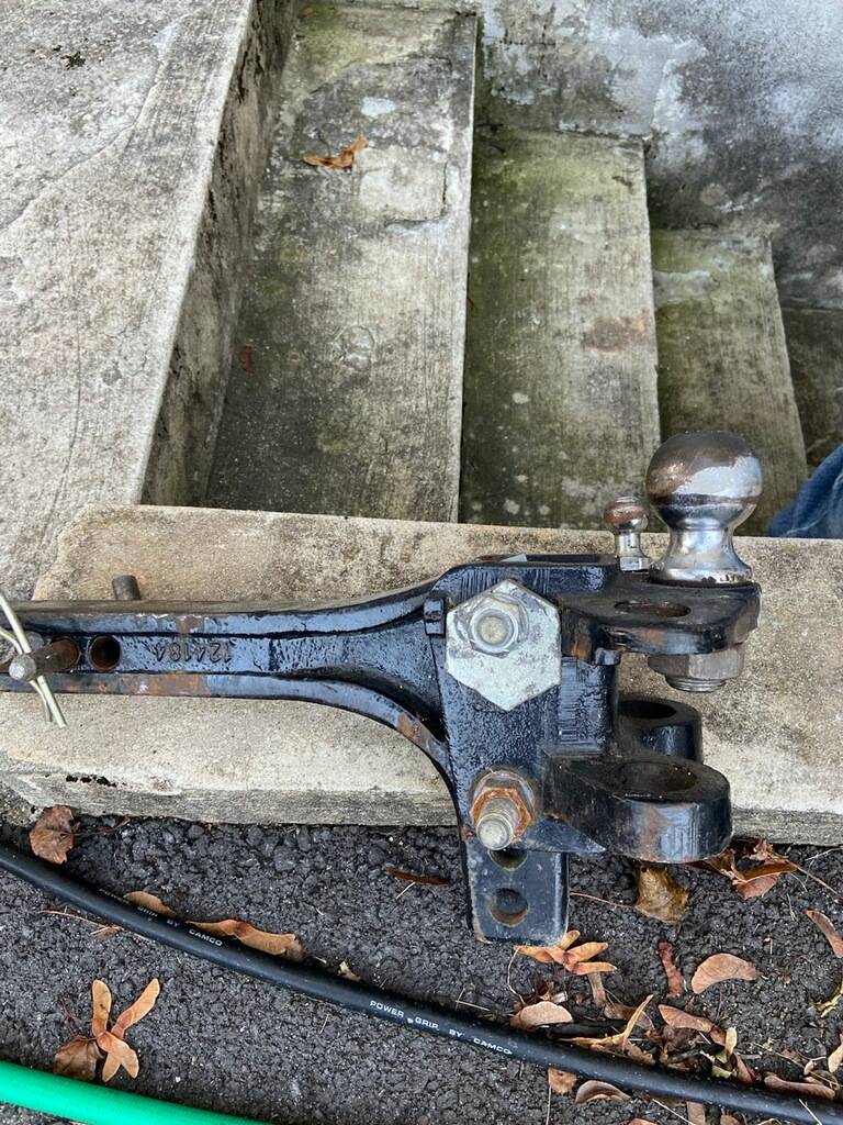

Not saying don't use grade 8...nothing wrong with going to a higher rating, and of course, always replace with the same or better than original....never "less".
And, you are correct...I should have said if using the old hitch, to check what hardware was there, and to replace with equivalent or better.
The 2 bolt/nuts holding the head to the shank do look questionable, and, maybe due to camera angle, but look mis-matched.

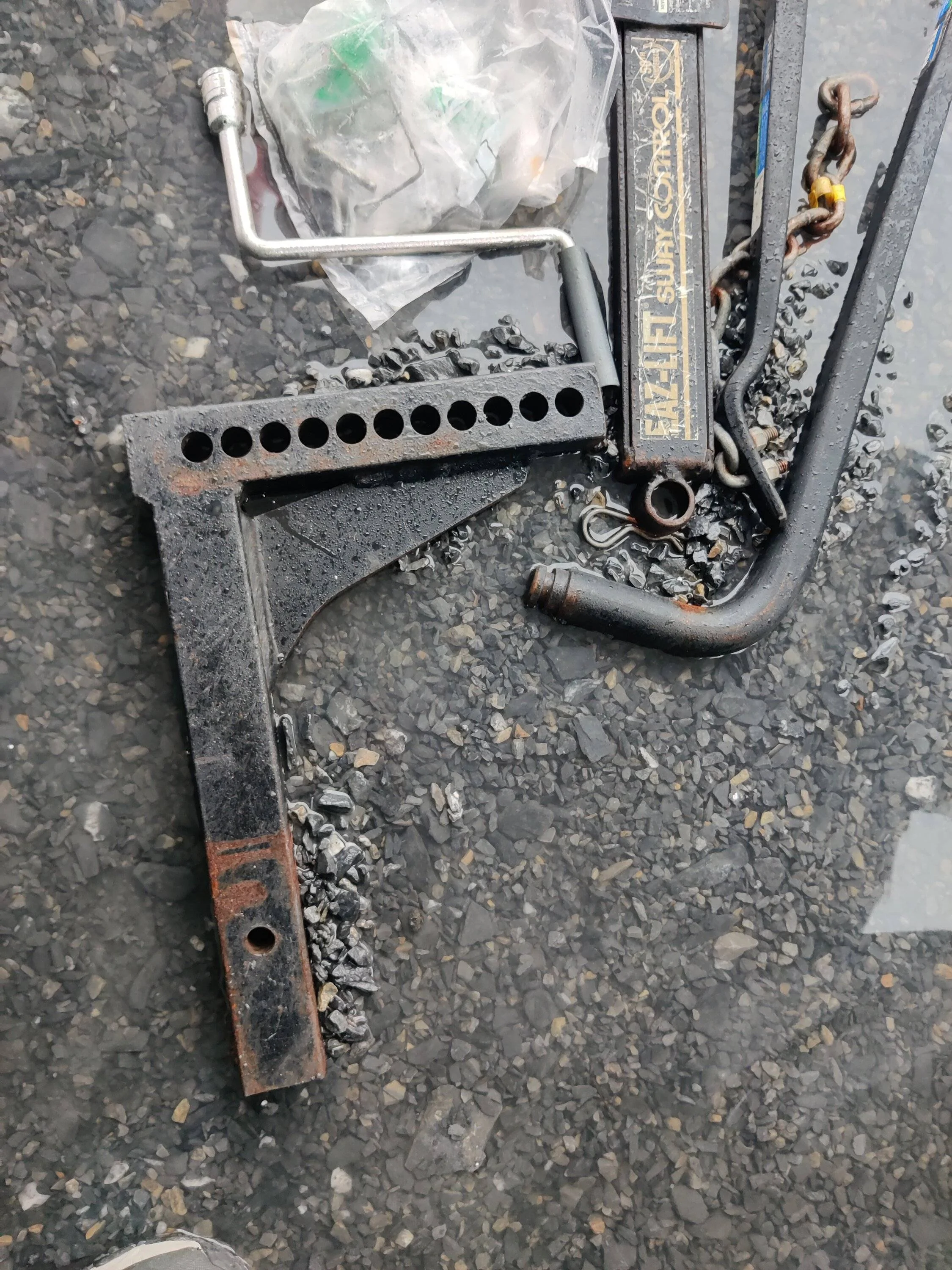

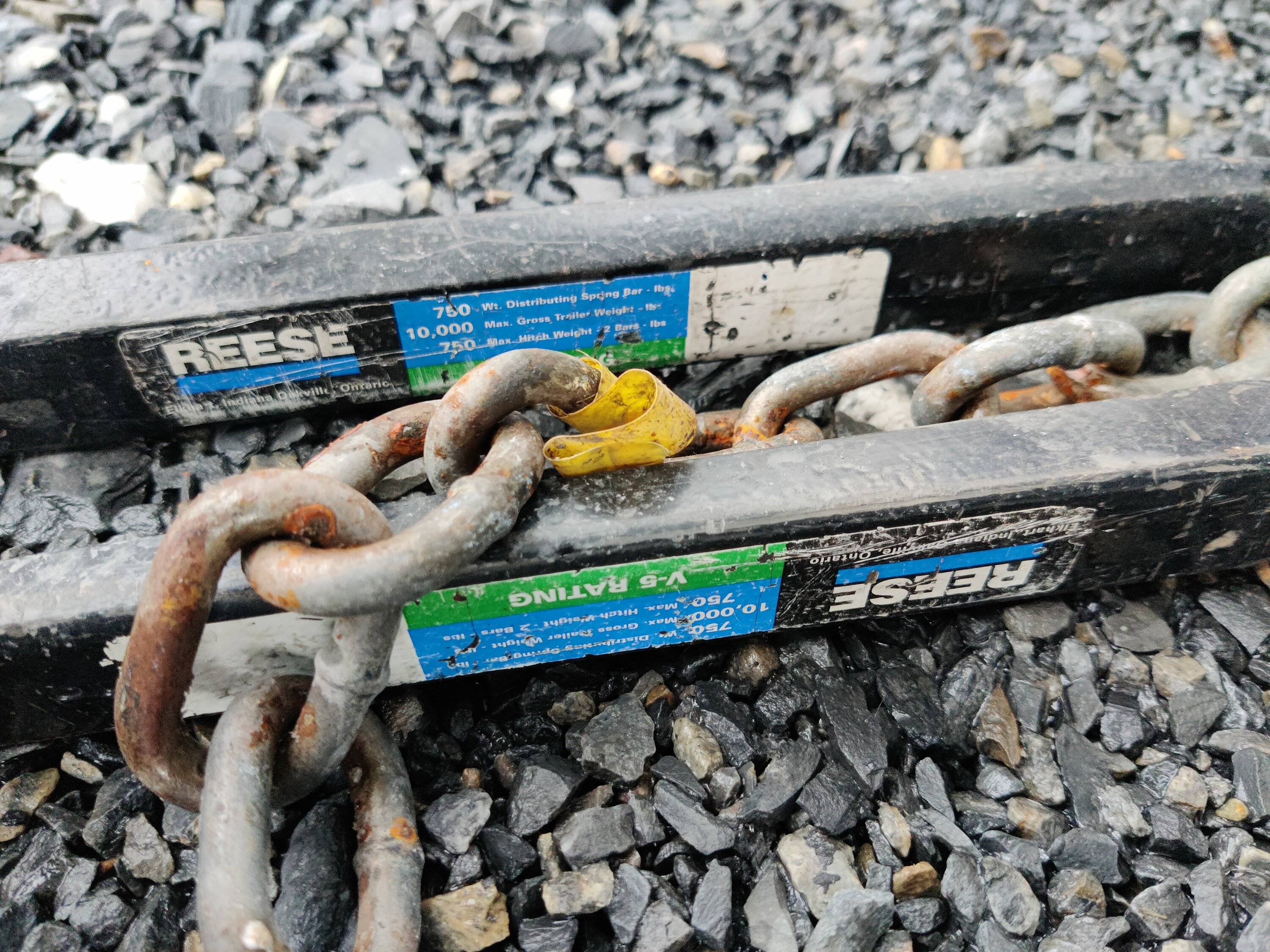

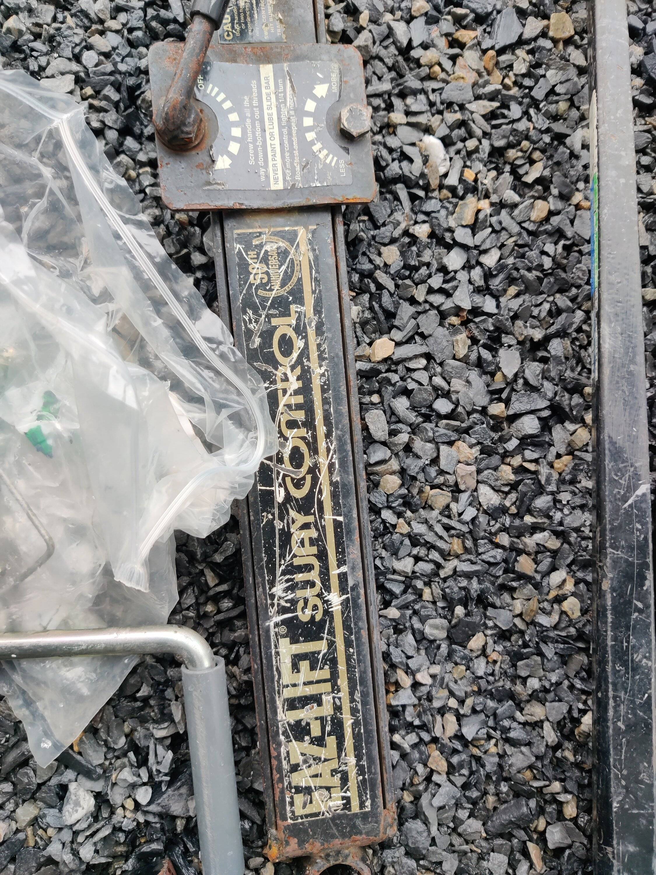

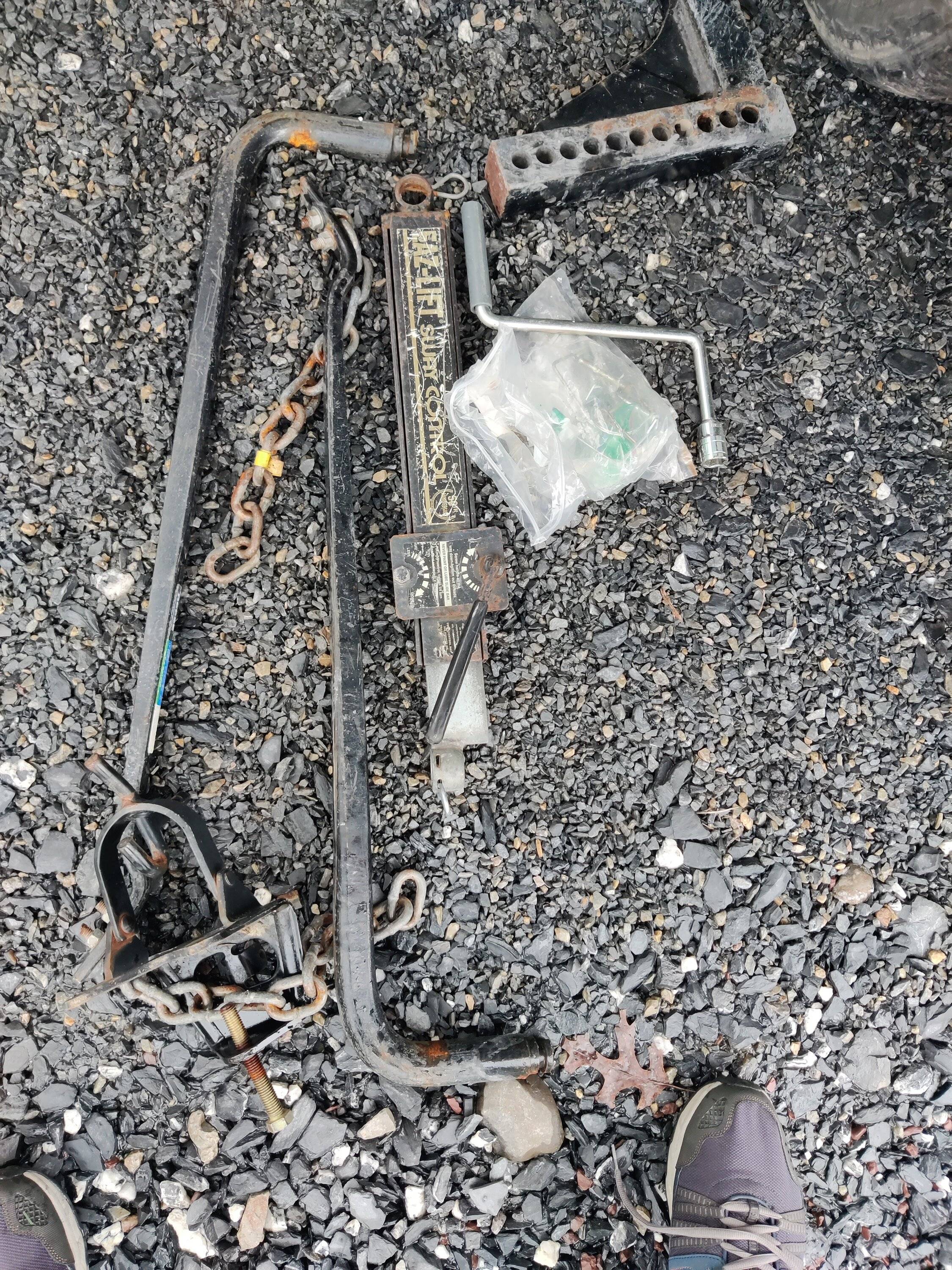

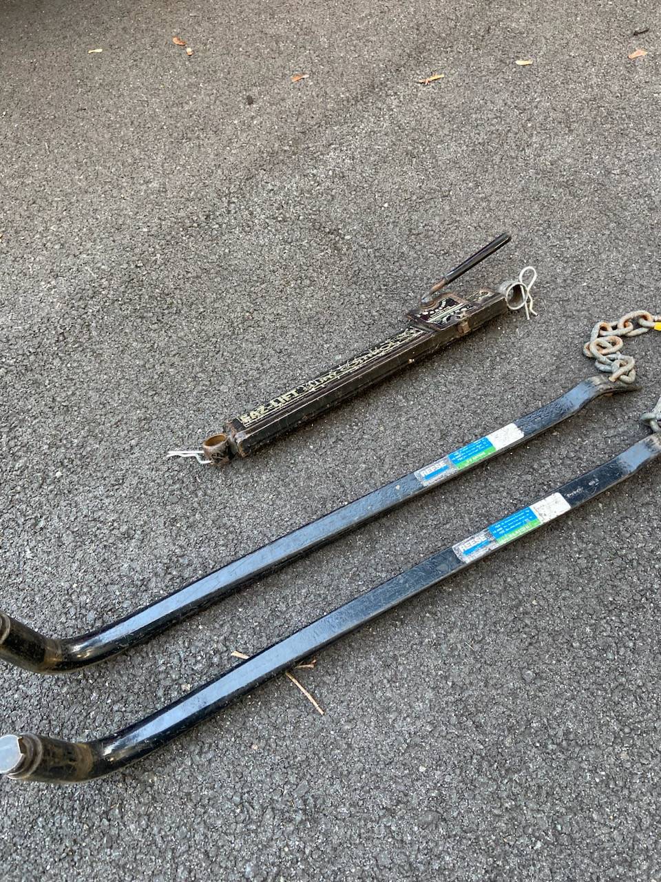

We're going to pick up a used travel trailer Thursday (2021 Grand Design, 5,780lbs dry) and the dealer said our sway bar/hitch is old. They want to sell us a new Equal-i-zer 4-point sway control hitch/bar system for $995 installed. We want to be safe. This is what we have, is it sufficient or risky? Came with our old 2018 trailer when we bought it, so no idea of history.
