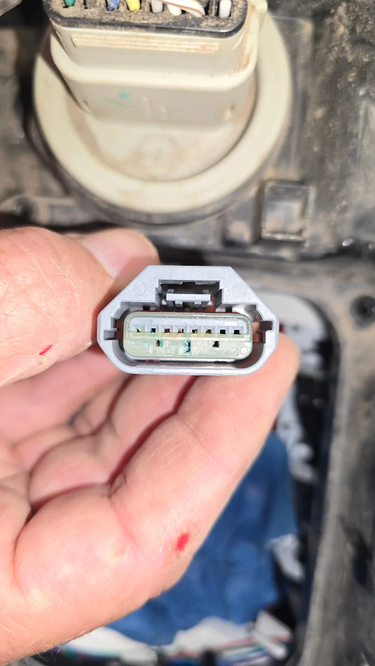

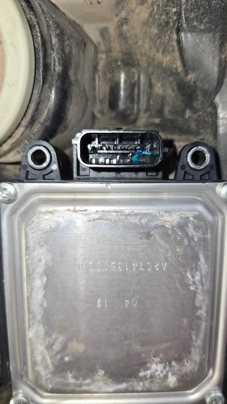

I got some time to look at this today and I think I might have found it. In the right (passenger) side taillight, there was a good bit of water and looking at the connector to the BLISS module it looks like a bit of corrosion. Wondering what the best way to clean this up is? Should I get some contact cleaner and a small brush and then put some dielectric grease in there when I put it back together?
Yes, those would be good steps to follow. It is possible that that corrosion and water is causing most of your "U type" communications faults. If you clean it and dry up the water and you still have issues, it is likely that the BLIS module is damaged from water intrusion. You could leave the right taillight unplugged to see if most of the faults clear, if you still have issues.

You are going to have to address the water intrusion into the taillight assembly. Possibly will need a new taillight housing and BLIS module (if water entered into the BLIS module).

Yeah, there was a LOT of water in there - I saw some condensation and I didn't think it was bad - but there was water sloshing around in the talilight. I dried and flew it out as best I could and I'm leaving the taillight in the sun for the areas I can't get to to completely dry out before I put it all back together. After that, I'm going to try and run a thin bead of clear silicone around the outside of the lens to see if that fixes the leak. There are screws which make it look like the lens is removable but it seems like those might have only been there to hold it in place while the sealant was drying - I removed all the screws but the lens won't budge and I don't want to pry too hard otherwise I will break it.
I looked and a new genuine BLISS module is almost $500! I know OEM taillights are about the same - if I end up having to replace a taillight I will probably go with an aftermarket unit but I hope that won't be necessary. I hope the module is OK - it didn't look too bad other than the bit of green in the connector which I mostly got cleaned up. I should know later today (after the taillight dries out) whether this fixes the issue or not. I'm going to clear all the DTCs and then see if any come back after this.

Update: I cleaned up the BLISS connector, completely dried out the taillight, applied some dielectric grease to the connector, used a small bit of clear silicone around the taillight lens and then re-installed everything. I went for a 10 minute drive and no failures popped up. I had also cleared the DTCs and the only ones that came back were the one about the high stop light (no idea what is causing that - maybe more corrosion in there? I have never touched the bulb in that light - and then the one for the air intake damper position sensor. I'm guessing those have been going on a while and I just never knew about them.

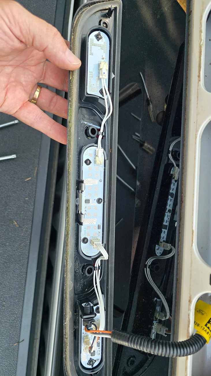

I do not have the Ford Trailer Brake controller - I've done almost no changes to the wiring on this truck. I confirmed that the high brake light is NOT working - I took it off and realized it is an LED unit (I have a Lariat) - nothing looked weird and I did not see any corrosion at all - is is possible this piece failed? It does not appear anything in the unit is replaceable:

Just as a follow up - It does not appear as though the lights over the bed are working either (the ones on either side of the high stop light) - I'm stumped as to what has caused this issue - I KNOW this worked not too long ago.

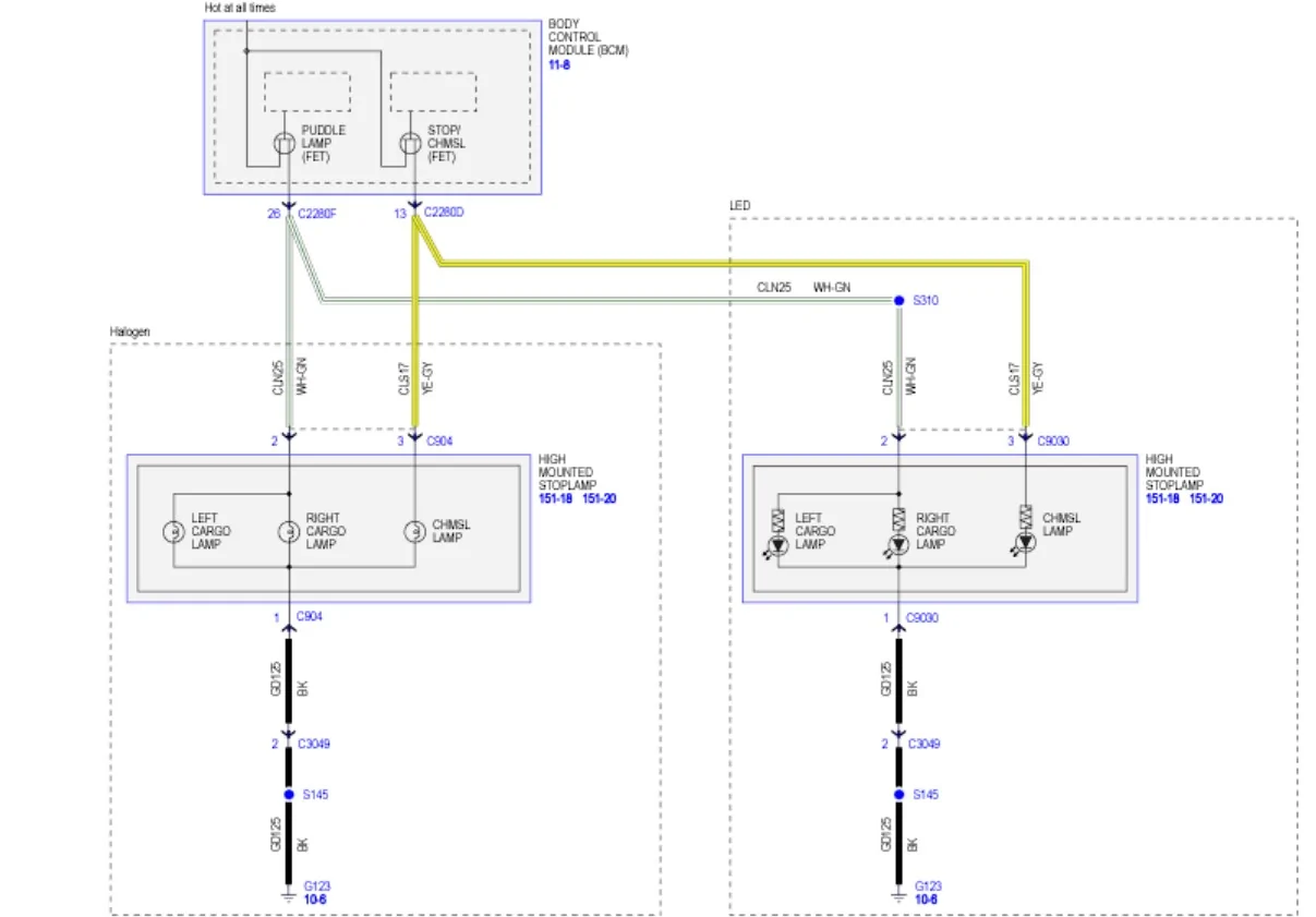

Here is the wiring diagram for both sets of lights. You will have to see if voltage (12 volts) is reaching the lamp assembly for the stop and cargo LEDs. Also check the ground connection.

I ran a wire from the negative on the battery and I wasn't getting 12v to the input on that LED bar. The puddle lights work fine but the 3rd brake light and bed lights are non functional.

Is the black wire at the light housing connected to ground? Test using an ohmmeter. If it is grounded (close to zero ohms) and you have no 12 volts DC at the cargo light (when turned on) or stop light (when brake pedal is pressed), then you will have to follow the wiring back to the BCM (Body Control Module) and look for broken wiring or connectors.
