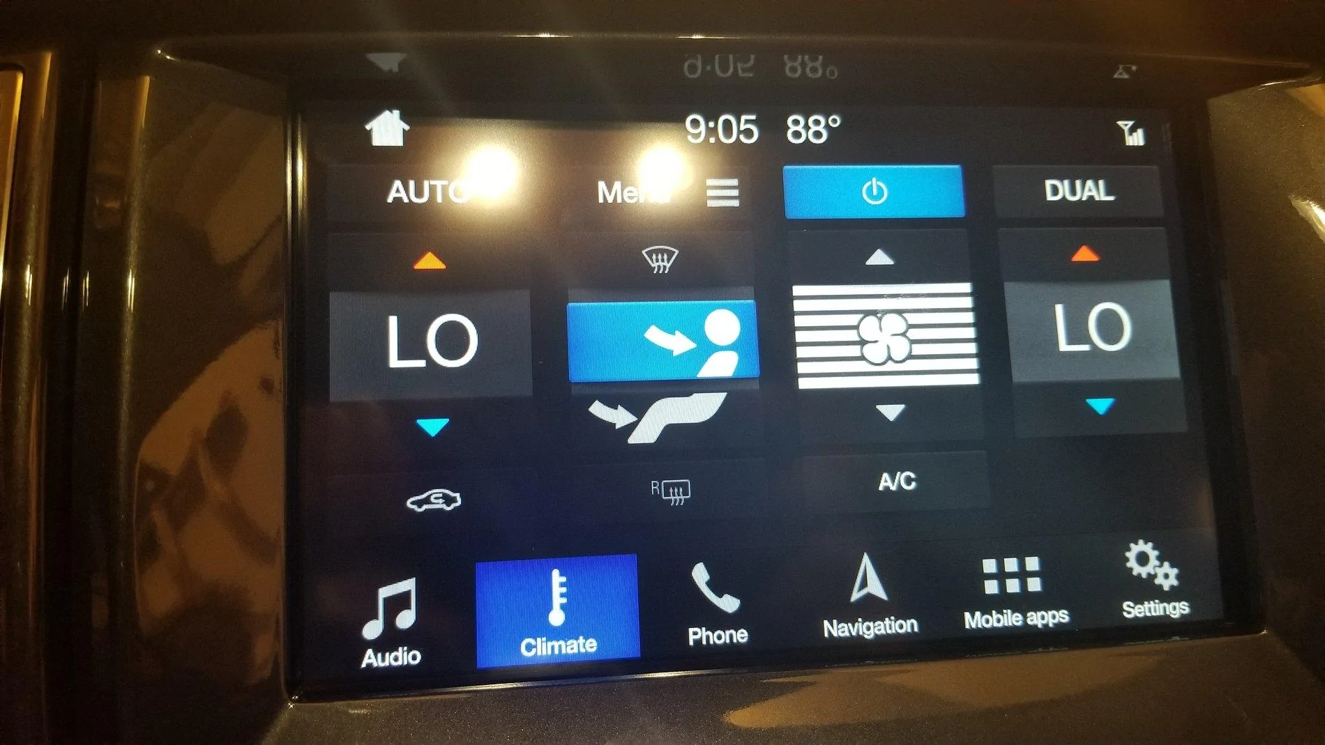

(1) When I select the icon that sends air to regular vents, I get good airflow out of the main vents (see photo #1).

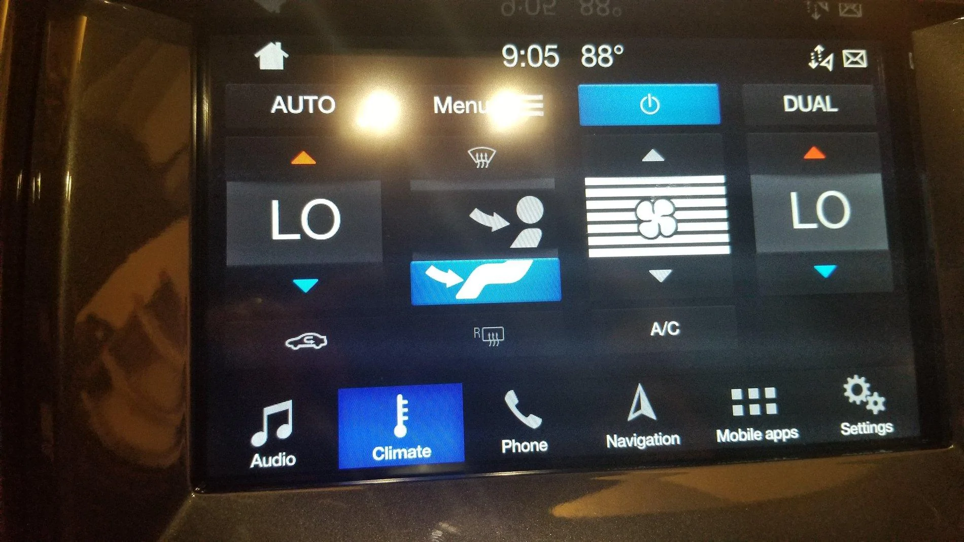

(2) When i select the icon that sends air to my feet only, I get air down there but not as much as I would like (see photo #2). It's not like it's the same amount of air as in #1 just redirected to the floor.

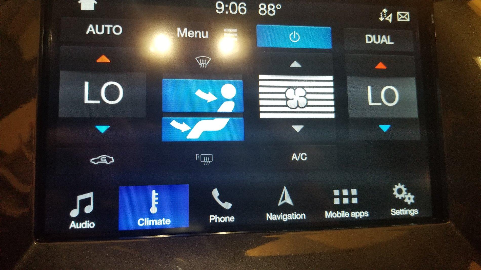

(3) Finally, when I select BOTH icons at the same time (see photo #3), which would split the air between the upper and the floor, I can hear more air noise near the front of the dash but I get virtually NO AIRFLOW from either the main vents or the floor vents. It's like it is almost completely blocked.

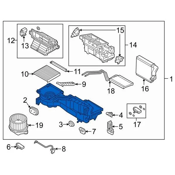

Looking at the diagram below, there doesn't appear to be any sort of coolant inlet valve that controls coolant flow into or out of the HVAC system. Nothing on the water pump or radiator diagrams, either. So hot coolant must always be flowing thru the HVAC system.
#13 (HVAC Air Adjustment Control Motor) #15 (HVAC Air Inlet Door Actuator) seem to be the only way to control how air is directed inside the system: over the heater core or over the evaporator. Just guessing that one or more of those actuators, or the doors that they control are acting up.
