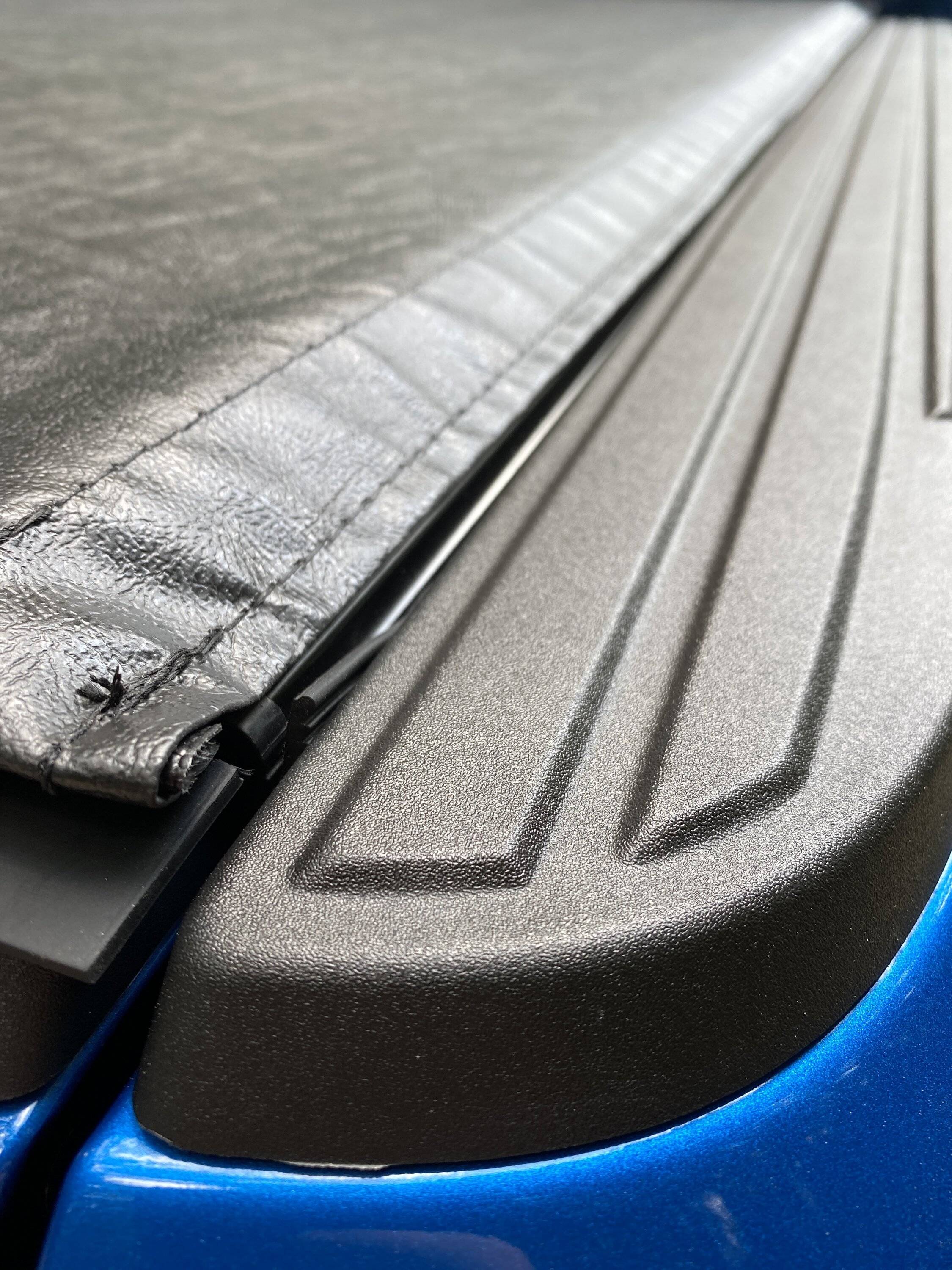

Finished! Instructions are worse than IKEA but should be okay.
I just notice the rubber on the passenger side rail sticks up a bit at the end, but shouldn’t be an issue?

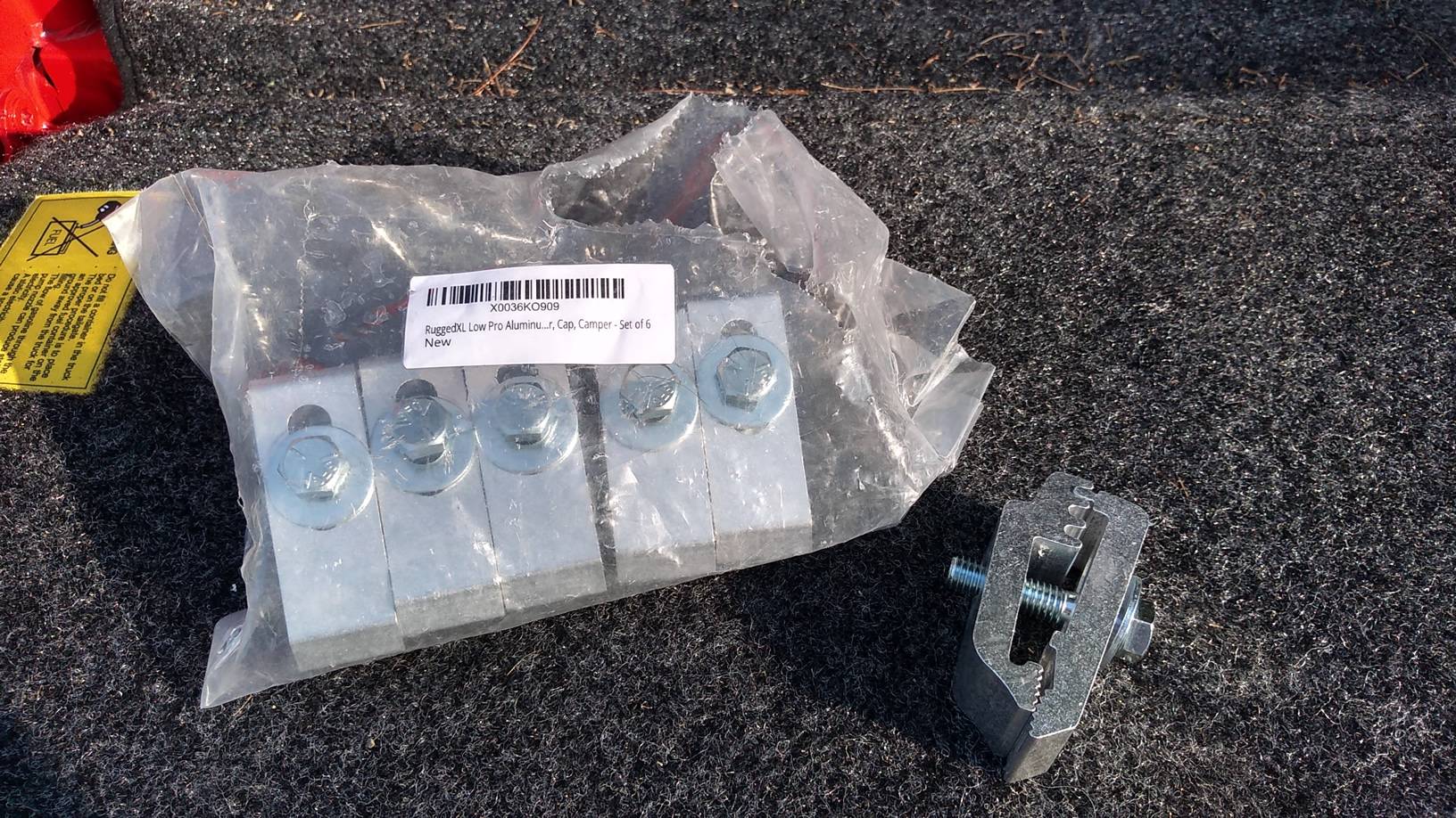

And, not sure everyone has this but I had a bear of a time getting my clamps on to hold the side rails squarely in place. It looks like your side rails are angled upward and that may help offset the issue I had.
The plastic rail cap doesn't sit flush against the sheet metal under it, so when you attach your rail clamps, it'll tend to want to squeeze and angle your side rails down toward the bed. The kits come with shim/spacer material but this was a new concept to me and I had to redo it a few times to get it right. I'm still a bit off on the rear driver side but I gave up.

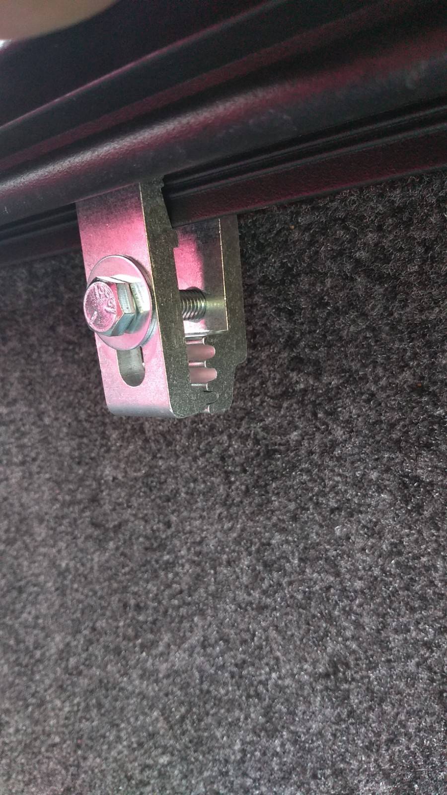

pic from your tonneau cover, will likely need to shim between the plastic rail cap and the sheet metal under it to keep the rail nice and square
Well done! Looks pretty good to me! =)
