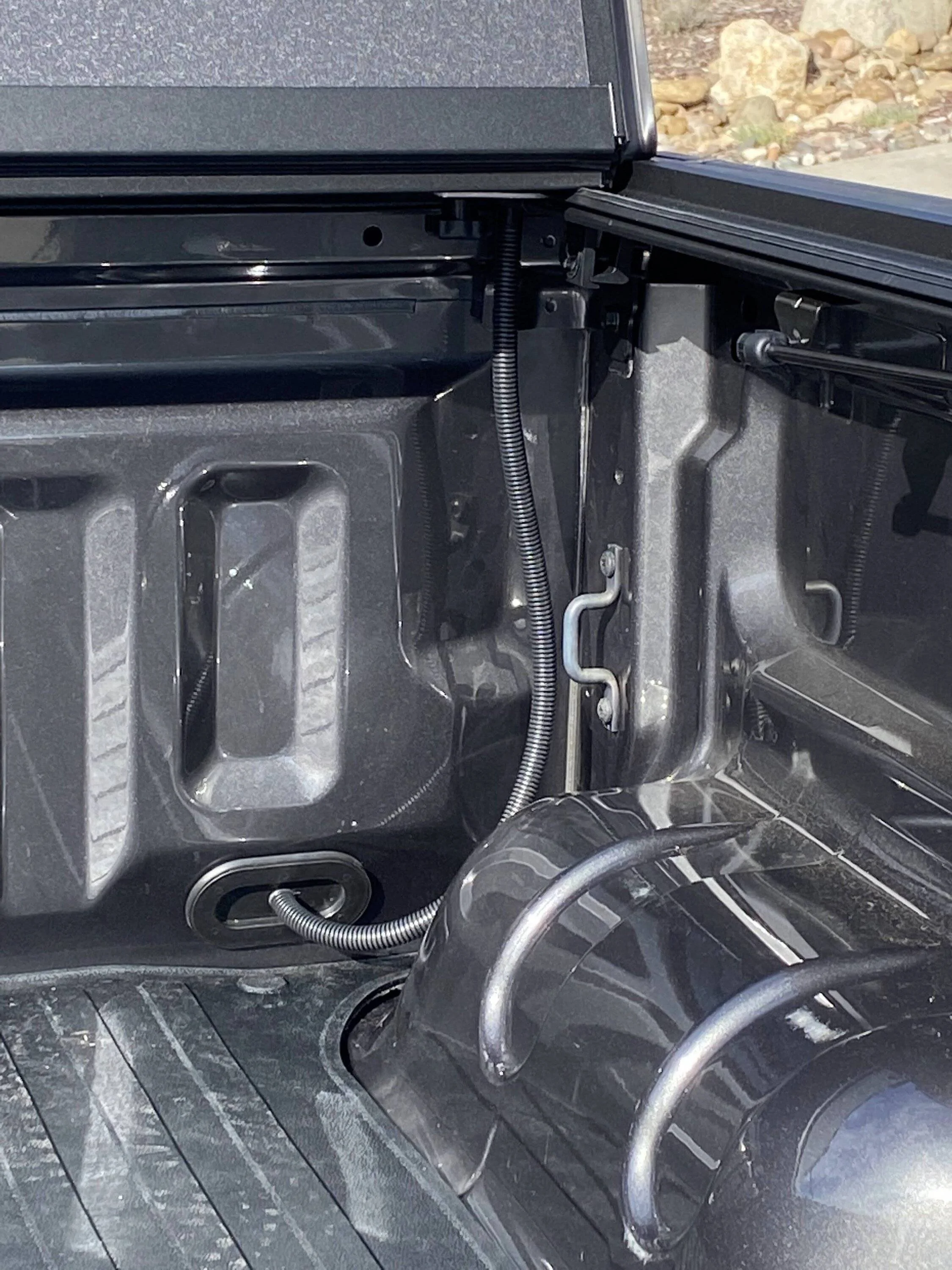

Yes, drill there and run drain tubes there. When I got my BAK cover, I contacted support about where to run the drains. They told me to run them there. That's what I did - they look and work great. Probably need to shorten the tubes thought! Thanks,
