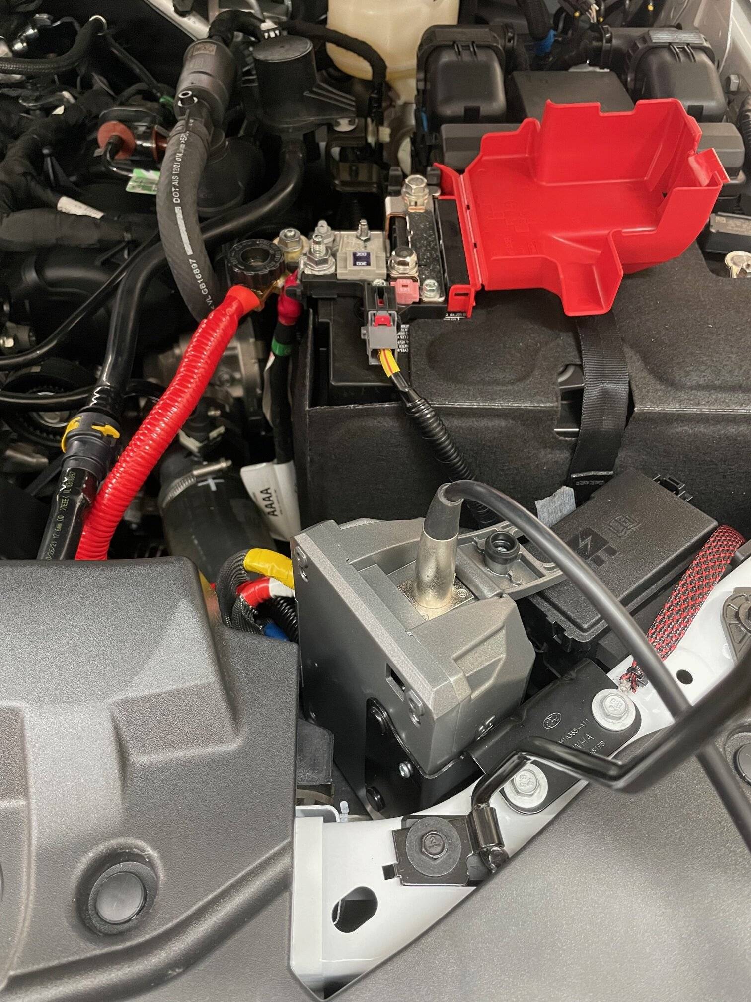

Did this bracket come with the kit?
A bracket did come with the 589 winch mount. I didn't use it as it wouldn't work with the Tremor's extra electrical switch box. I modified the bracket that holds the Tremor electrical box to mount the winch control box.

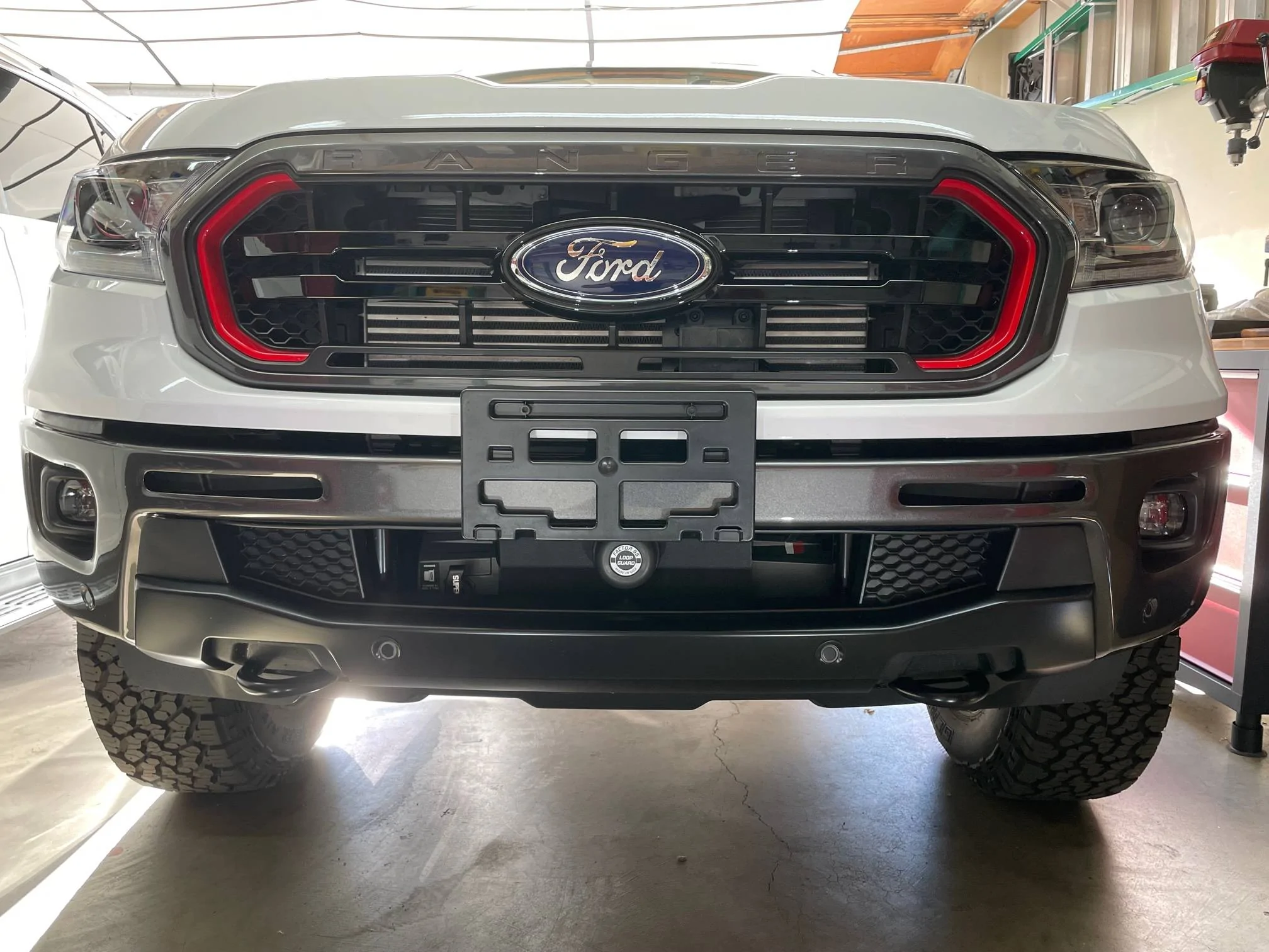

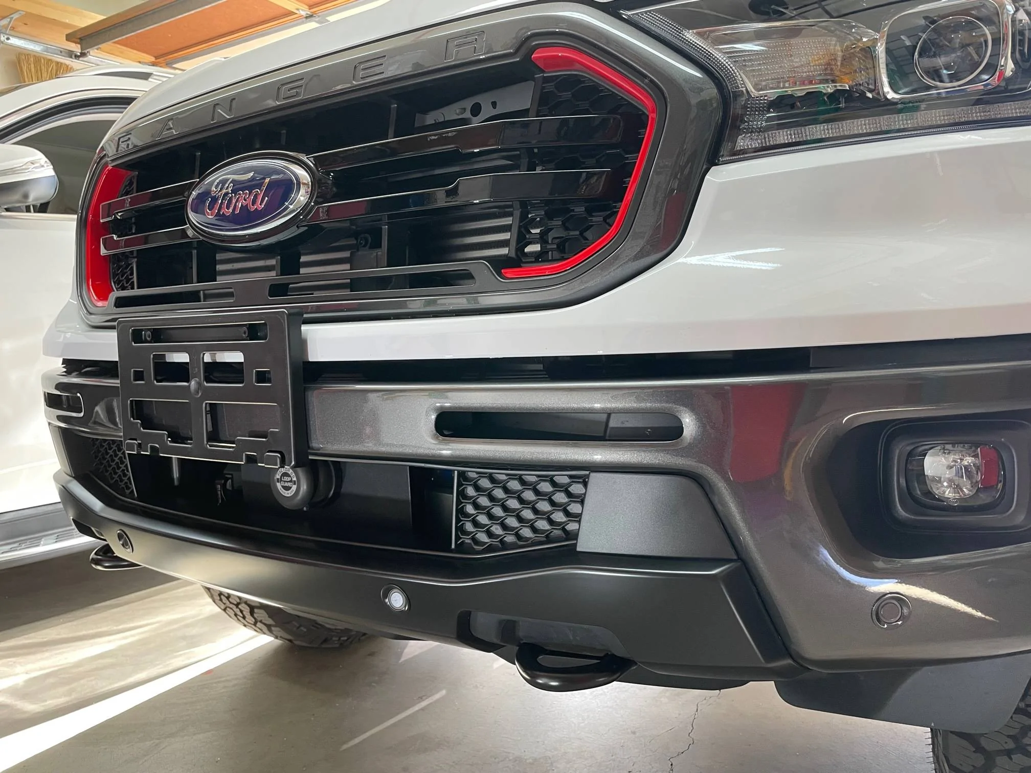

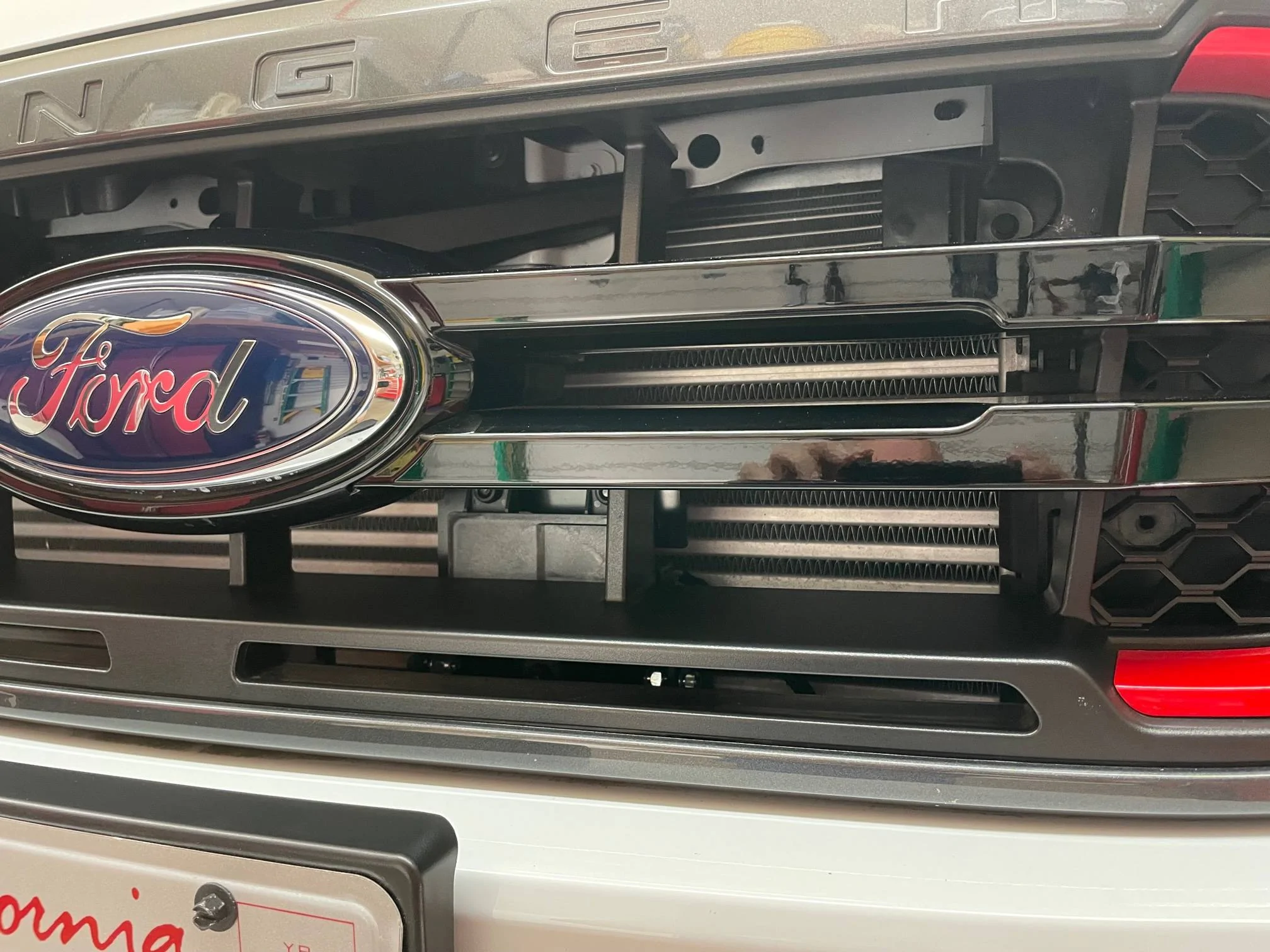

Here are a few pictures of truck all back together.
I like this mount as you use the stock bumper. No extra length or weight of aftermarket bumpers. As well as less $$$ spent.
ACC relocation bracket is from Cali Raised, about $30, well worth it.
https://caliraisedled.com/products/2019-2021-ford-ranger-acc-radar-relocation-bracket
The winch opening I blocked off with a piece of Kendex.
It is held in place by the round Factor 55 Loop Guard.
This will keep the sun and rain from getting to the winch rope.
It is not centered as this is where the rope coil ended up on the drum.
You really need to know what you are looking at to even know there is a winch installed.

Would you mind getting the part number off that ford bracket?
Sorry. Everything is done and bolted in place. Very difficult to remove winch control box with four 02 gauge wires attached.
Ford parts department should be able to provide number.
This is the bracket that the wire connection/fuse box is bolted to for a Tremor.

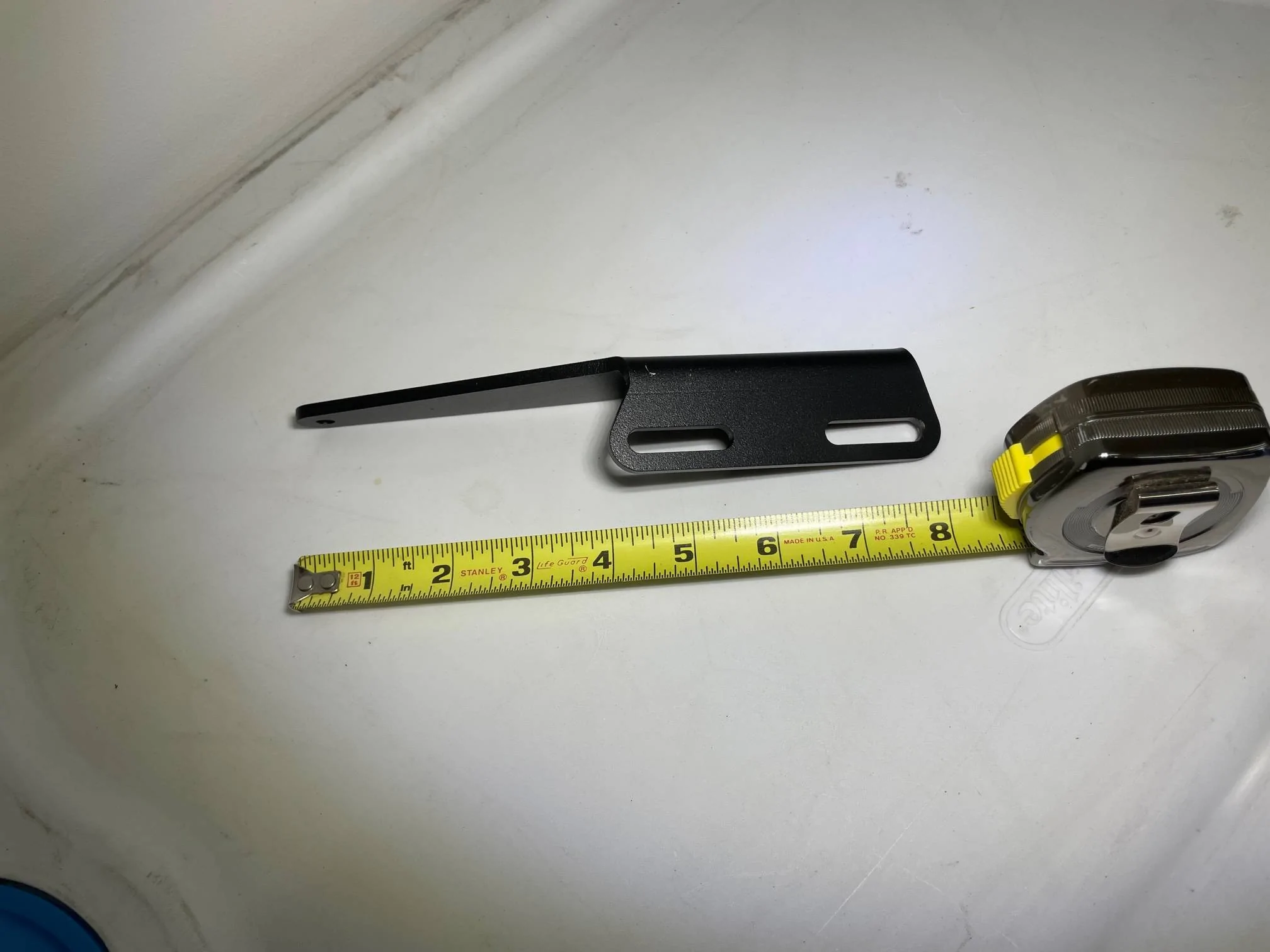

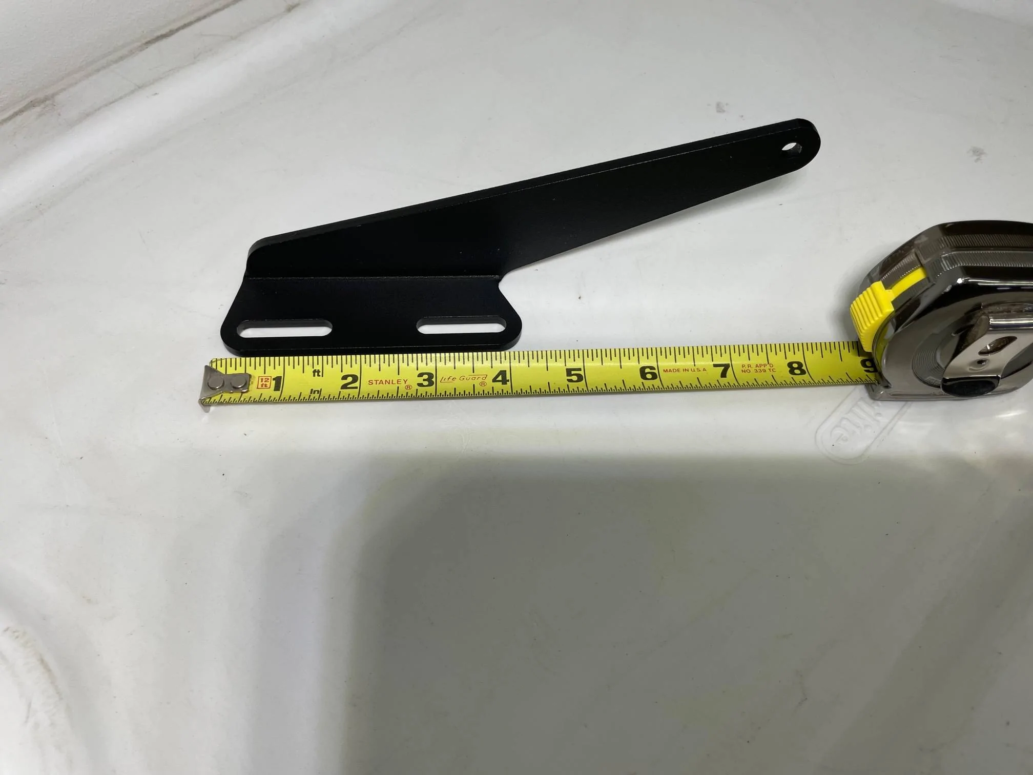

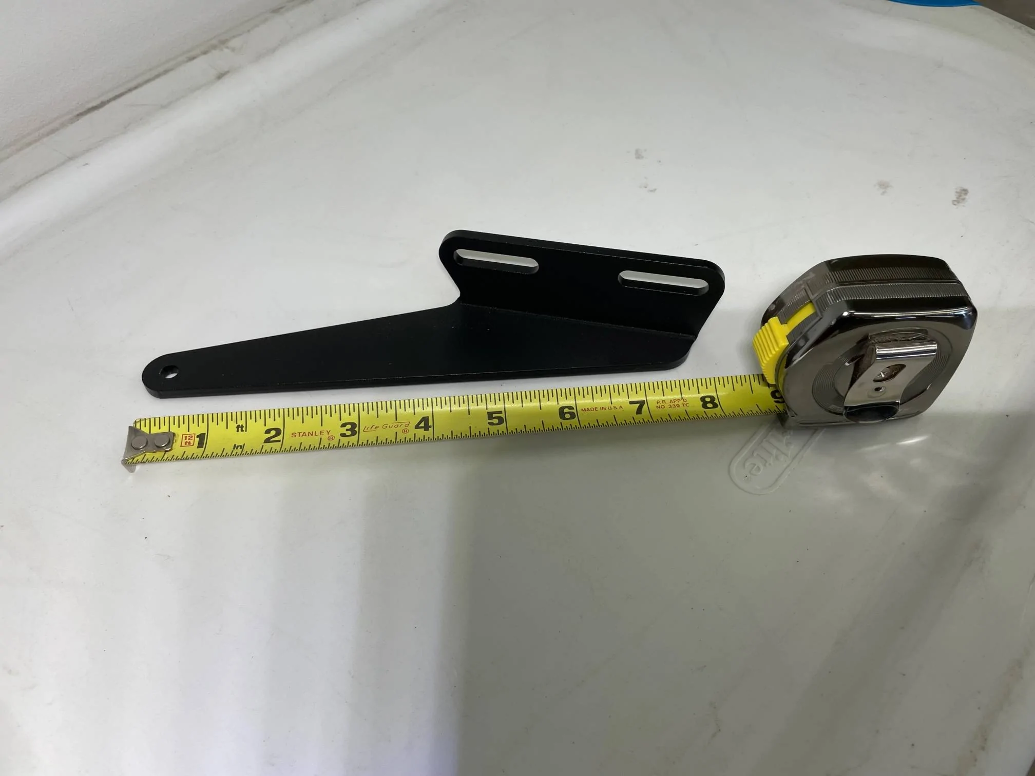

Can you send me a picture of the mount and would you be willing to part with it?
Here are some pictures of the 589 winch control bracket.
They would probably sell you just a bracket if you gave them a call.
