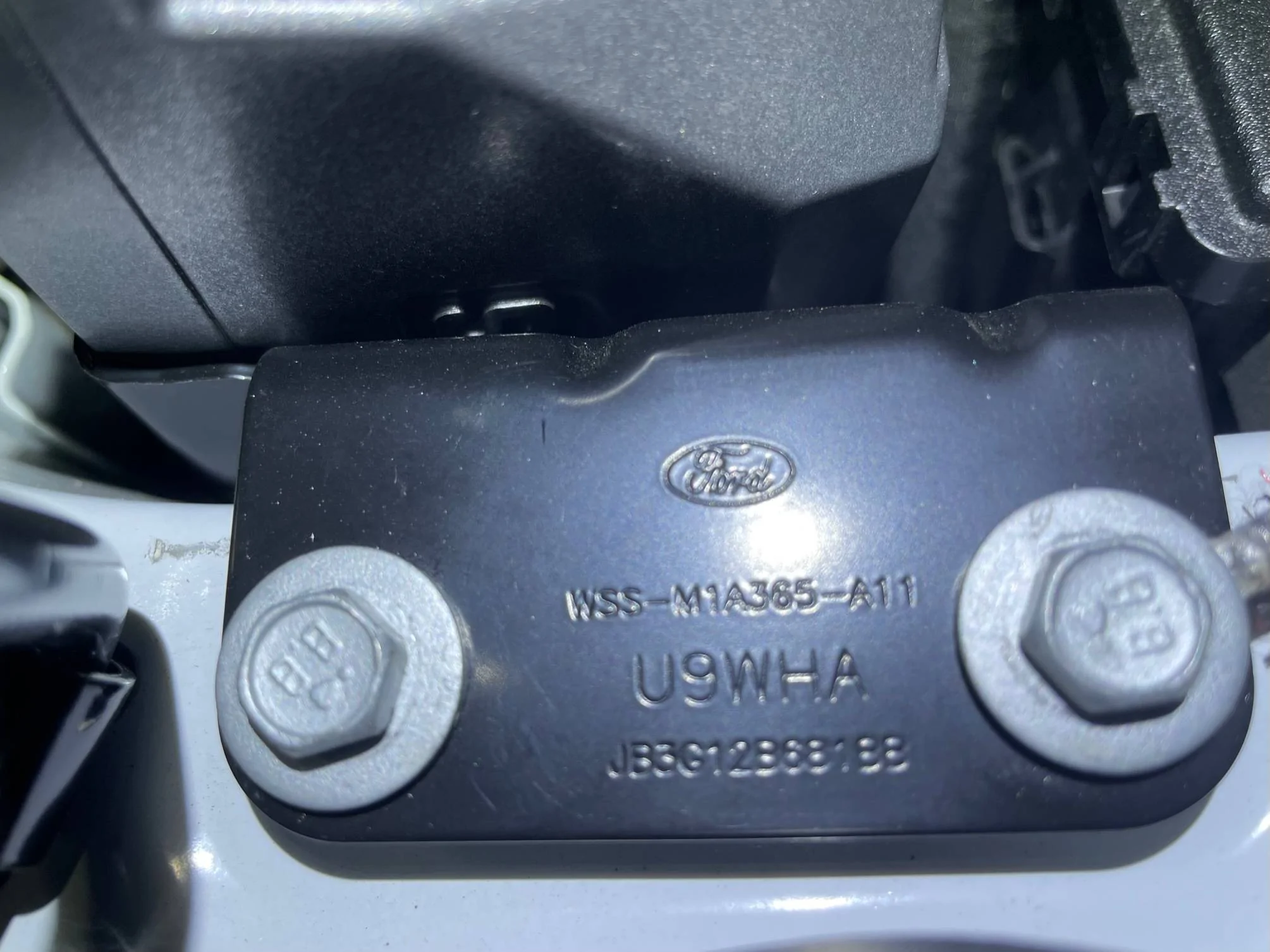

Sadly, Ford has Tremor specific parts locked down and, even with a Tremor VIN, they couldn't find the part. I'd need a part number. No worries, I will find it another way.
I didn't realize the part numbers were easily seen on the stock Ford Tremor bracket.
Hopefully this will help you order this part.

Were you able to find this part? I want to throw a compressor in that area and would prefer to use/adapt an existing bracket v. designing my own
nope. ??‍♂ 2 ford dealers, 1 of which my buddy is the GSM, can’t find this part, even with the number…
That's wild, i'll be on the lookout for any dealers with these Tremors on the lot and let you know if I have any luck...
we got the vin from a tremor and they still couldn’t. Let me know what you find. Apparently, it’s not available as a standalone part.My buddy thinks it’s due to supply chain issues.
