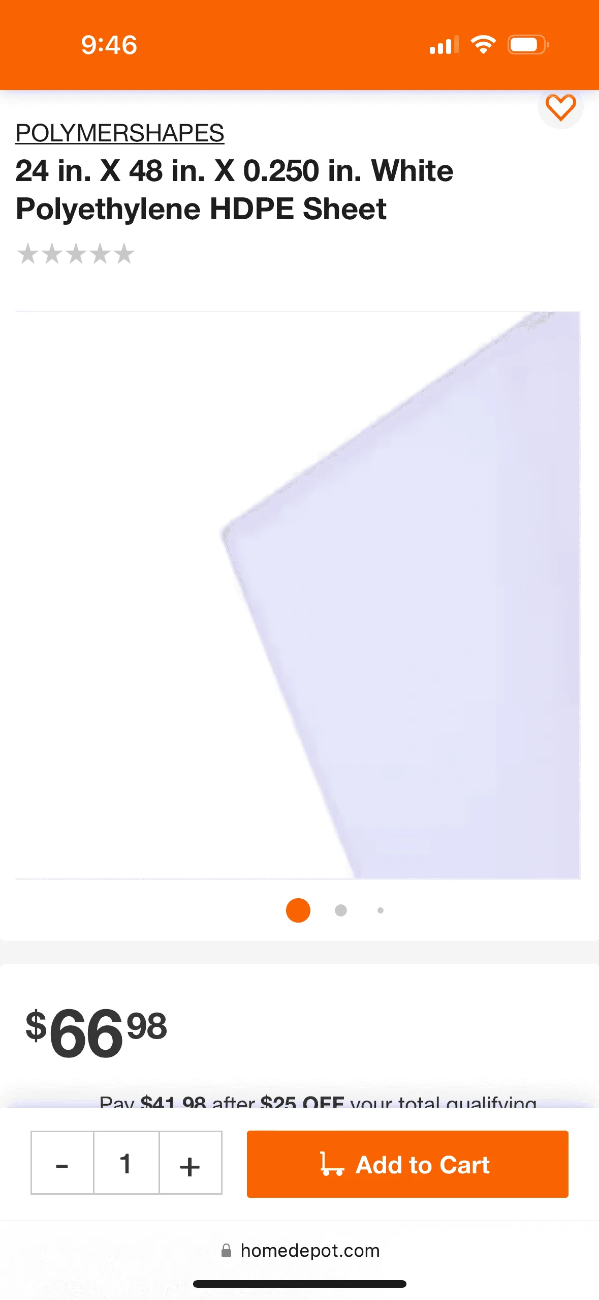

@Firefighter681 menards has 1/2" thick pvc panel for cheap and solid to work with
https://www.menards.com/main/buildi...pvc-panel/1429327/p-1510903720175-c-13411.htm

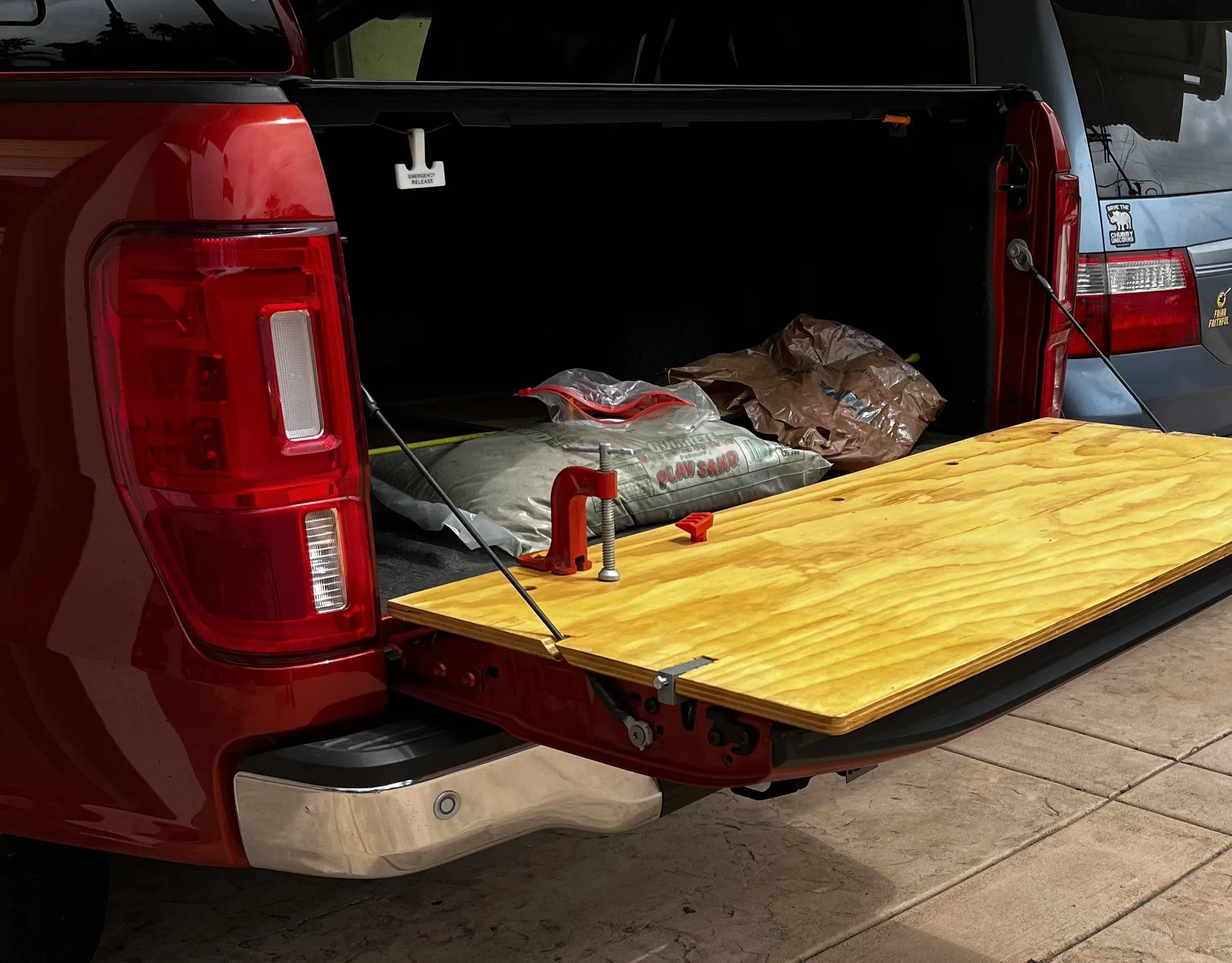

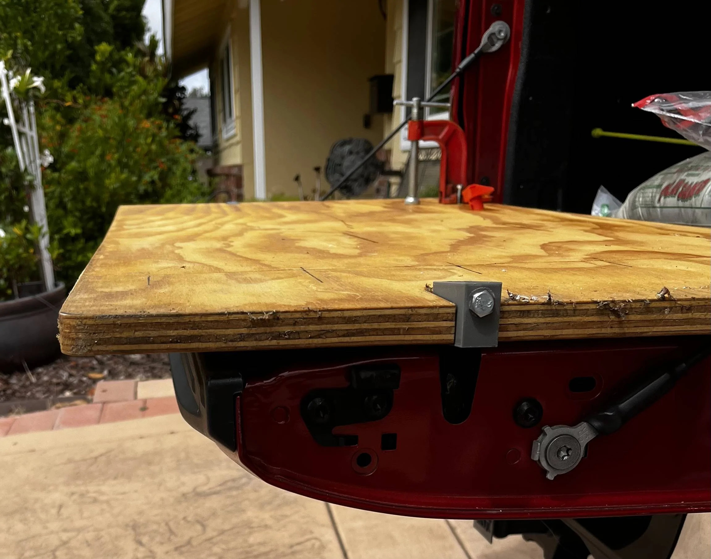

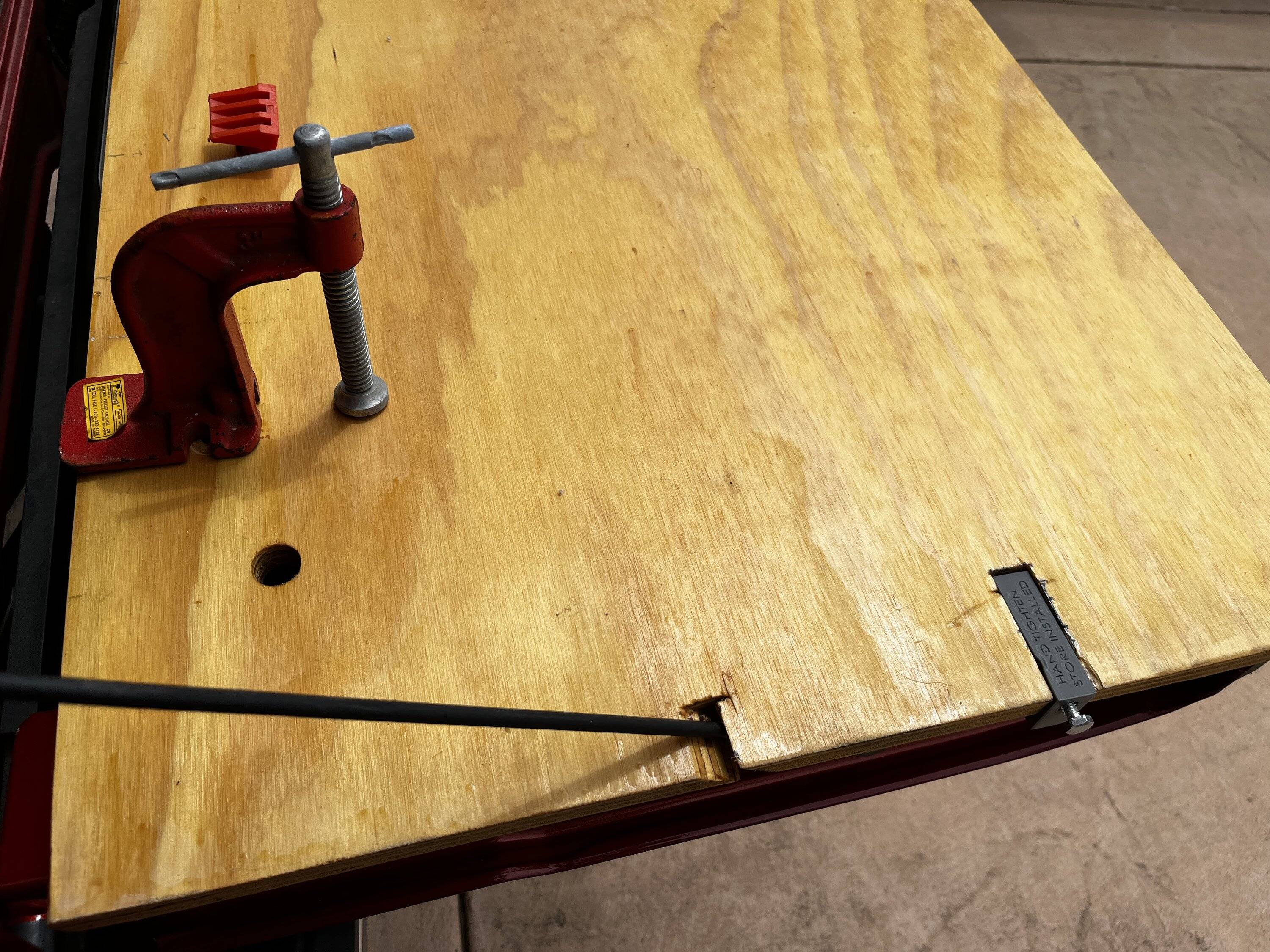

As you can see, I cut diagonal slots, so it nestled into the tailgate support cables. I wanted the wood wide, so nothing was resting on the metal tailgate when we doing work. I also need an upward force control so I designed in 3-D printed little blocks that slip into just a bit of the tailgate metal, keeping it stable held in with a quarter 20 bolt.
I are an engineer, and retired.
