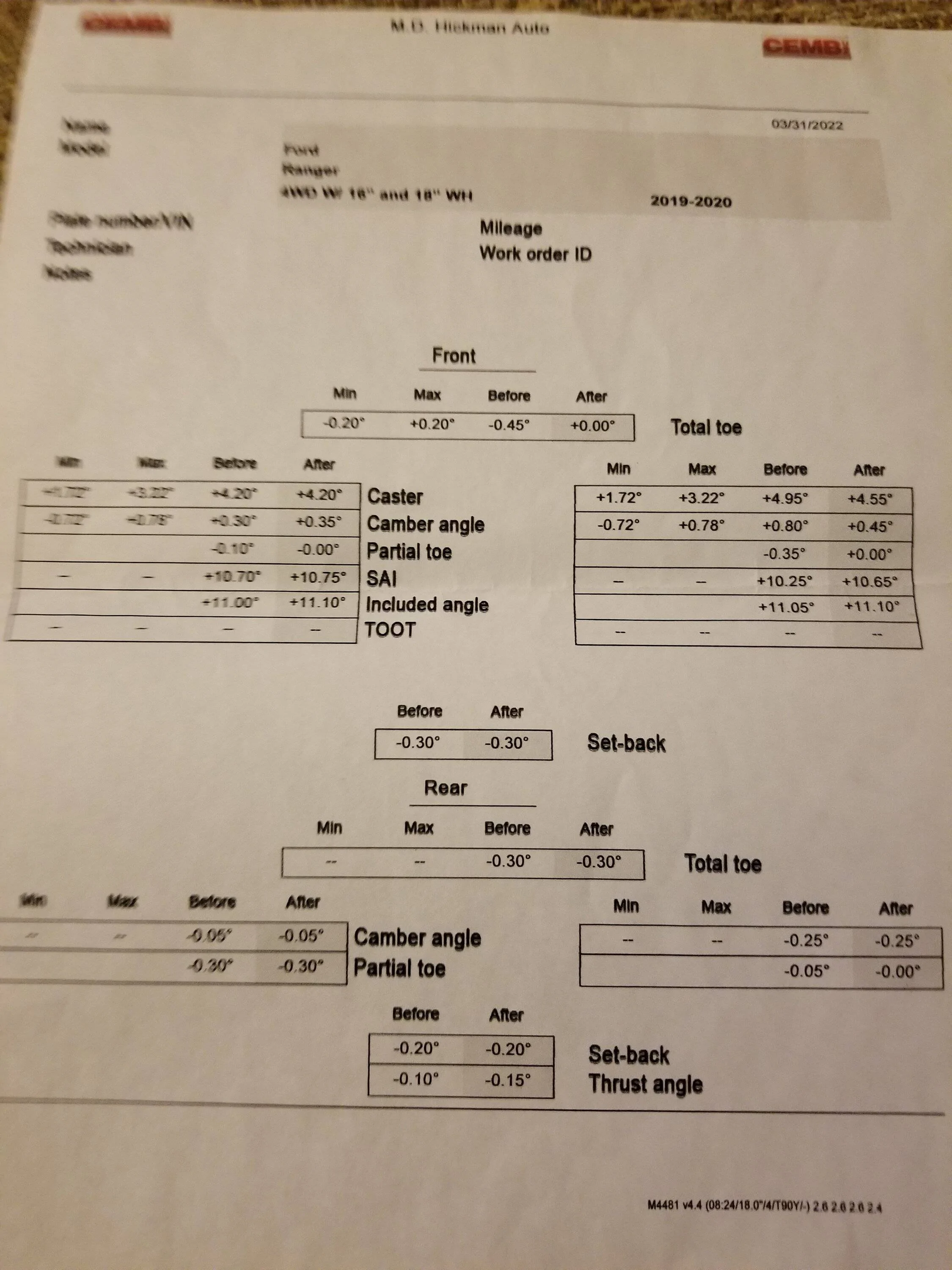

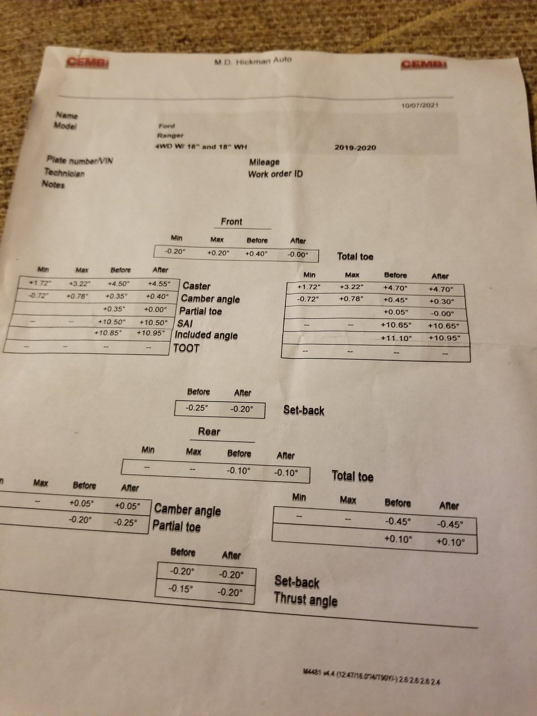

Looked back at my alignment numbers before and after doing my spring swap....thrust angle only changed .05°...

Printouts for alignment...top immediately after spring swap, bottom current after settling time, and upgrading my coil overs to the ICON 2.5 CDCV ET RR...Rear to the 2.5 CDCV piggybacks...

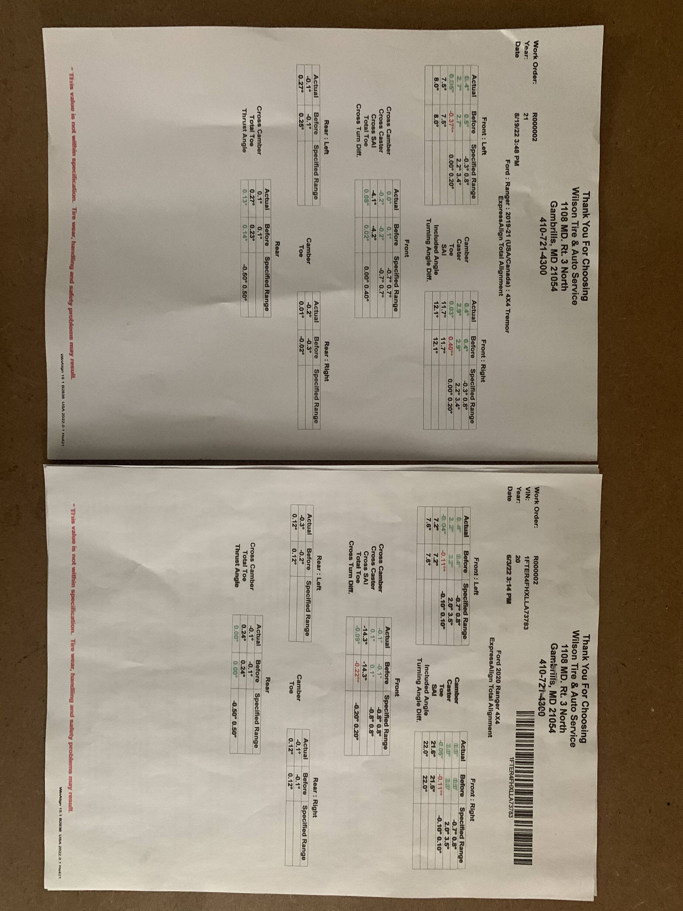

got my. alignment touched up. toe was kick due to thust angle being tweaked a tiny bit. i had them use the specs for a tremor.
here is the before and after.
note- stock springs were 0.0 thrust angle, icons were .13 .
its not a great alignment, but good enough and it was free. so no complaints there.

Interesting they have more caster on passenger side versus driver side now. It may tend to drift to the right now especially if the road surface is crowned heavily in the center.
Wolfman00
May 24, 2021
61
494
339
maryland
2020 fx4
interesting enough- they only hit my toe, never touched the alignment cams.
JasonTremor
Feb 1, 2022
869
1,917
2021 Ranger Tremor XLT
How much lift did you get out of the leaf spring swap? Had to be a bit to reduce the caster numbers that much.
i pulled the 3rd leaf because they sat too high. im 1/2” above stock. if the pack settles too much ill toss the 3rd leaf back in.
