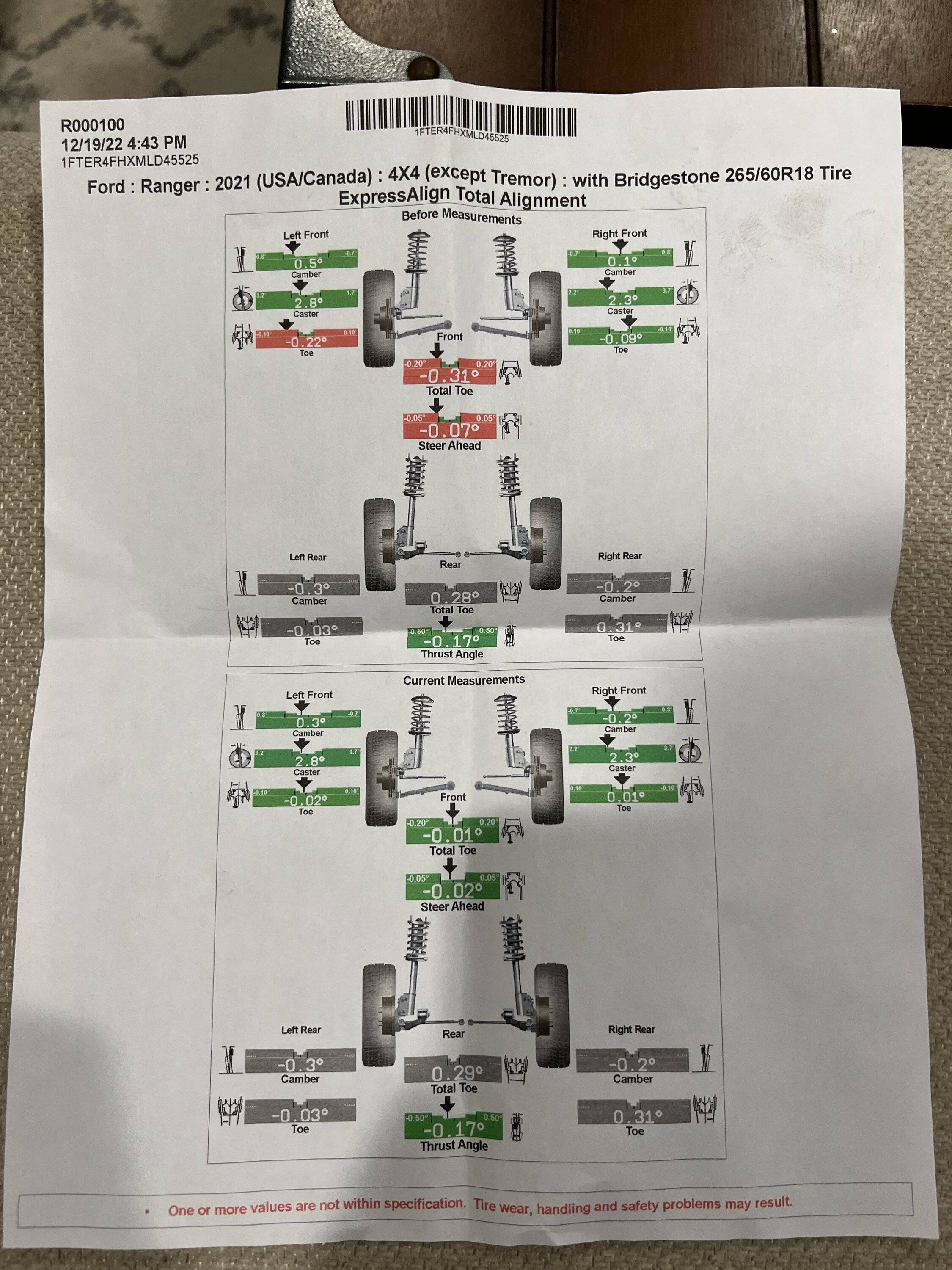

A few weeks ago I noticed the wheel was slightly off despite the truck not pulling on me. Just got an alignment done today. I still feel the wheel is slightly off in the other direction now, but ever so slightly. The shop said they had no issue getting it back within spec.
I’ve had icon stage 1 on all four corners for a little over a year now. Is it time to upgrade UCA’s to ensure the longevity of my tires and get the most out of the coilovers? Not sure if the wheel is more of a cosmetic issue.
Picture attached!
thanks

they did a pretty shit alignment. a toe and go and thats it. id take it back. you dont need ucas, just a more enthusiastic alignment tech!

Thanks for your input! Does it look off to you? Trying to figure out what needs to be fixed. Is the wheel not being perfectly straight a good indicator?

a crooked steering wheel is a classic sign of a lazy tech. your alignment isnt bad, but regardless- you paid for it to be right, and not have a crooked wheel.

Couldn’t agree more. Thanks
