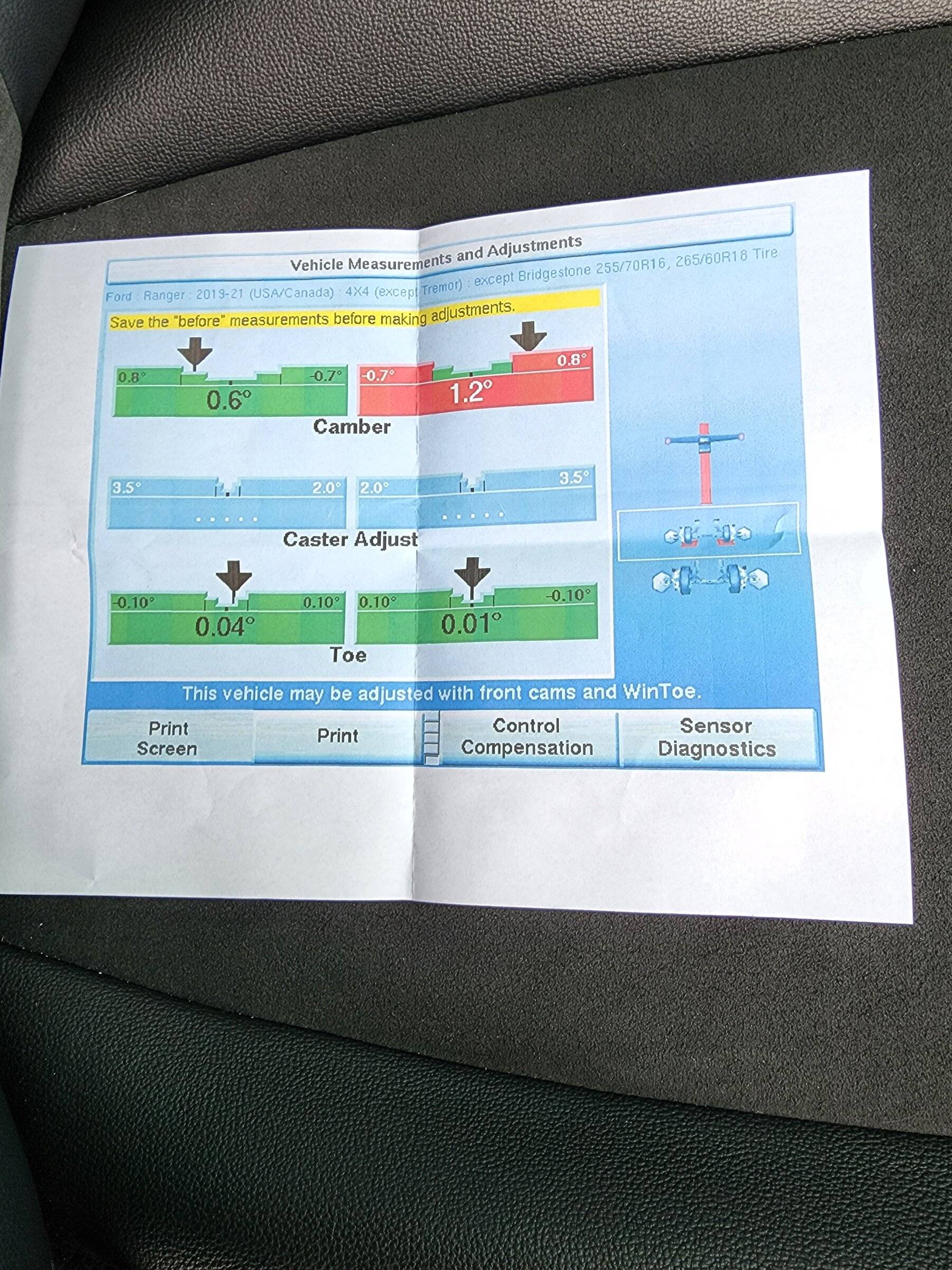

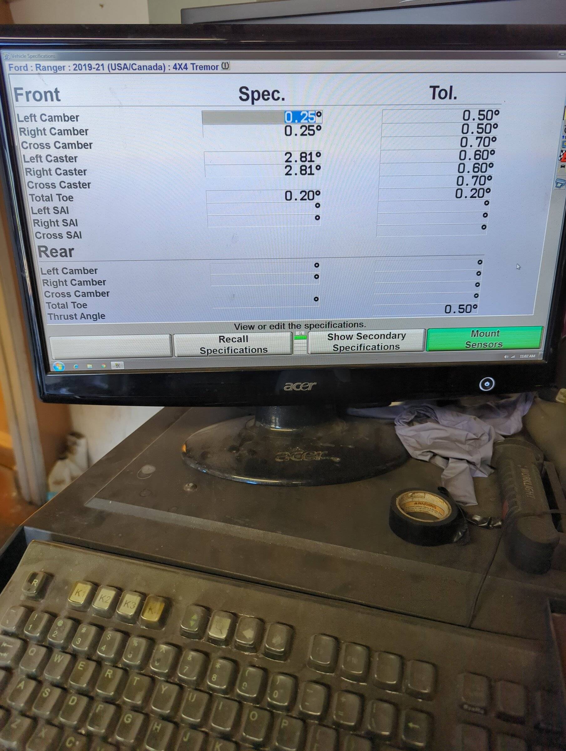

Well, the good thing is their machine seems updated enough to know there is a Tremor model out there, but if you really have a Tremor, that means he aligned it to normal Ranger specs and the Tremor is slightly different. I already had 1" wheel spacers but got the 1" level and went to get it aligned despite feeling good.
Short story:
Point out you have a Tremor. Have them redo it or go somewhere else.

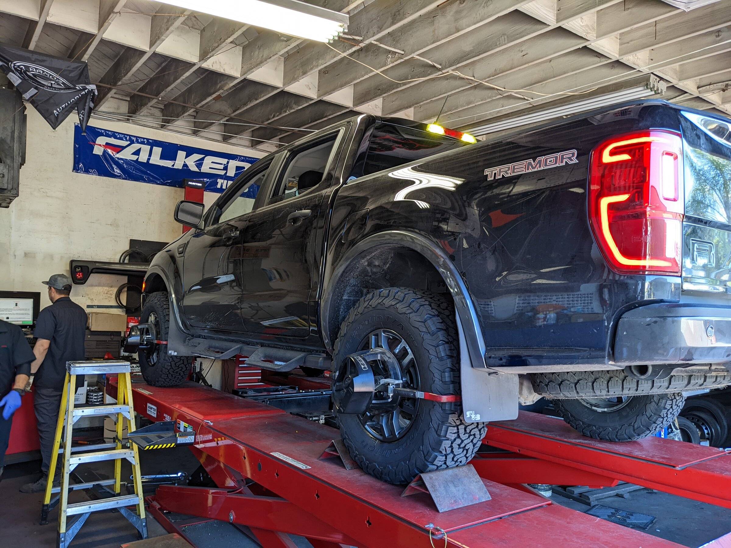

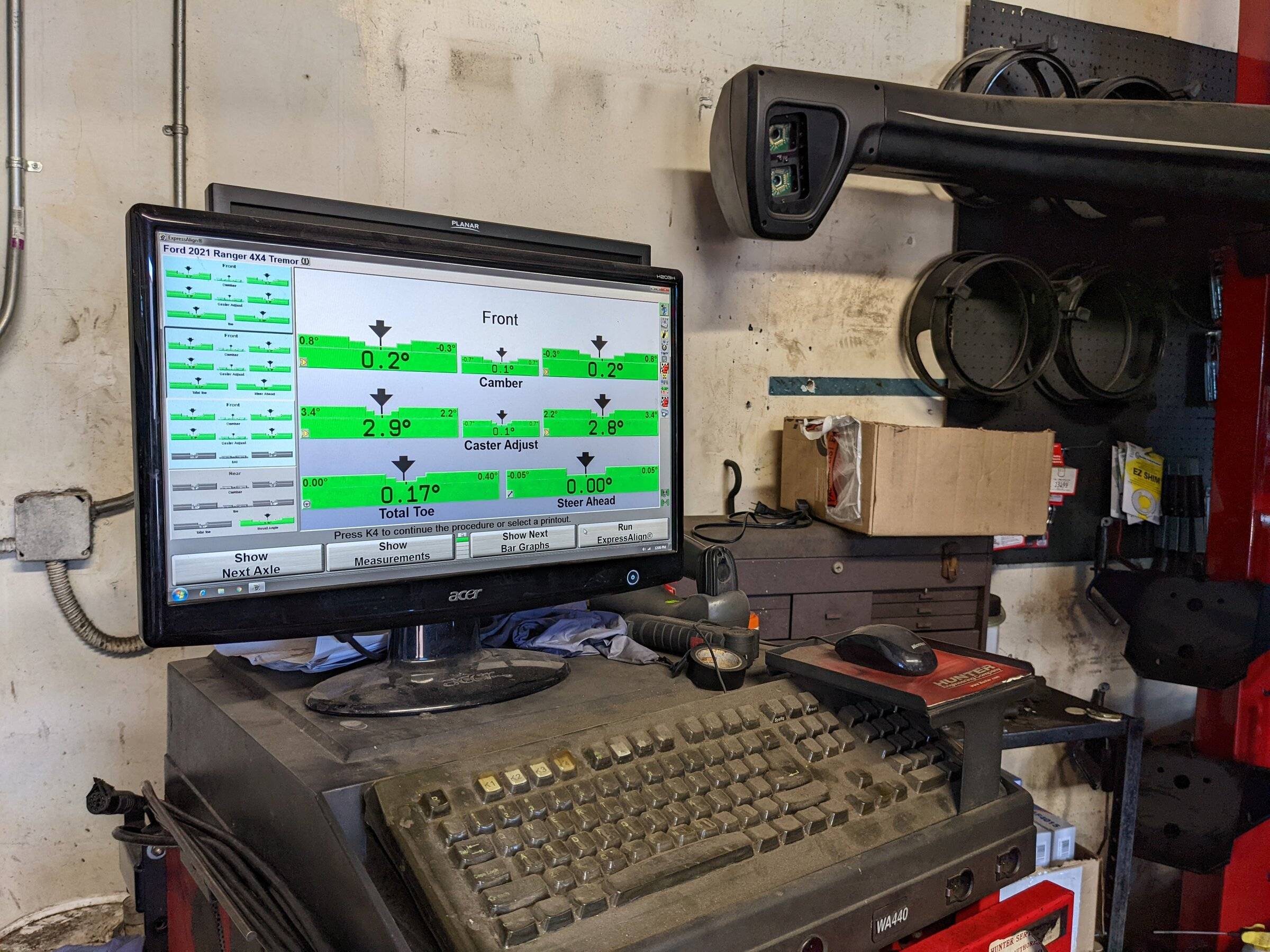

I had a HELL OF A TIME finding a shop that actually had 2021 Tremor specs in their system. Spent too much time calling places. First place had it and their alignment tech seemed to know his stuff but they warned me their sensors are too close to the rack and sometimes the have issues with trucks. So sure enough, got readings but once they lifted the sensors lost communication.
Firestone said they had it, nope, got my specs and it was 2020 specs plus the steering wheel was WAY off center, comedic how bad it was.
After calling several places, a hot rod shop recommended a place, went there but again, steering was off. I asked them to fix that, they got it way closer but I just gave up at that point because I figured maybe I am being picky. Did a road trip towing and the Ranger seemed to wander. We deal with wind but was not windy.
Threw in the towel and took it to my buddies shop in CA. From Vegas to Inglewood! It is just an alignment, not sure whats wrong with these shops. The very popular Vegas alignment shop was 2 weeks booked and I wanted it fixed sooner.
Took it to my buddies shop, he dialed it in perfectly. Drives GREAT again. Plus while there, somehow some BFG K02 285/70/17 made it onto the vehicle...somehow lol

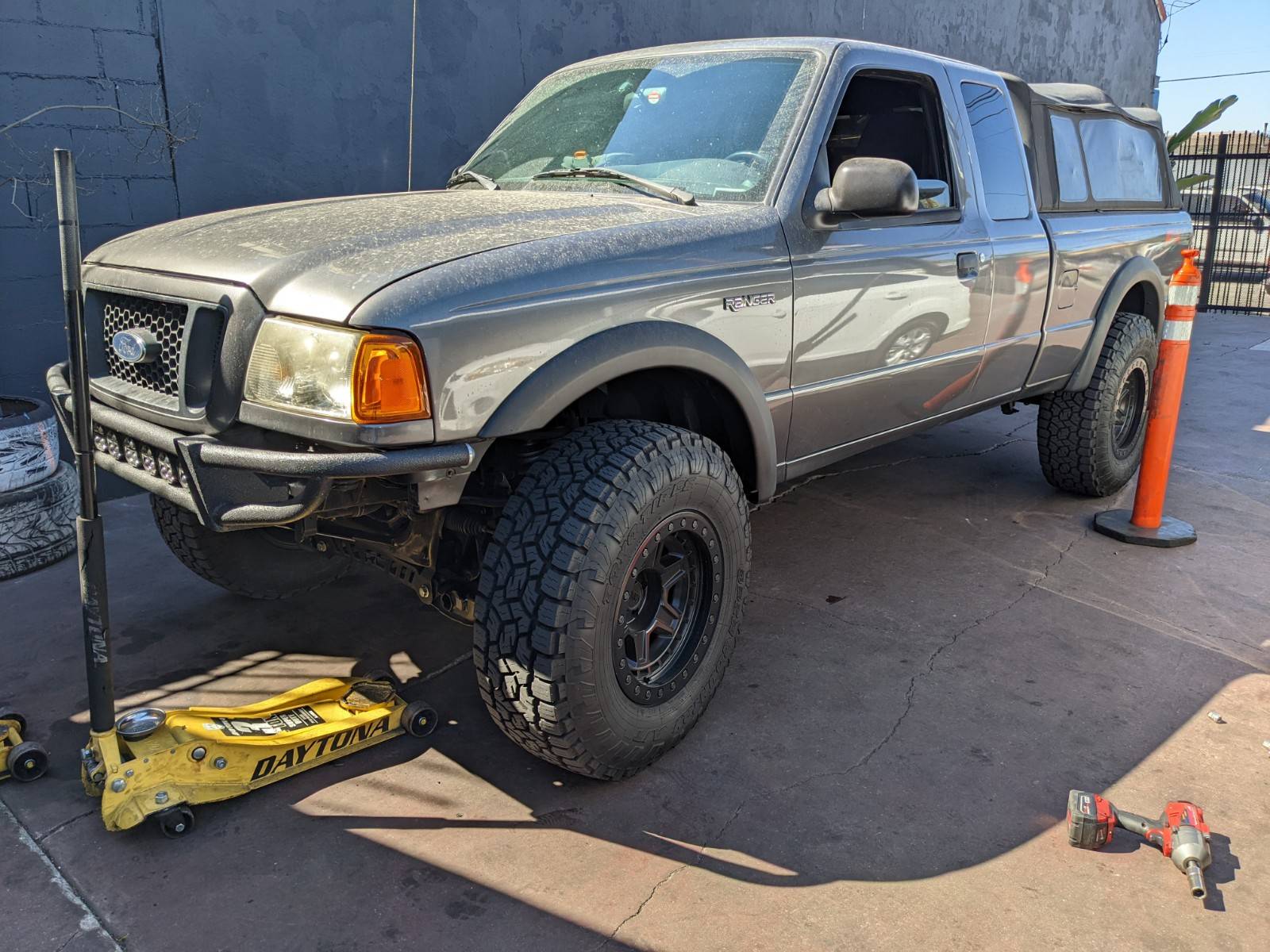

Threw in a pic of his Ranger for good measure lol
