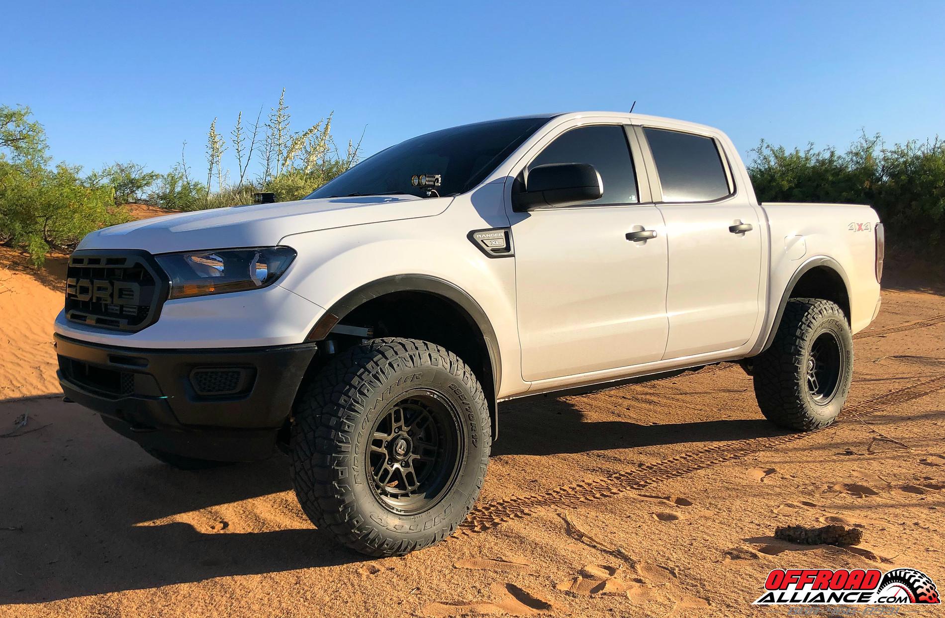

We have two 2019 Rangers, both with the Icon kit. One has the tubular upper control arms and the other has the billet arms. Billet equipped has 285/70R17 and tubular has 275/70R17. Both fit great!
We've got these kits in stock and ready to ship. They've been very popular for the new Rangers. Ride great, look great and perform really well both on and off road.
Here's the 285's:

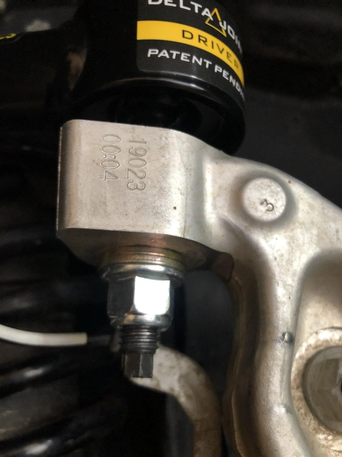

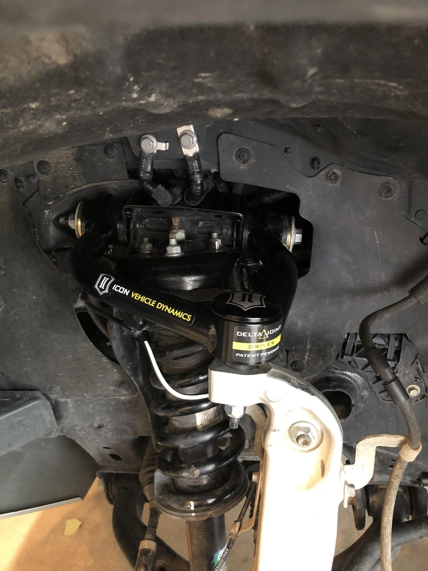

Took a while for me to line-up a day off from work and an appointment with my alignment shop but I finally got the ICON tubular UCAs installed on the truck. My alignment shop was able to get the truck exactly where they’d like to see the caster/camber/toe. They were expensive ($750), but they look nice on the truck, allow more travel than stock and allowed me to put my truck back into proper alignment.
Some notes about installing this kit.
1. The kit had a couple missing important pieces referred to as “UCA bucket brackets”. They hug the trucks UCA mounting point, and they’re supposed to protect the ground straps on one side (maybe?).
2. There were a set of 4 washers that were not mentioned in the instructions at all. I called tech support. They’re meant to go under the flanged nut for the upper mount to the ball joint. I have included a close-up picture of that. Without the washers, you will run out of threads before the tapered shank of the ball joint is properly seated in the upper spindle mount.
