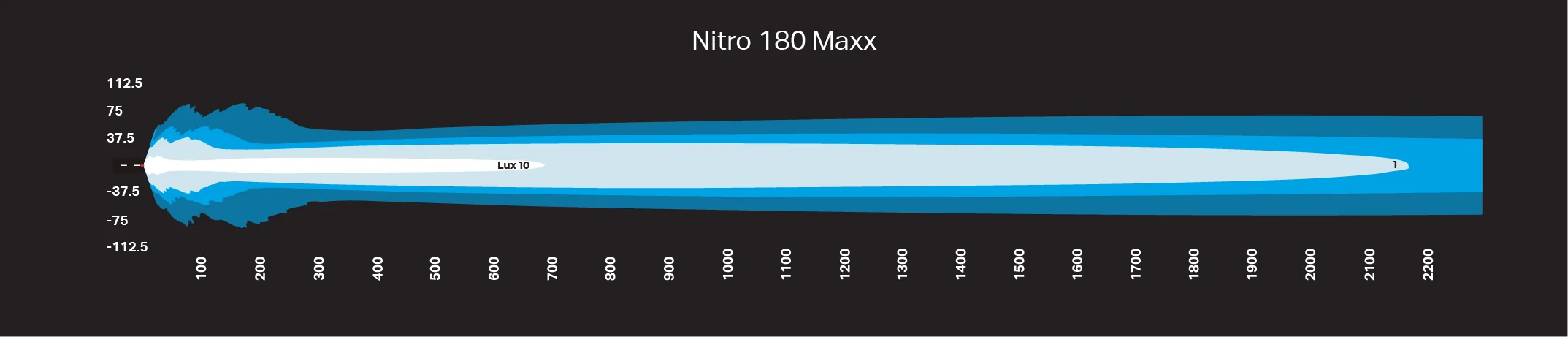

Anyways, from my brief research into AU light brands UltraVision seems like the standard over there in comparison to what ARB and BD they also use 10 lux measurement and 1 lux. Here’s a chart from there website for there top end light which is $1700 not sure if thats AUD or USD. Which shows about 700m at 10 lux. thoughts?

Ultravision (smaller/newer Aussie brand) looks really interesting, and that 1 lux @2200 meters performance is insane. I'm not sure a Ranger's alternator could safely run them though. I might bring over a pair if I buy a new Super Duty next year. No experience with their products so far though, and they aren't answering my emails, which is never a great sign.

I think you're confused about lux distance. It's an objective number created specifically to give lights a metric by which to be compared. I'd agree that 10 lux is a little arbitrary, and the 1 lux standard used by literally every quality light brand is a better representation. It really doesn't matter what number you use since you're just choosing an arbitrary point along the beam of light. BD's lights are as badly outclassed at 1 lux as they are at 10, or 6.75, or 82, or whatever you want to use.
