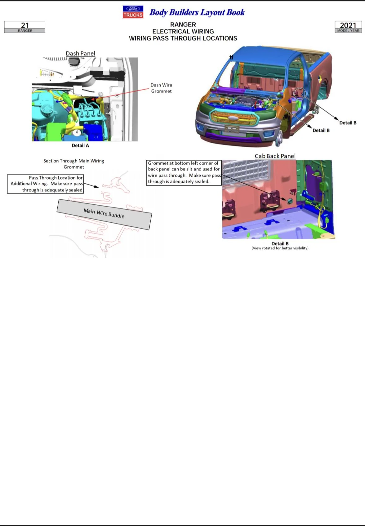

Just got my set of RC 2" off road lights. Where are you guys routing your wiring through the fire wall or fender to the interior?

Any pics and info appreciated.

If it were.me I would go through one of the rubber grommets in the firewall. Why you ask? Its already a path for wires and you can seal it up easy so water has less chance to get in

Thanks I already did some digging on my own and found this picture. Thanks for the tip.
