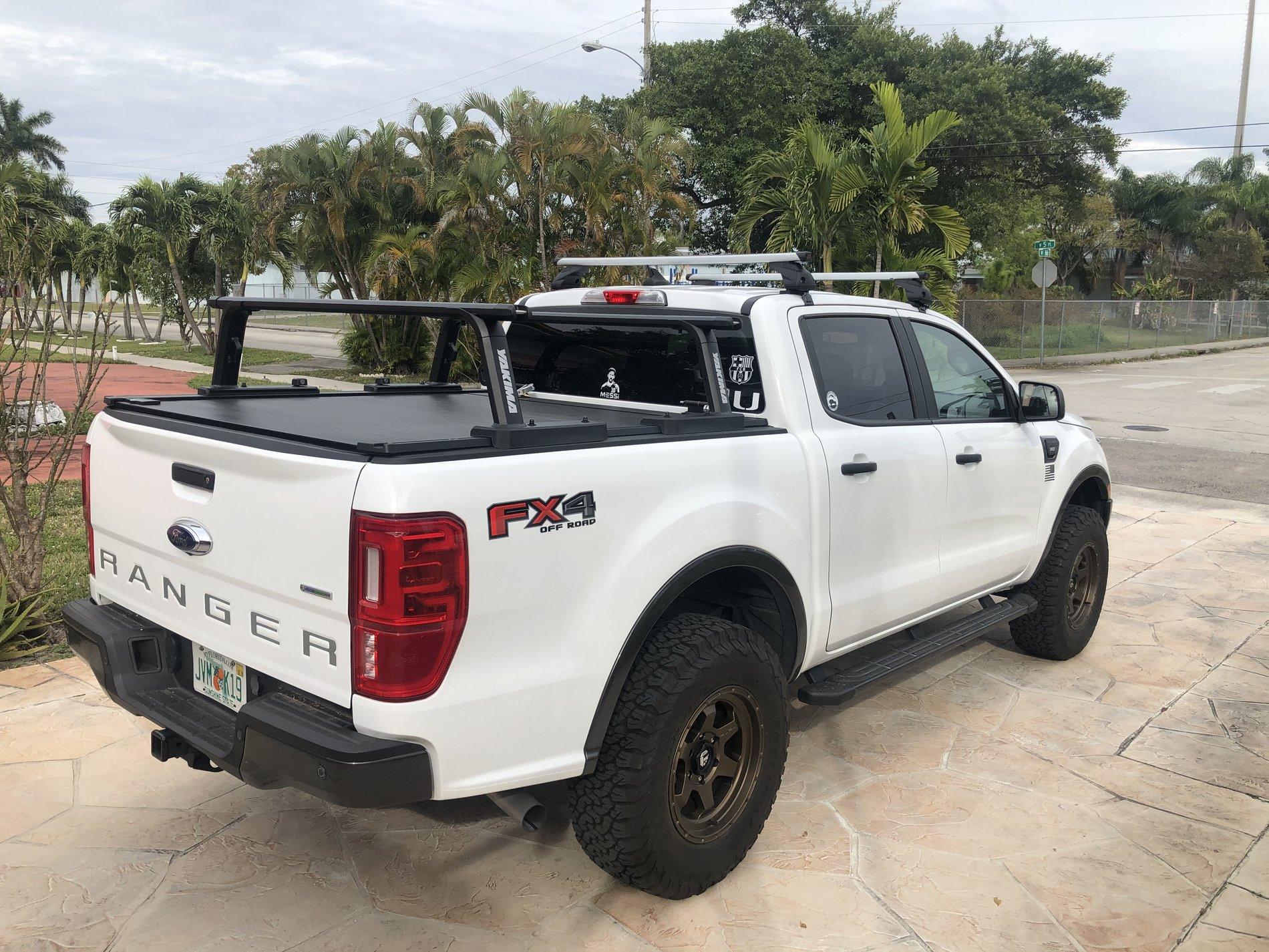

Love your build, oggvorbis and am sooooooo jealous of where you live - just minutes from the Mojave and all the amazing places along 395. I was out there scoping it out last summer in my stock Ranger FX4, but this year I intend to hit the desert out there. Keep up the good work. 👍
