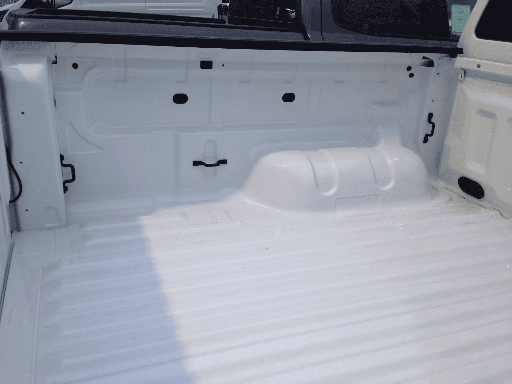

While we're on the subject of tie-downs... How many have you got?? Photo by OP shows 6.
A survey of my local Ford dealer's Ranges (9 in all) showed only one with 6, the rest had 4 (like my '19 Lariat). Wondering if it is "package" thing.
Ford made a change and all rangers built after a certain date only have 4.
So that's what Ford says!!!!:thumbsdown: I ordered the "missing" tie downs today
