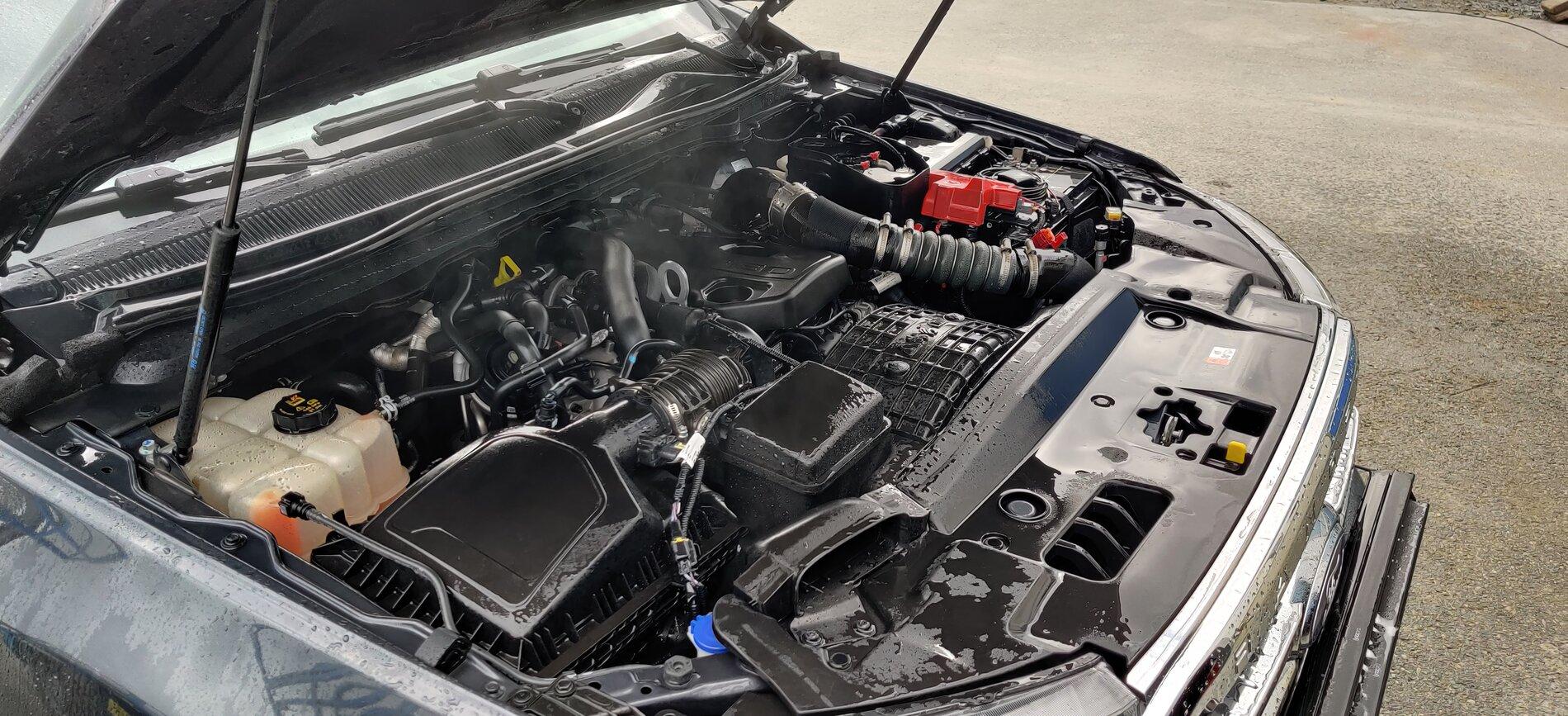

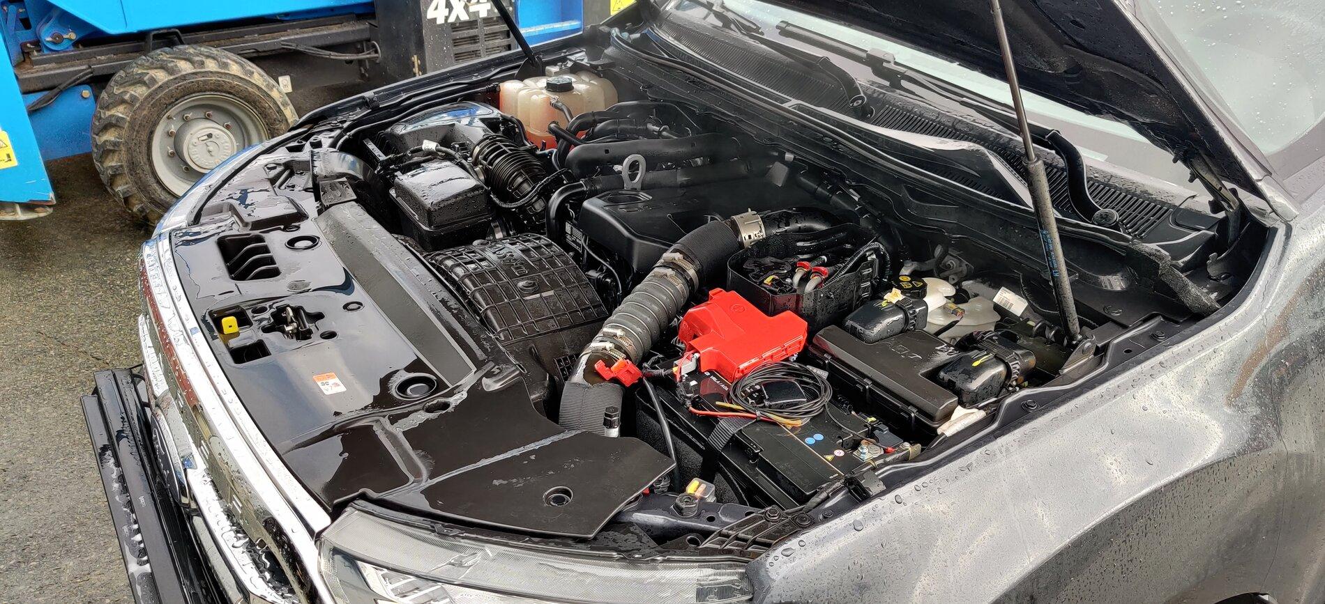

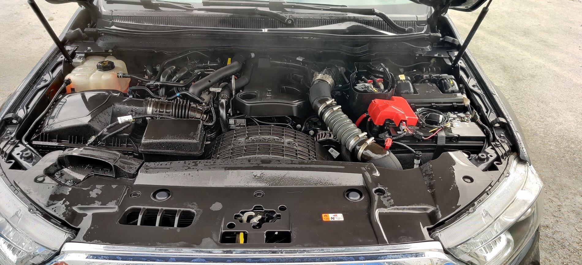

I was real skeptical about it it the beginning, thought it would lack the low end torque the 3.2 has, but actually i think it may be alot better. I drive with loads around 5-6-7000pound daily, and i rarely have to go over 3000 rpm. Of course if i have to gain speed or go up a steep hill i have to, but when i reach cruising speed it almost allways is around 1800 - 2200 rpm.

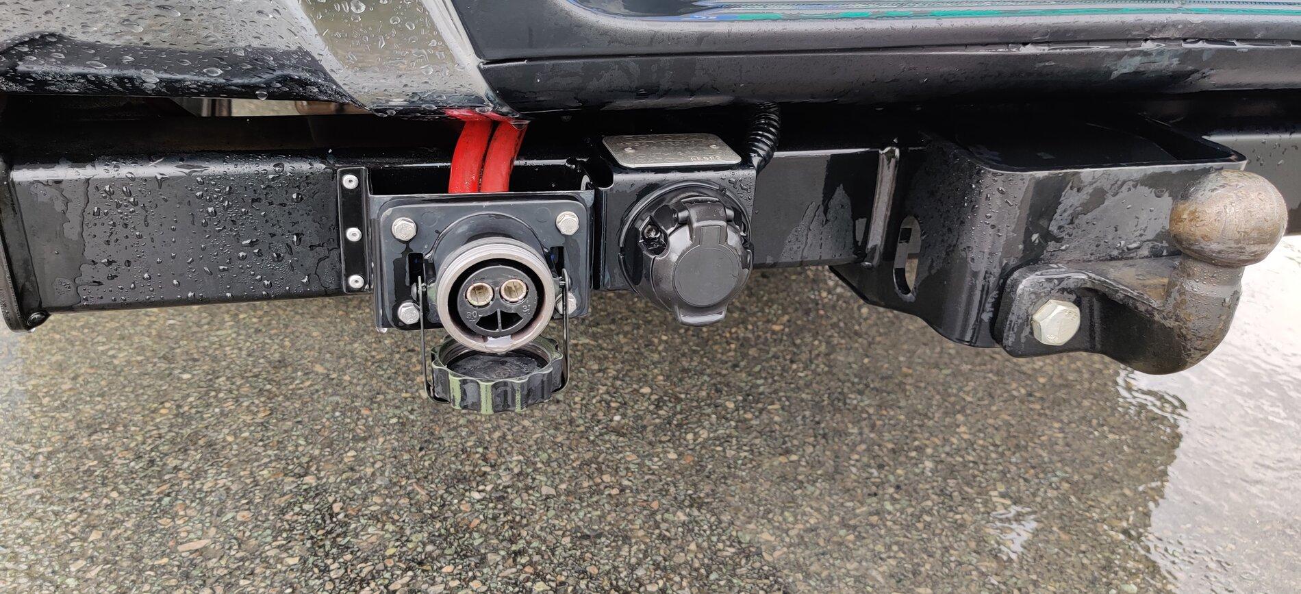

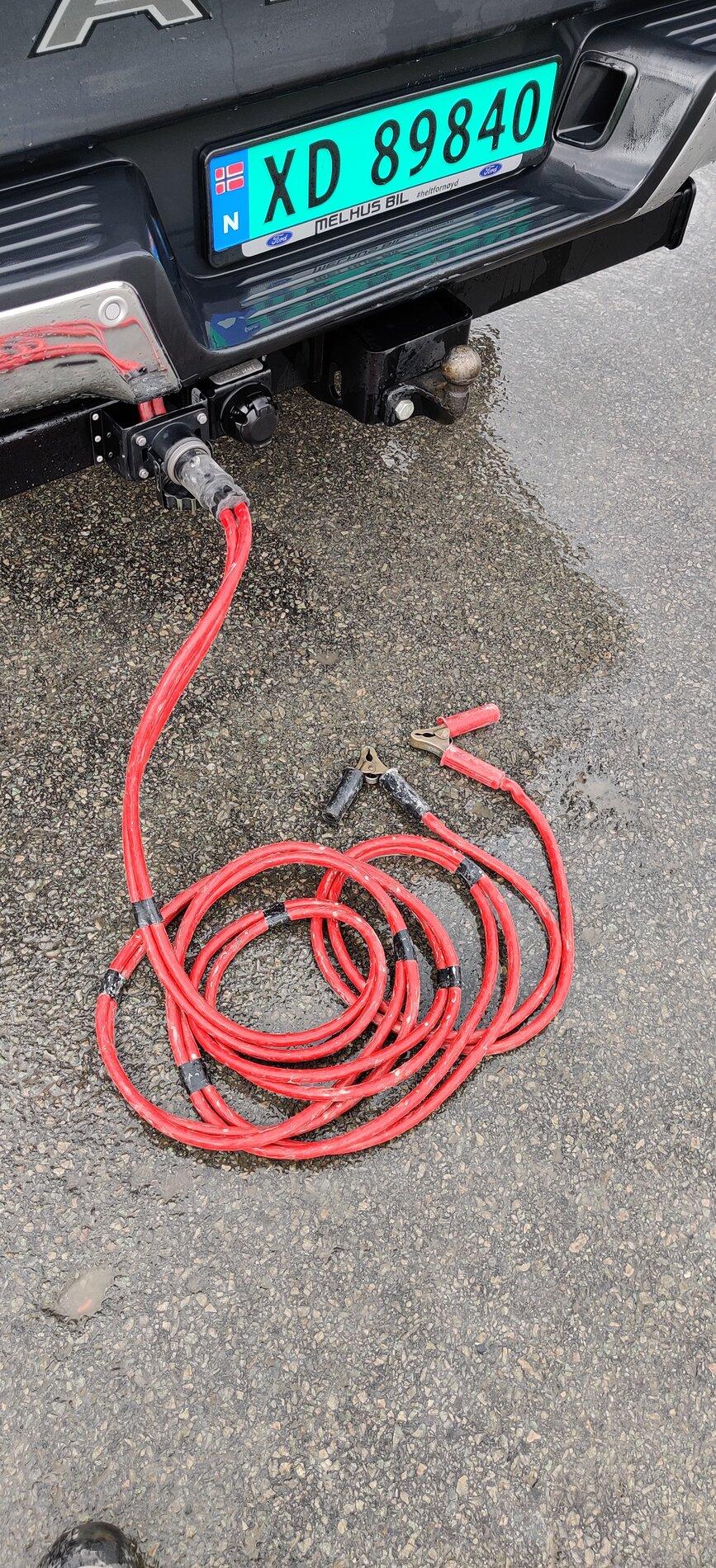

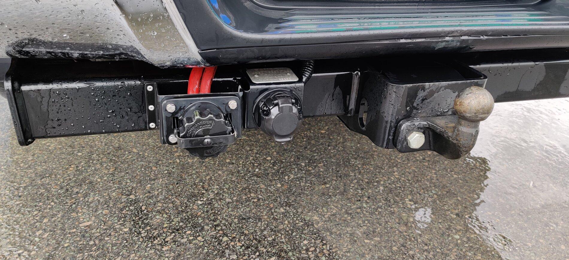

I dont think i have it posted here, but i have a NATO outlet by my taillights outlet, for startboosting other equipment. It is a 70 mm2 (2/0 AWG?) welding earth wire from the battery. Ill snap a picture and post it here. Works great really. I used to have a traditional booster in the back of the truck, but it had to be charged often, and if i forgot it it would be of no use for me.

Here is the "booster outlet" with approximately 5m (16ft) of cable to jumpstart MEWPs, excavators, forklifts etc.
