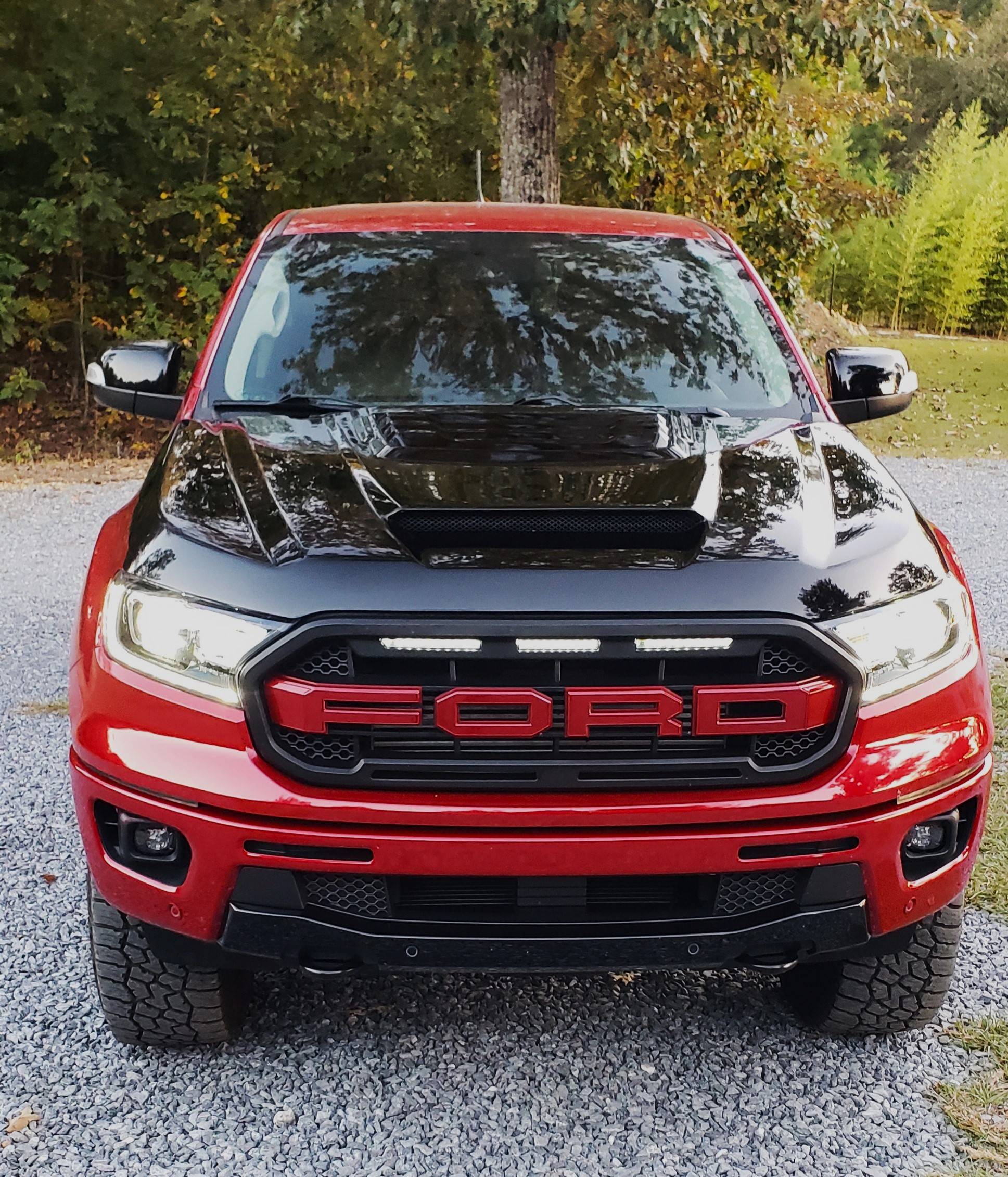

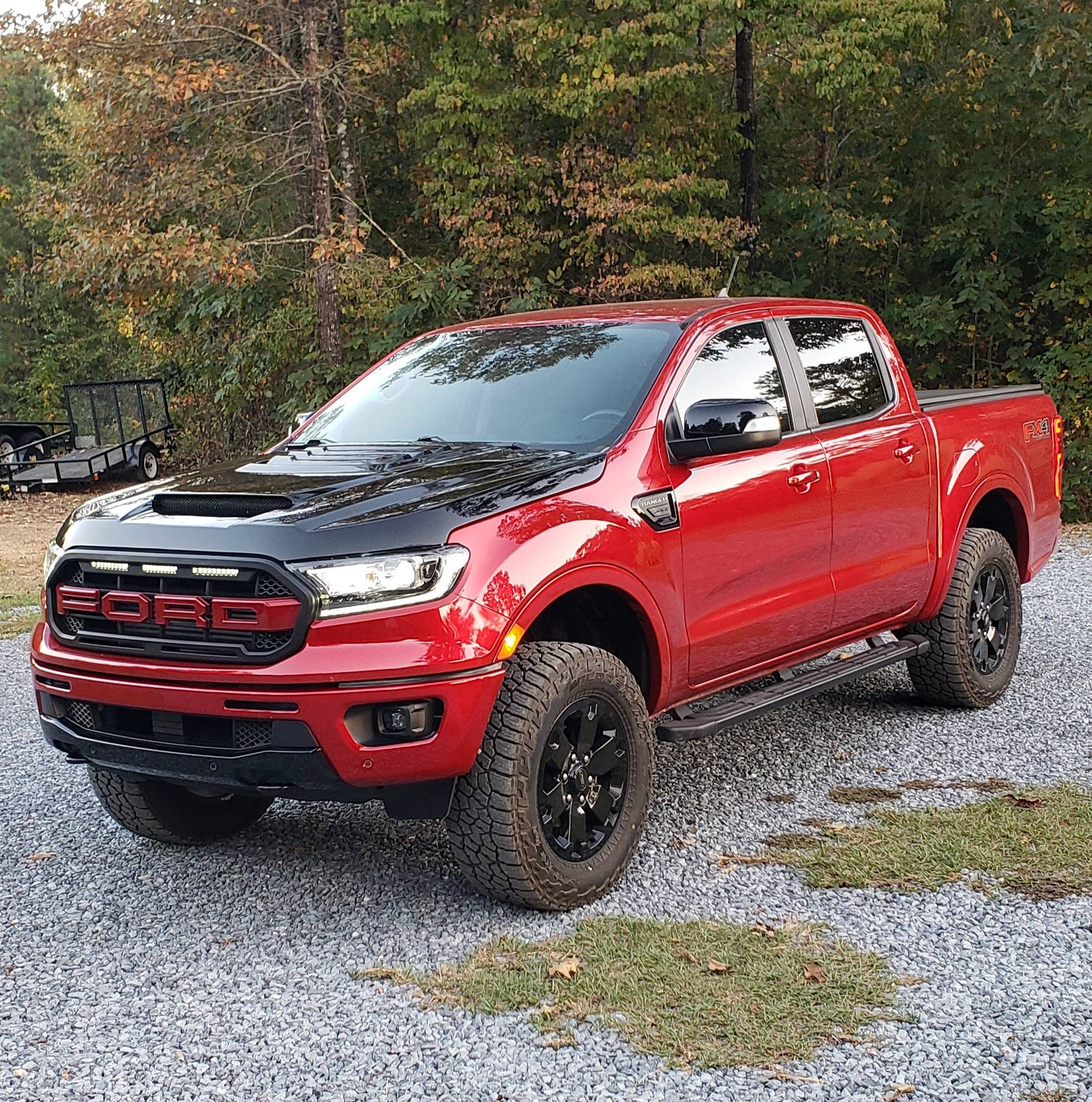

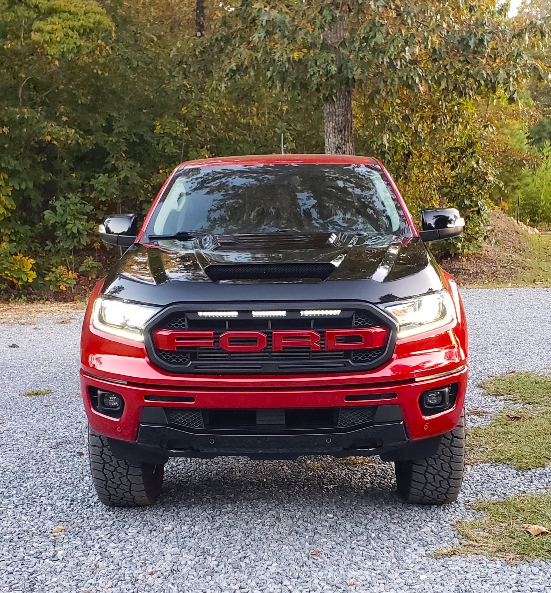

Needs a little more buffing out but my dang buffer stopped working . :(

Definitely puts the Ranger in Beast Mode! Looks awesome.
How are the gaps on the sides where the hood meets the fenders? From the pics they looked looked aligned and consistent, but the pics weren’t close ups so wanted to ask. Also, given your past experience, if you did match the body color instead of going with black do you think you’d also have to repaint the front fenders for a perfect match?

Yes the gaps are very good and I would have needed to blend the fenders to get a good match with the Rapid Red . I did not want to do that and not be able to put the factory hood back on at some future point .

Great on the alignment. Makes sense on the paint. Again, looks great.

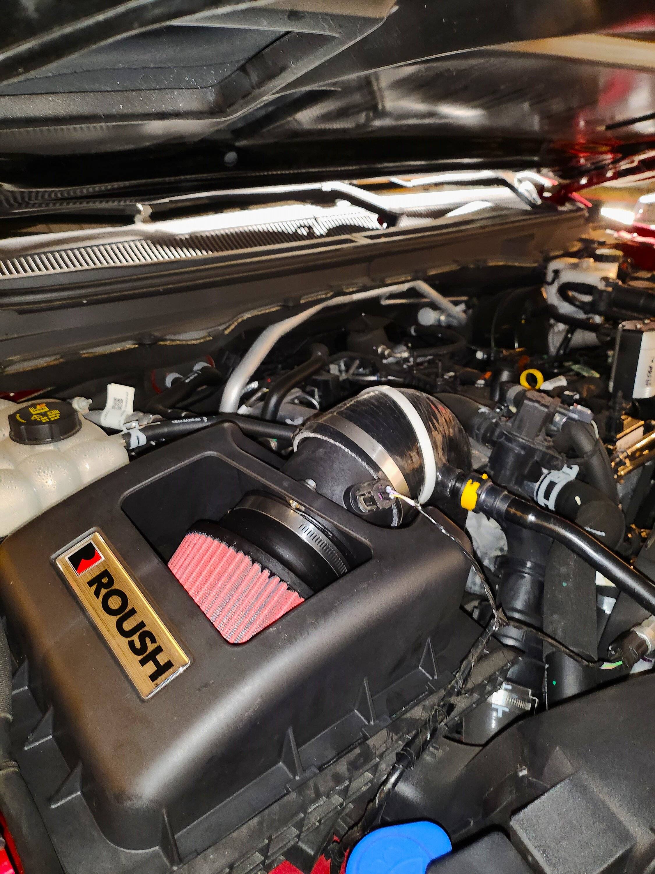

My Roush Cold Air Kit came in today from Hot Shot Offroad .
2.3L Ecoboost Cold Air Intake – Hotshot Offroad
I had it installed in about 30 minutes and it fits the hood cutout very well . I left the factory inlet that feeds air from the bottom and removed the plexiglass pc on the top of the Roush kit so the hood can feed air to the topside also. If you wanted true ramair you could close off the factory inlet and add some foam around the top cutout to seal it to the hood opening very easy .

Your ECU programming really can't take advantage of any extra air flow. With a CAI and exhaust you could figure that your Ranger is breathing 2x as good as a stock setup but the computer only allows for so much air flow. If you were custom tuned you could probably take advantage of more air. That would involve custom programming on a Dyno. I have a CAI and exhaust but my OTS Livernois tune doesn't have a variable air flow input control.
Our Rangers LOVE a low outside ambient air temp. That is what really gives me the extra boost to be honest with you....
