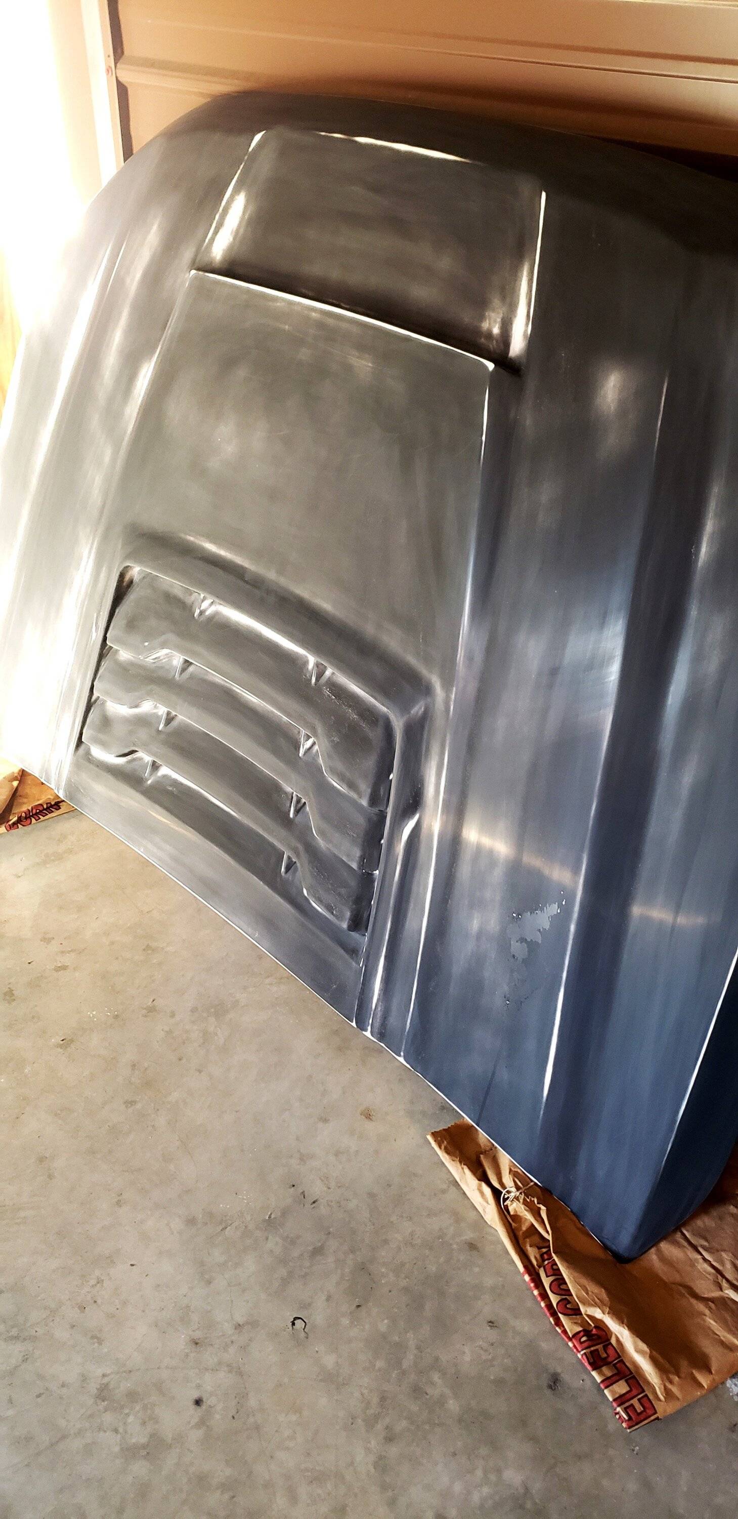

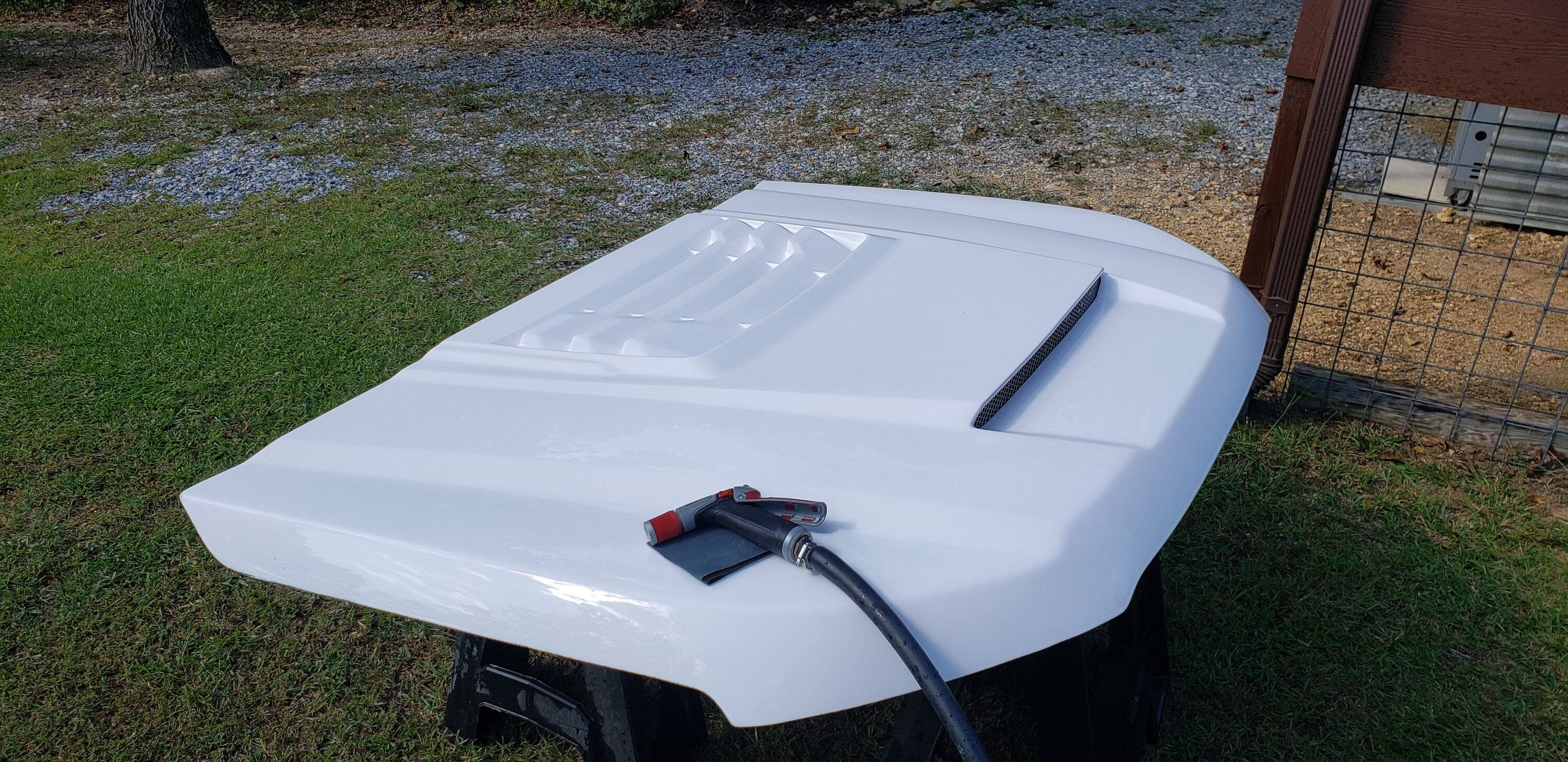

Sanded the hood with 180 grit yesterday and sprayed some black epoxy primer on both sides mainly to use as a guide coat . 320'd today and didn't find any pin holes or imperfections . This is a good hood . Hopefully I can get it painted sometime next week . I don't want to blend in the fenders to get a perfect match so I'm just going to spray it gloss black and see how it looks with the rest of the blackout pkg .

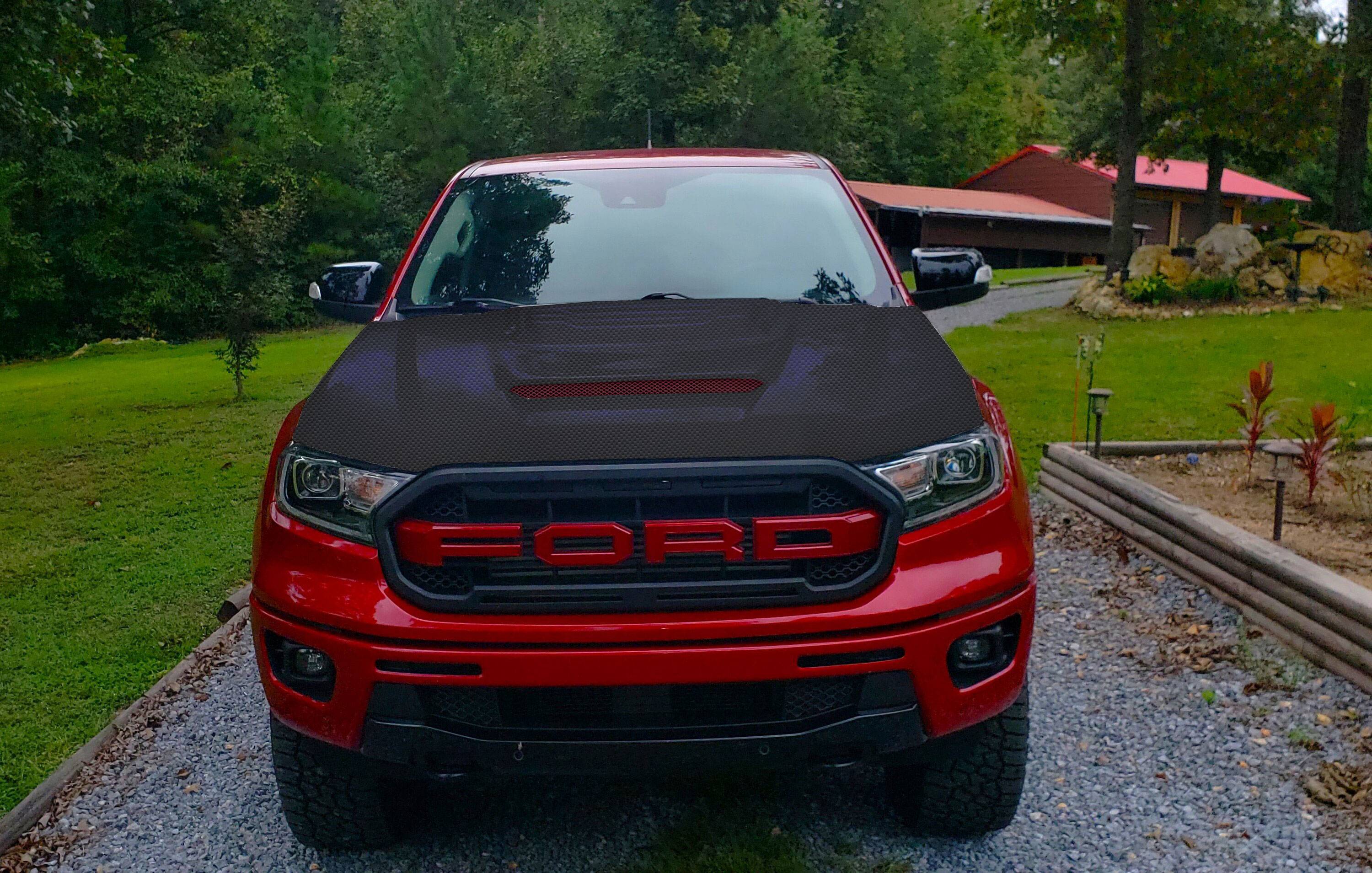

This might help give you an idea of what a carbon wrap would look like.

That's awesome ,lol .

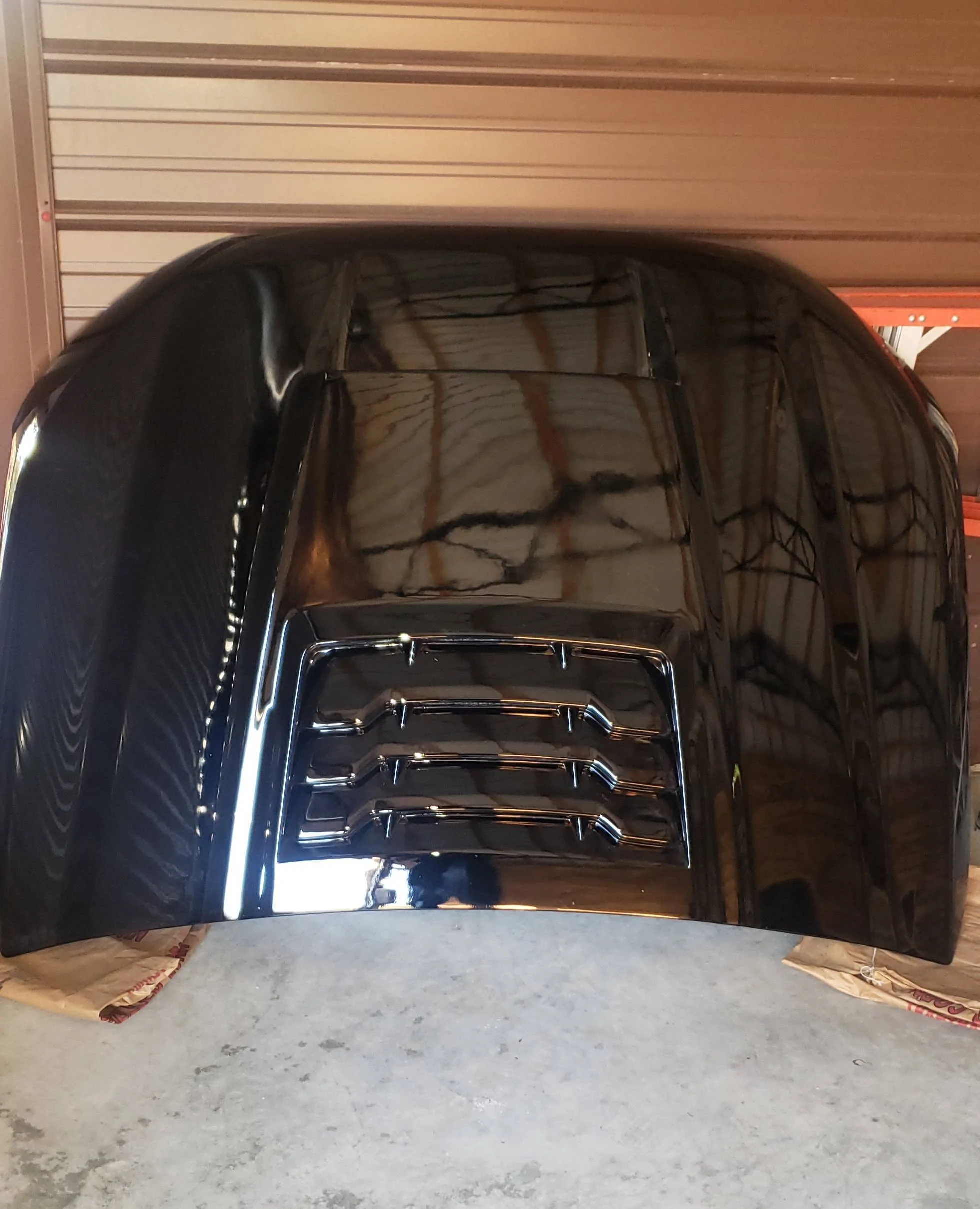

I have it painted gloss black . Gonna let it sit a couple days then buff it out and put it on the truck Friday maybe .

Needs a little more buffing out but my dang buffer stopped working . :(

Not to shabby!
That blows about the buffer thou!
