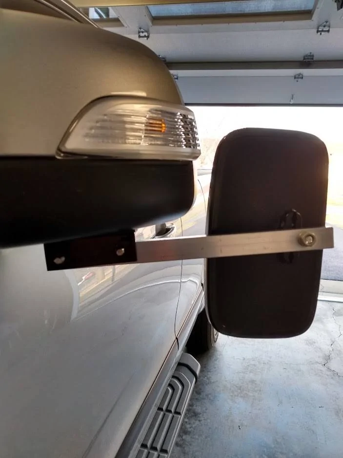

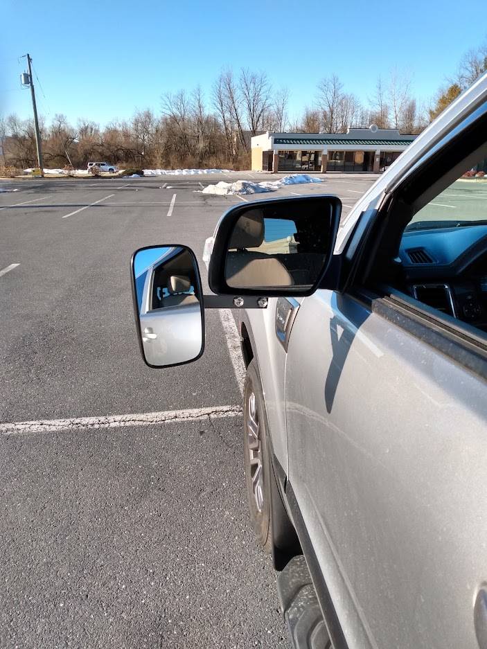

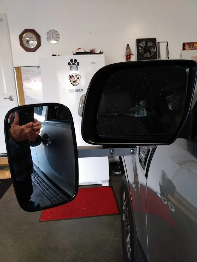

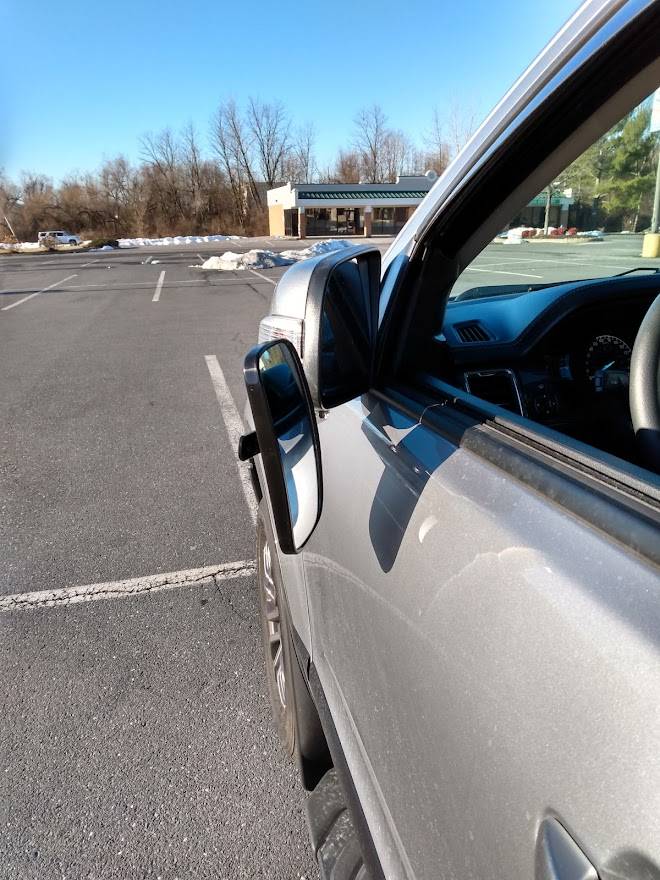

Took the Ranger out, and up to 80 on x-way. Ranger mirrors rock solid with no problem with them trying to "fold".
Got a bit of vibration at speed on the attached mirrors, I guess from using flat stock for the arms.
As suggested, went to Lowes and got a piece of 3/4 inch square stock and re-did the arms.
No vibration at all now.
Also, as shown, when mirrors are folded in, plenty of space between it and door/glass.
Total outlay was around $54.00 for two mirrors and square stock. Can take off or install both sides in a minute or so...
Now, if only my travel trailer would come in....
