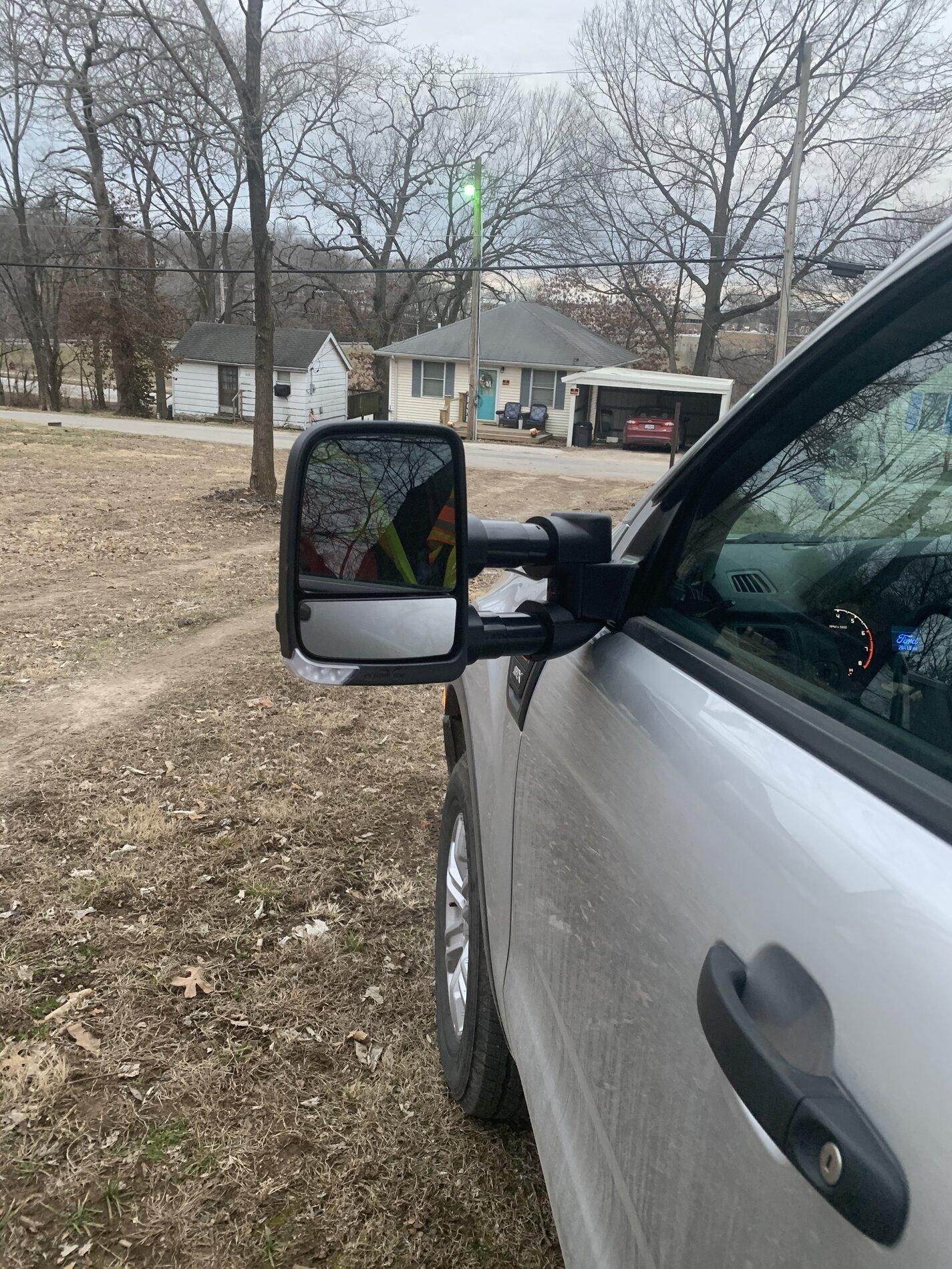

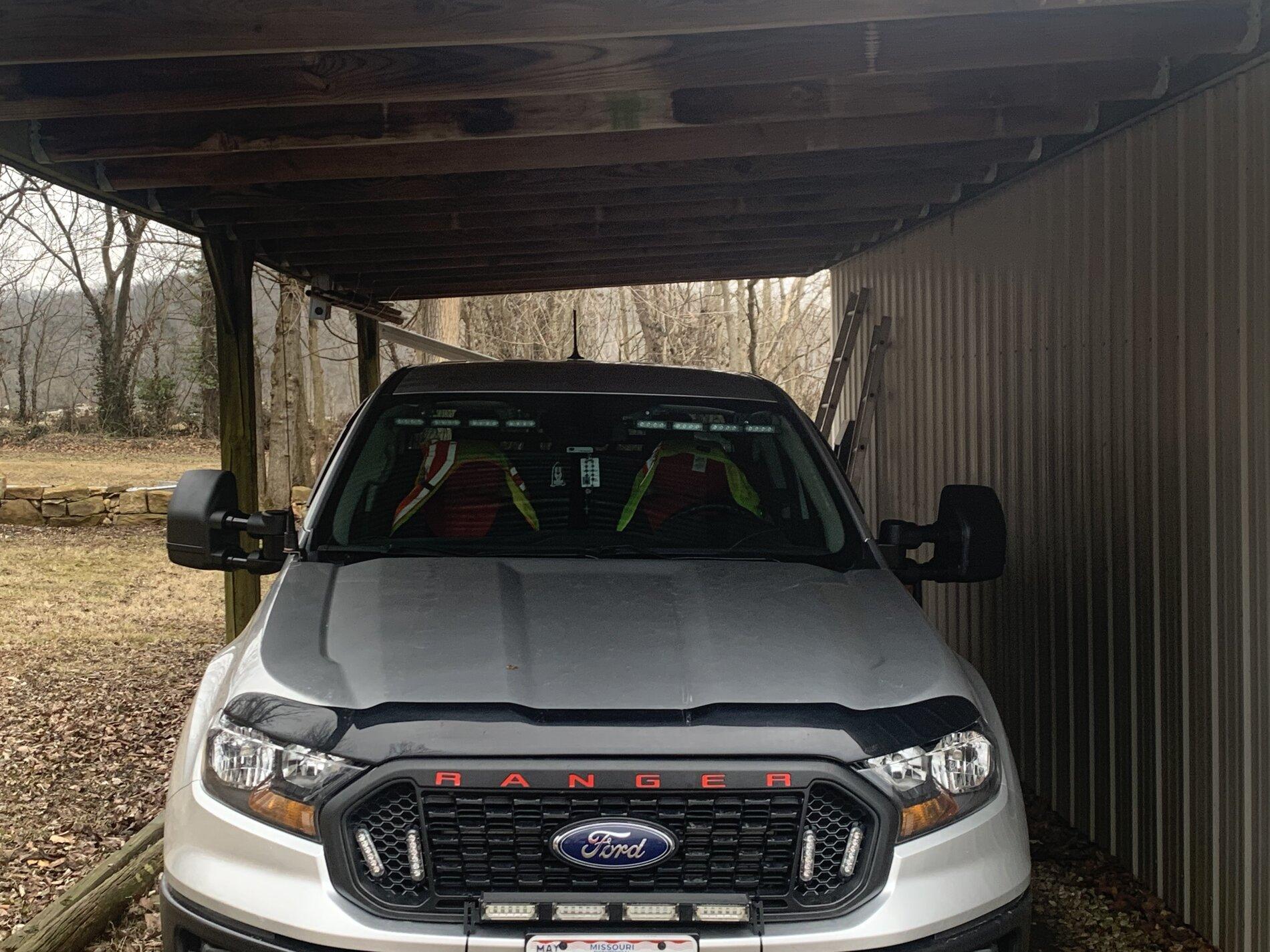

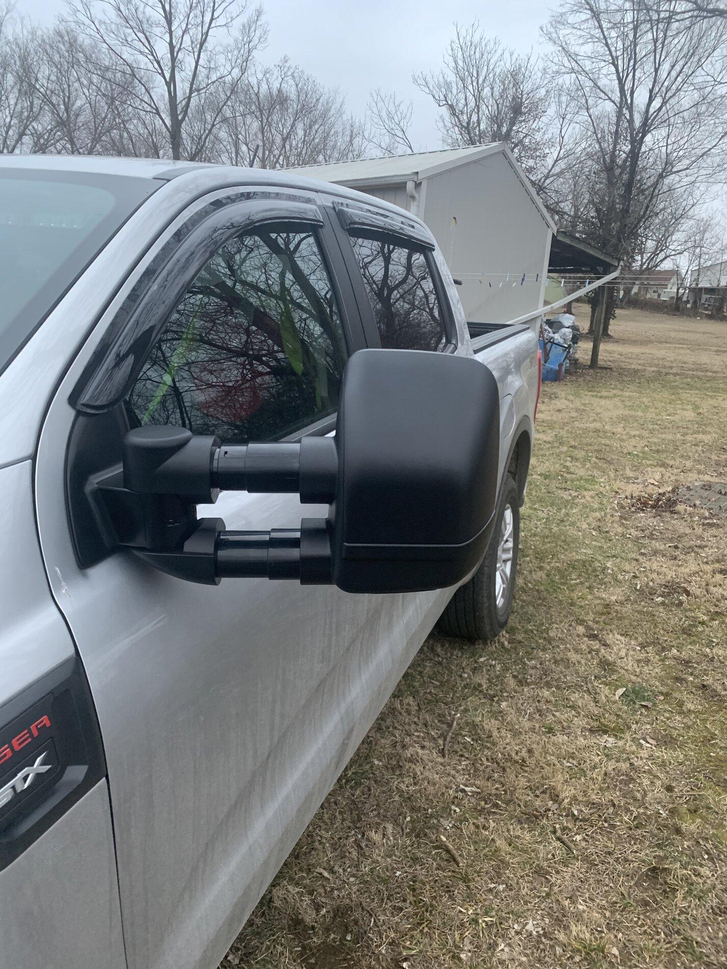

Got the tow mirrors similar to puddle jumper. Fitment is Great. Now I just got to figure out how to wire them in as the European Ranger plug is a touch smaller but basically the same setup. Not sure on wiring
