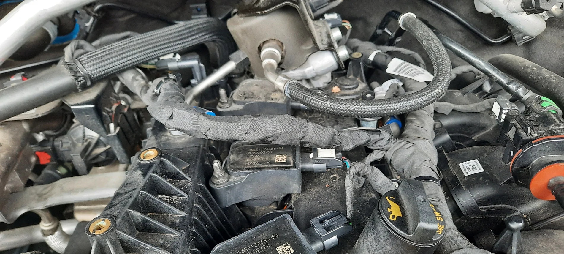

Finally
Got my truck back on Friday.

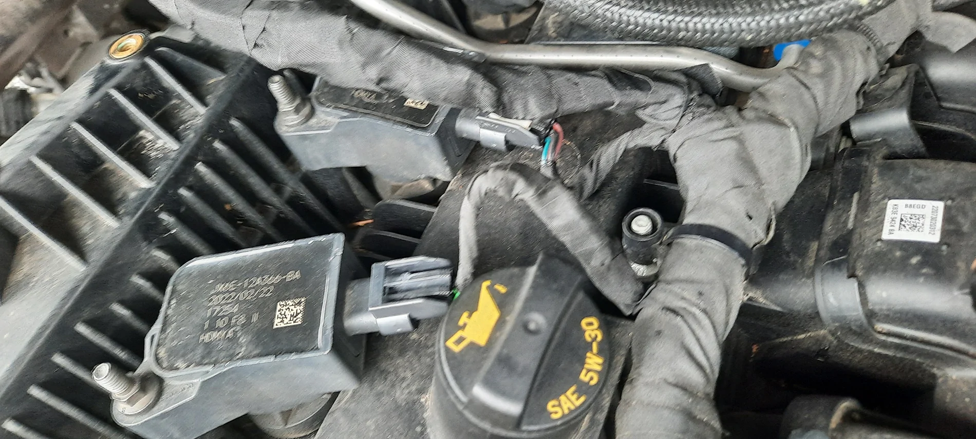

The dealer ended up doing an overlay for the cam sensor. Tells me they couldn't figure out where the break was in the harness or they didn't want to unwrap the tape from the damaged part and see which wire wasn't repaired correctly. The squirrel could of got the wire by coil #2 when she chewed that up and got really close to main trunk of the engine harness.
Noticed I'm missing the locking tab on coil 2 and coil 3 seems to have a nick in the black wire. I'll pick up some liquid electrical tape for nick as far as the locking tab maybe I'll just order a pig tail and steal it off of that.
Looking at the repair without pulling the Tesa tape off, it appears they used some type of crimp fittings vs the soldering that I was doing.
Total bill for the repair came out to $1270.00 plus car rental for about 10 days.
I ordered the bittering agent that was posted earlier in this thread. Hope I never have to deal with this crap again.
