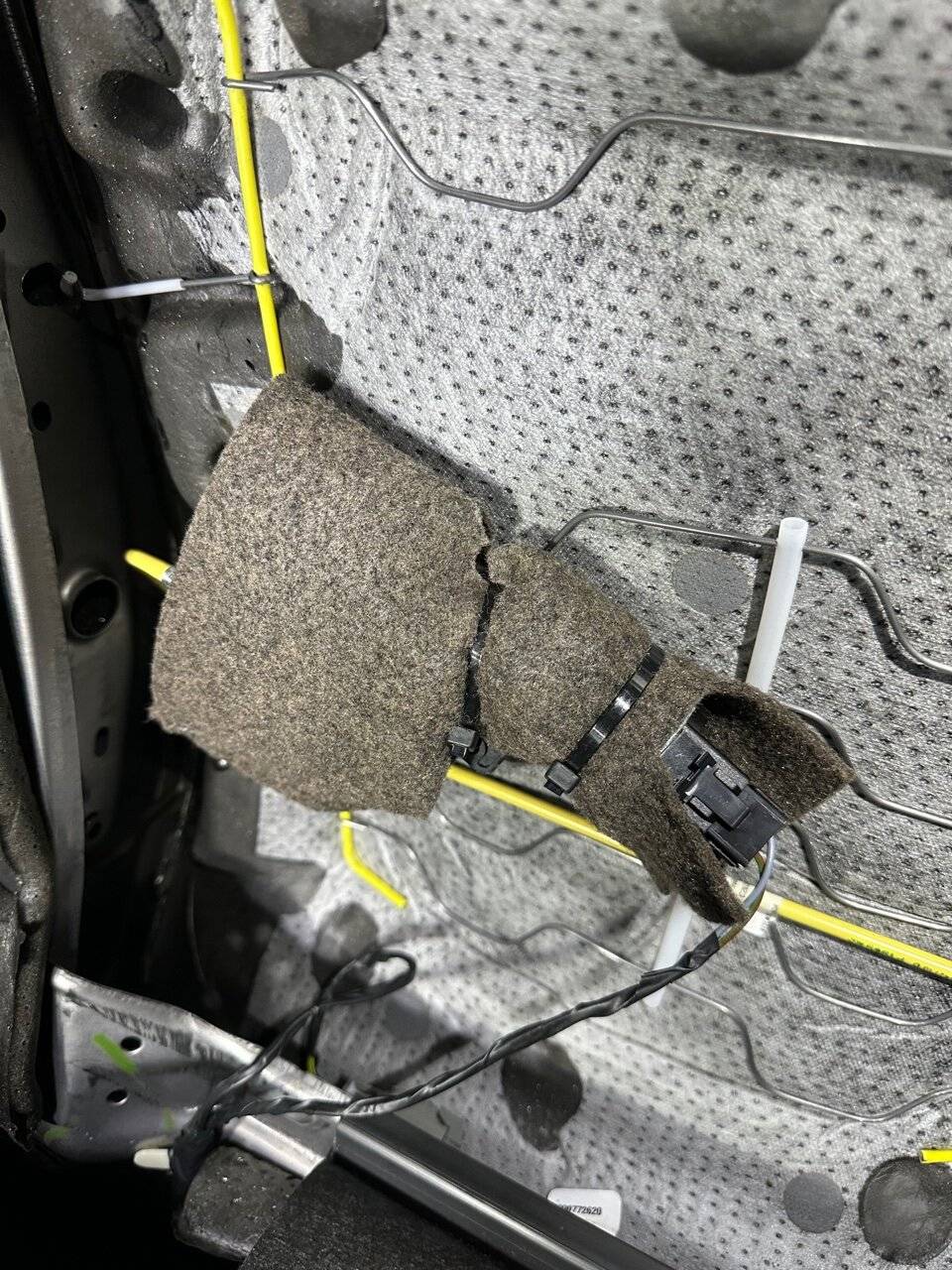

I've been dealing with a persistent rattle in my passenger seat. I had gone through all the threads and none of the causes applied. Not seat belt, not the base being loose (TSB), not a headrest spring.
Rattle occurred during engine start or standard driving when a passenger wasn't in the seat.
I had my daughter drive while I was in the back and was able to pinpoint the sound to the left side of the seat back about halfway down. Putting a little pressure on the seat back would stop it.
I pulled the seat cover up and was able to isolate it down to the lumbar support cable assembly.
If you decide to go into the seat, unhook your battery. There's an airbag in the right-hand side of the seat, and you'll need to unhook the connectors under the seat. You won't really be near it, but it's a good idea to disconnect power since you'll be working with the connector.

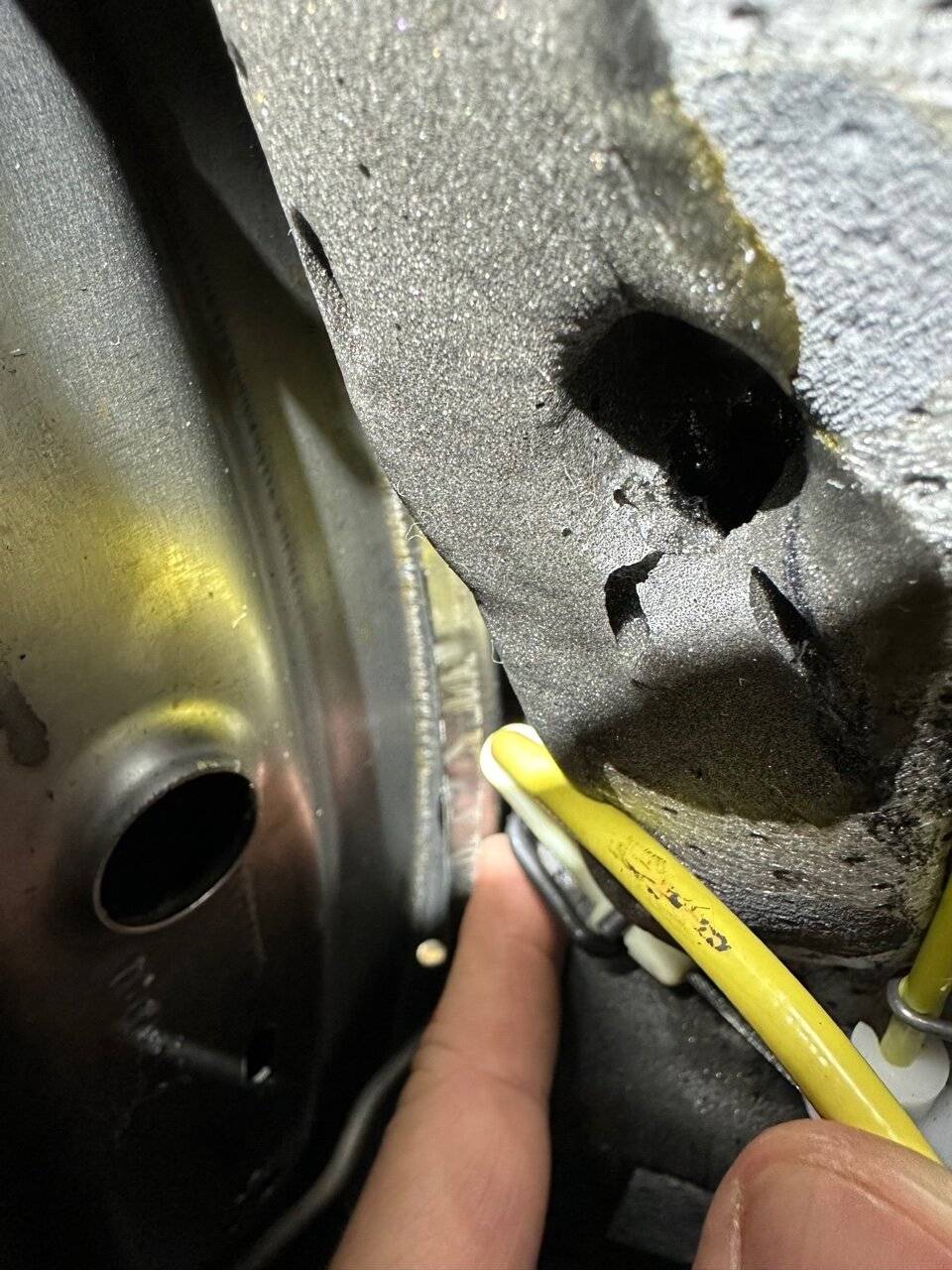

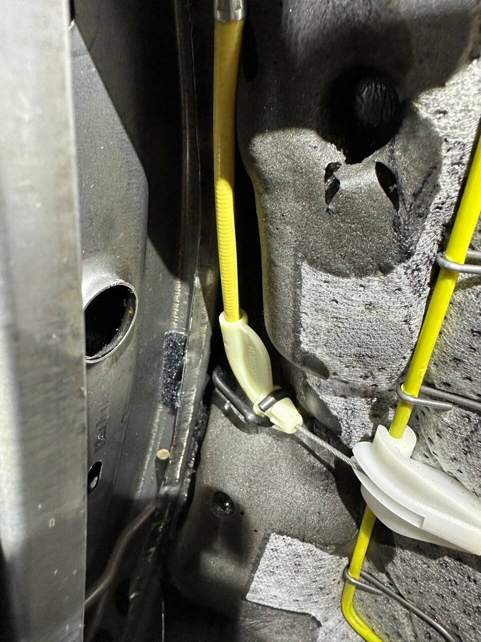

Where the tensioner cable attaches to the seat frame pivots, partly due to the loose attachment of the motor to the lumbar assembly with one zip tie. This pivoting makes a rattle noise.
I took some velcro (fuzzy side) and put it on both sides of where the metal bar hits the frame. Be very careful here. The frame is super sharp!
I reattached the motor using two zip ties.
The sound is now gone. I was about to lose my mind. One thing that occured to me is that I never adjusted the lumbar to see if the noise went away. I suggest trying that, and if it does, this might be the issue.
