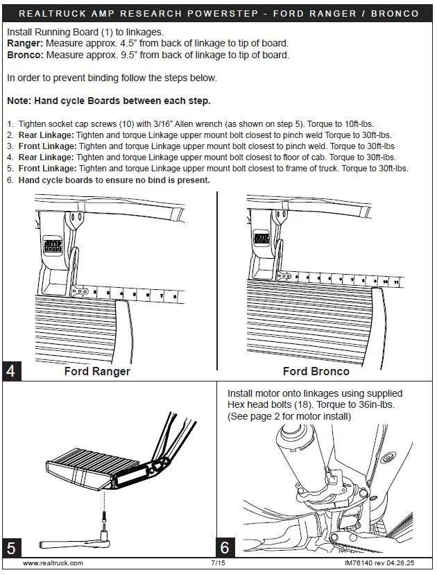

OK I found the new instructions i was referring to - 76140-01A
This is new for Bronco but also applies to our year Ranger
APPLICATION LENGTH MODEL YR PART #
Ford Ranger - Super Crew 72” 2019 - 2023 76140-01A
Ford Ranger - Super Cab 65” 2019 - 2023 76140-01A
Ford Bronco - 4 Door 72” 2021 - 2025 76140-01A
Ford Bronco - 2 Door 55” 2021 - 2025 76140-01A

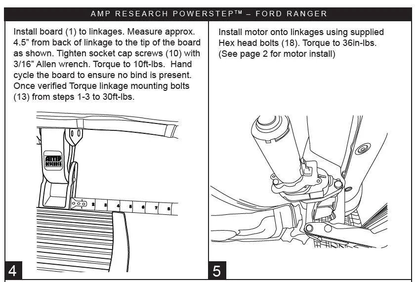

My Ranger steps are 76136-01A. linked to old install guide for comparison.
Not sure what changed hdw wise between that and 76140-01A.
BUT the step to align the brackets is more detailed on pg 7
went from this
to THIS
I have yet to try these out to see if they work any better. Don't really relish the idea of messing with the damn brackets again and as they are just clunky, pull up all the way, and on the passenger side - out of site out of mind.
