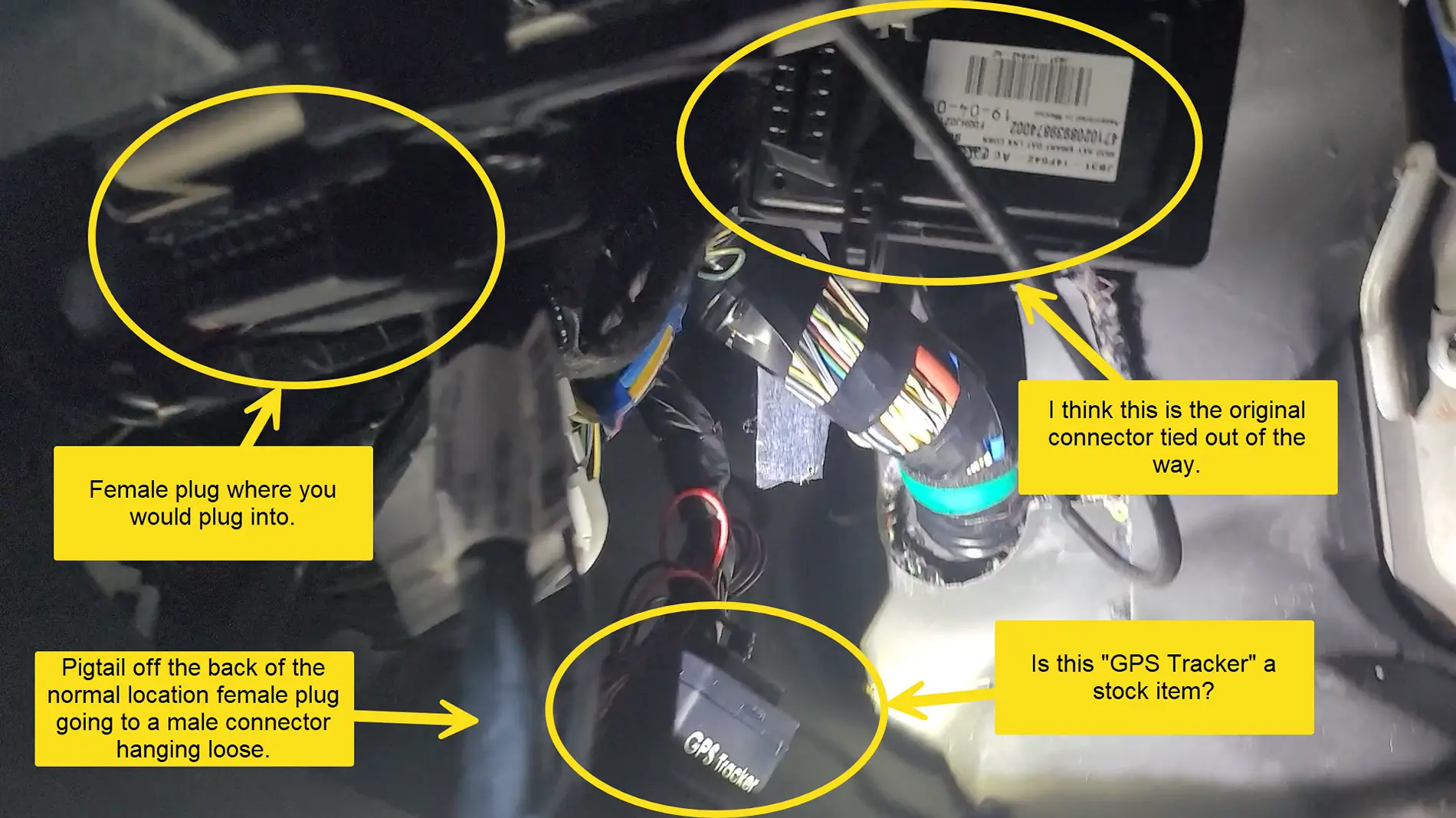

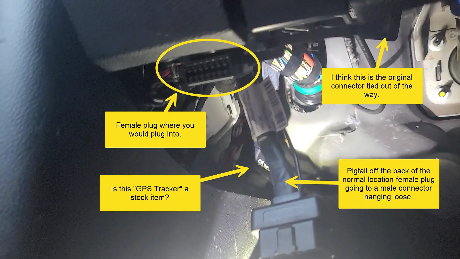

Hey everyone,
I was checking an engine code and noticed some extra wiring around the port that seems a little odd.
  • There’s an extra pig tail connection coming off the back of the the normal OBD port and it has an aftermarket label.
  • A small box labeled “GPS Tracker” mounted nearby.
  • Another plug that’s tied up, and it looks like it could be the factory part that was moved?
I have uploaded some pics and tried to label the items. It is a screenshot from a video i made but it looks like the video is too large to attach. I’m just trying to understand what each of these components is — whether it’s something factory, dealer-installed, or aftermarket.
Any insight or experience with this kind of setup would be really appreciated.
(If this isn’t the right section, I’m happy for a mod to move it.)
Thanks!

The OE connector is the Gateway Module (GWM) the front on the GWM is the OBD port- remove the T-Harness and extra SPY crap- plug the OE harness back into the back of the GWM and then remount the GWM to the OE location.
No it’s not factory, it’s a dealer or seller add on, to aid in repossession recovery
