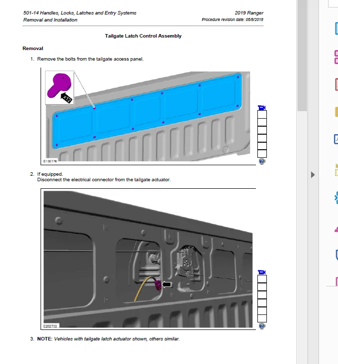

You’re pressing the unlock button twice right? If you are then try putting pressure on the tailgate in a closed position and try the double unlock. See if that doesn’t do it. Once you do get it open might need some lubricant on the sliding latches on both sides. Let us know how that goes

might have to open up the access panel and have a lookie see
Thanks for the helpful and quick response. I opened up the back as you showed and determined it was the latch, not the lock. I was then able to get the tailgate open and seem to have it working correctly now.
Thanks. I figured out it was not a lock but a latch problem and pushing on the gate from the inside while pulling the release got it unstuck. Appreciate the help.
