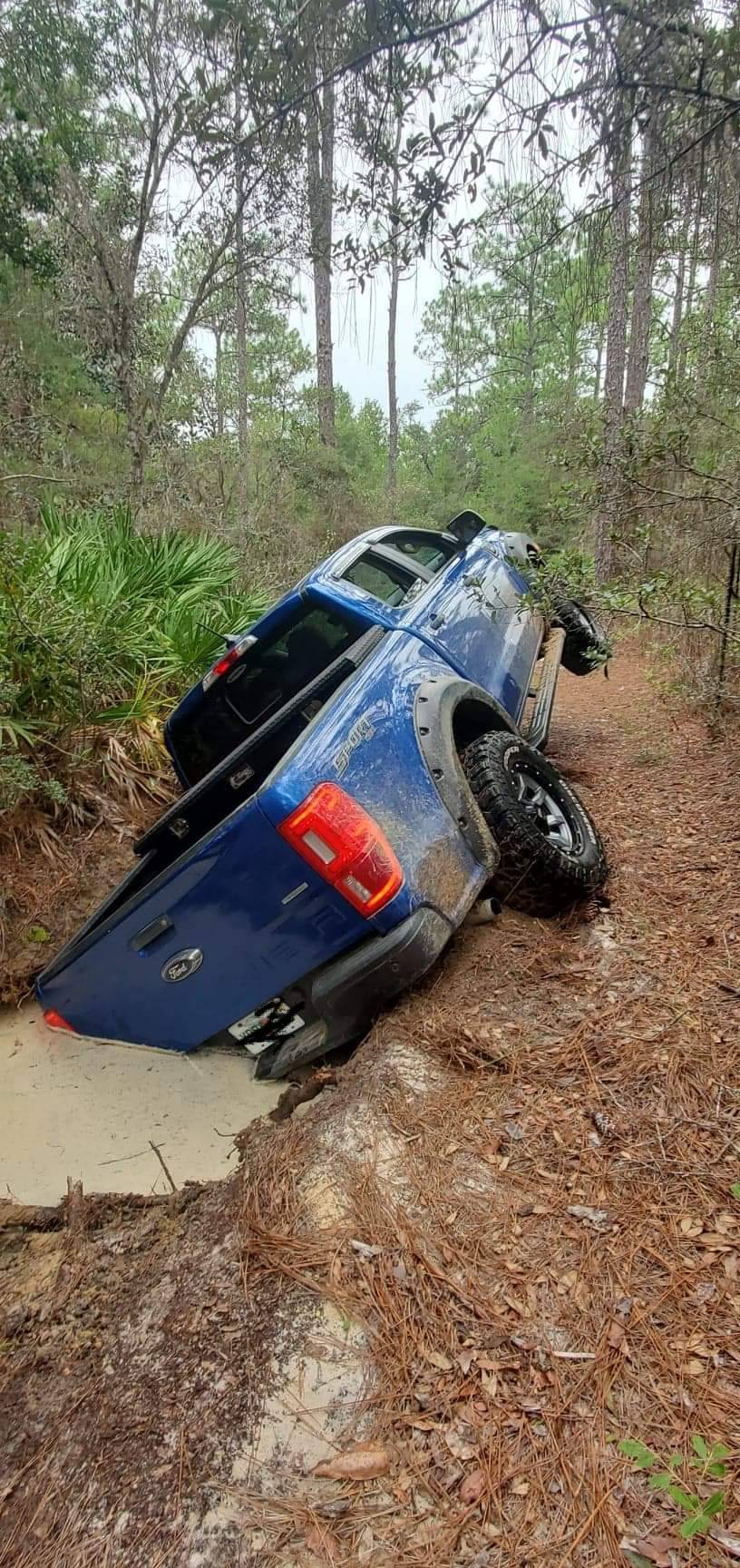

Nope, not even from this monster flex position. I'm running a slightly larger tire than you @ 295/70/17 with a -12 offset wheel. I'm off road just about every other weekend. I wonder if you picked up some debris that created your impact? I do get the occasional kick up of larger sticks, branches and large rocks when I'm out and about.

ok, i gotta ask...i'm no hard core off roader or anything like that....but why would you go into that hole instead of around it?
Clout?
balls bigger than apples?
because it was there?
I want to willfully damage my truck?
I'm stupid?
I didnt see it?
didnt look that deep?
wasnt my truck?
I'm from Florida, its expected?
My offroad experience isnt complete unless i get stuck at least once?
Here, hold me beer?
sink hole, came out of nowhere?
the Tacoma did it, i wanted to show him I could do it better?
girlfriend distracted me?
Lol, wasn't intentional. I was off road with my adult son's in a caravan of their trucks. Nissan frontier 4x4 and my old tacoma 4x4. I was the lead truck and we were on a single pig trail road that had some water in the ruts from a recent hurricane that came through a few days before. When I entered the front end went in just fine however, when the rear entered, the hole gave way and this is how I ended up. At the time what I didn't know that the hole had a massive set up pine tree roots that supported the front of the truck. The roots had all the dirt blown out from under it and they broke just at the rear of the Ranger settled in. Talk about cleaning your shorts out! That was a moment for sure. I just got caught being lazy and not checking the hole that was filled with water first. I've been down this trail many times over the years but this was the first. Live and learn, lol. But your right I do have massive balls and I'm not ashamed of putting them on display.... Bawaaaa

My apologies Charly, Mr Pride and I didn't mean to hijack your thread, lol. But yeah I doubt that your rubbing the tires back there doing donuts in the mud. Post up some pics so we can see what your talking about. Some of us may have seen this before?

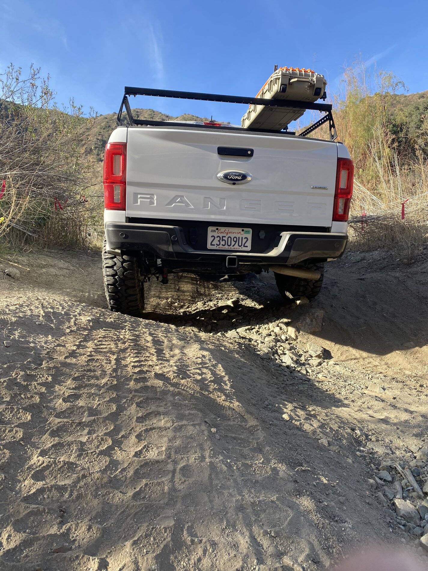

I should probably measure the distances from top of tire to the top of the fender arch; bump stop to leaf pack. They are much more flexible than stock even at the level 2 configuration. Great ride.

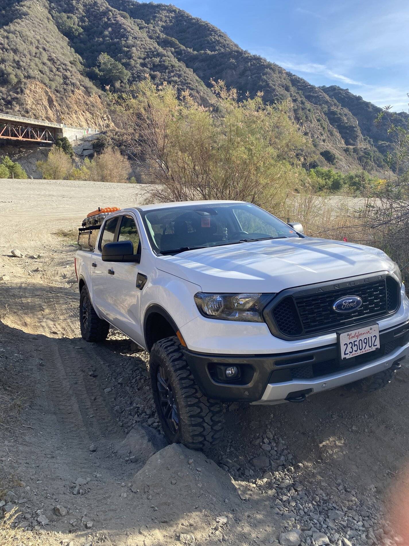

judging off the first picture the tires would likely tuck up in the fender before making any kind of contact with the magnetic grey trim.

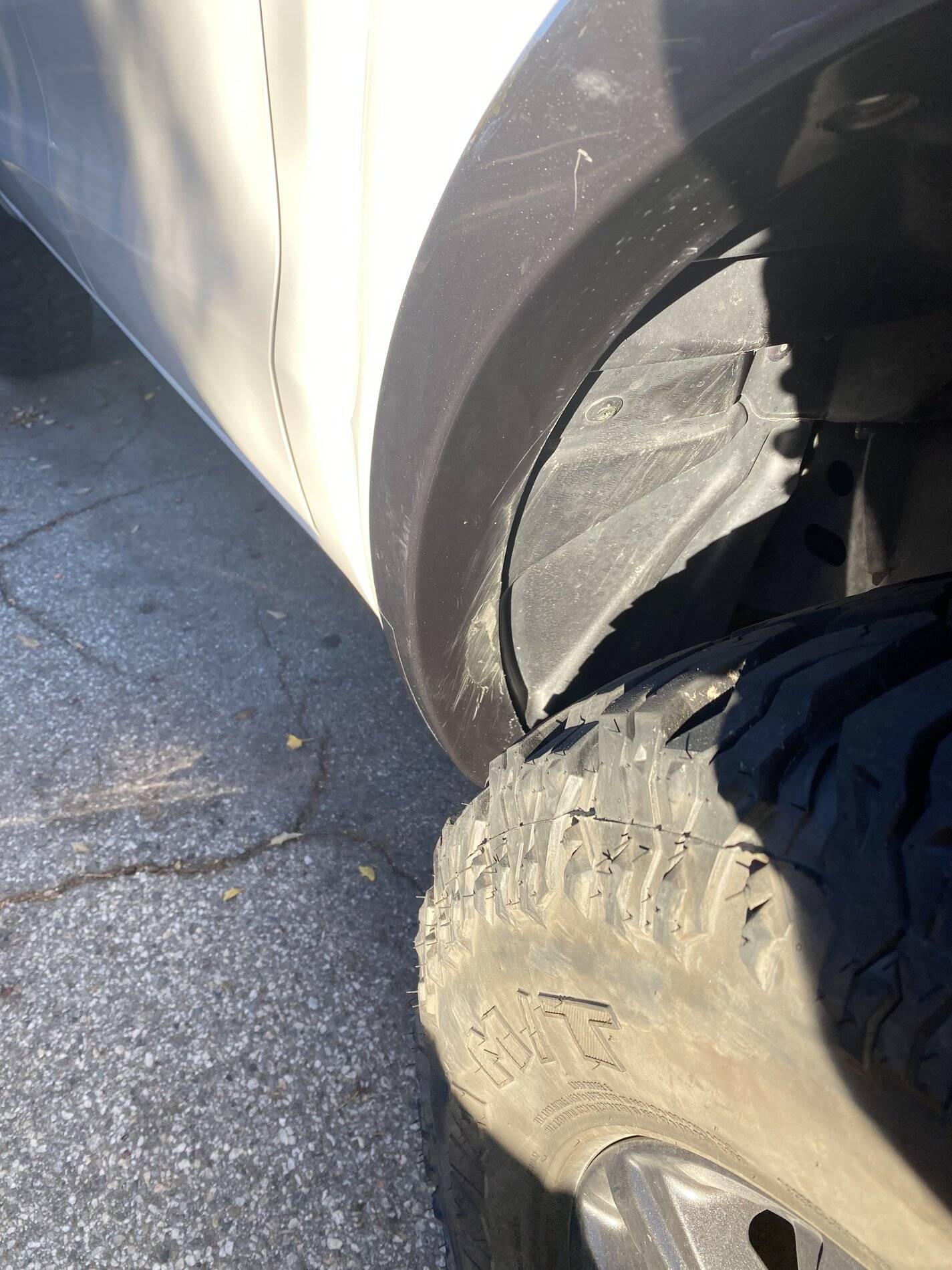

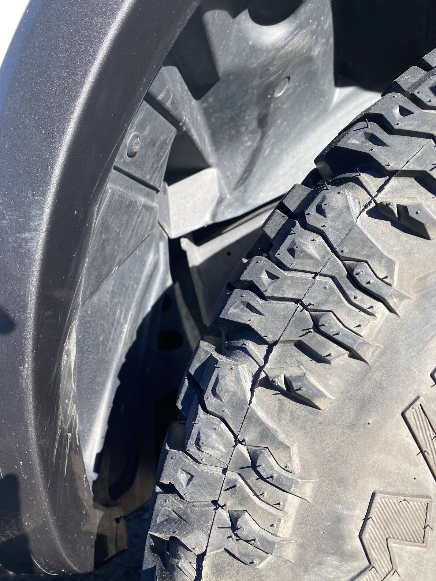

So looks like the rubbing happened closer to the front of the arch. I went out to take some pictures and noticed there are signs of rubbing on the black plastic wheel well liner. I checked the other side and sure enough I rubbed there too! Time for a 1” block lift?
