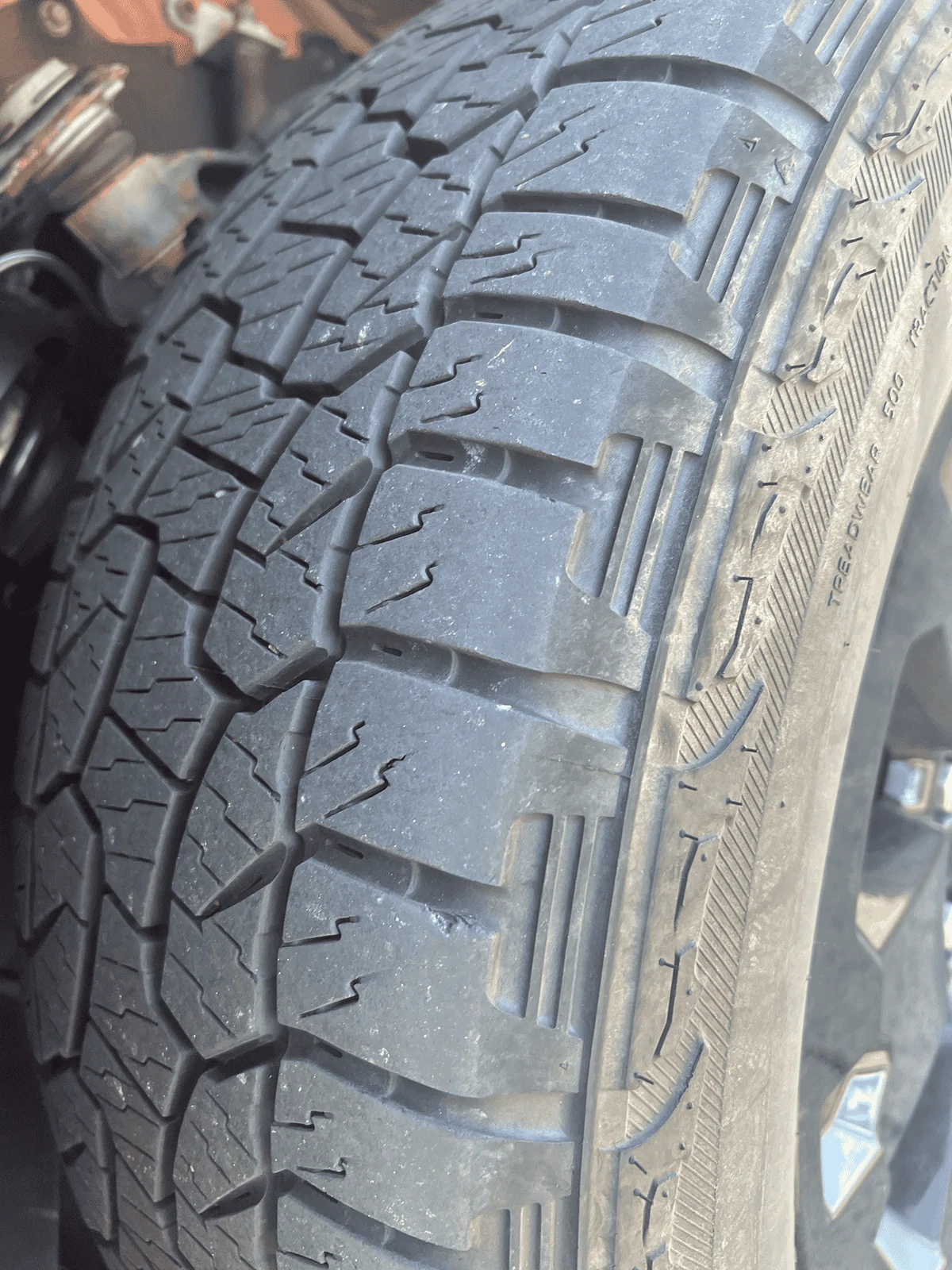

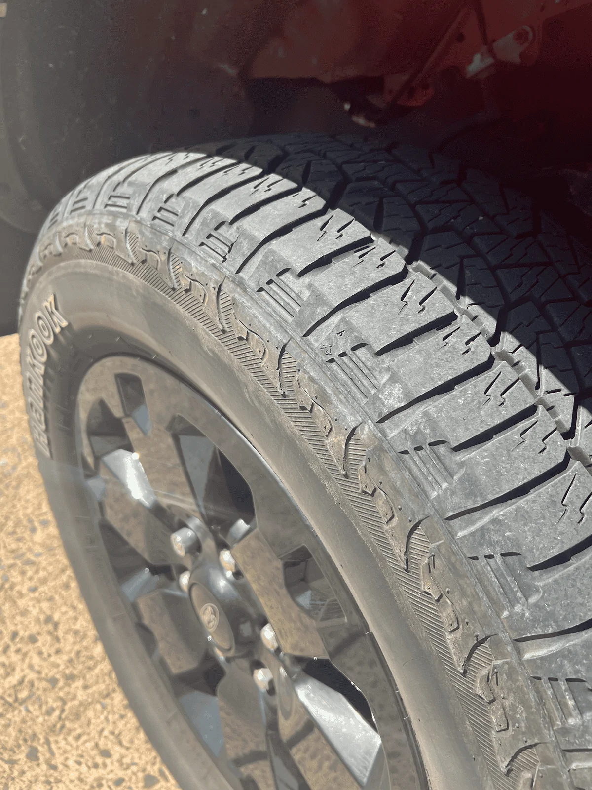

All rangers are 30 PSI….
He said he’s running 33…
those Dynapro’s are not as deep on the outside as they are in the middle.. so when the tires wear down a bit they appear to have less tread than the middle which they actually do…
They do this for stabilization of the outer tread blocks to prevent abnormal wear because of cornering. This is why almost every factory truck tires has a solid outer tread rib. Like the Bridgstone Dueler that comes on other Rangers.

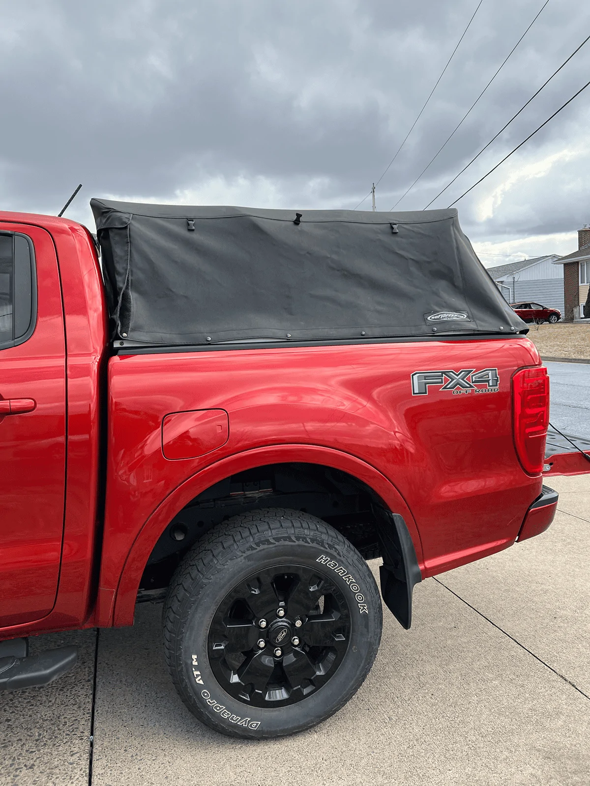

I bought a '22 Ranger Lariat FX4 about a month ago with the original Hankook tires. The tires have 42K km (26K mi) They don't "feel" like great tires, especially off road and in snow (I'll get proper winter tires next year). Do they appear to be wearing a normal rate? It seems like they're OK in the middle but around the sides they look to me like they're wearing quickly.
If I decide to replace them, any suggestions for a capable off road tire? I want to be able to pull my trailer down logging roads that can be a bit sketchy.

Look pretty darn good for 42k on OE tires and I worked in a tire shop for 15 years.
Maybe the original owner put winter tires on during the winter months. Sounds like they're in good shape though and no need to replace for now.

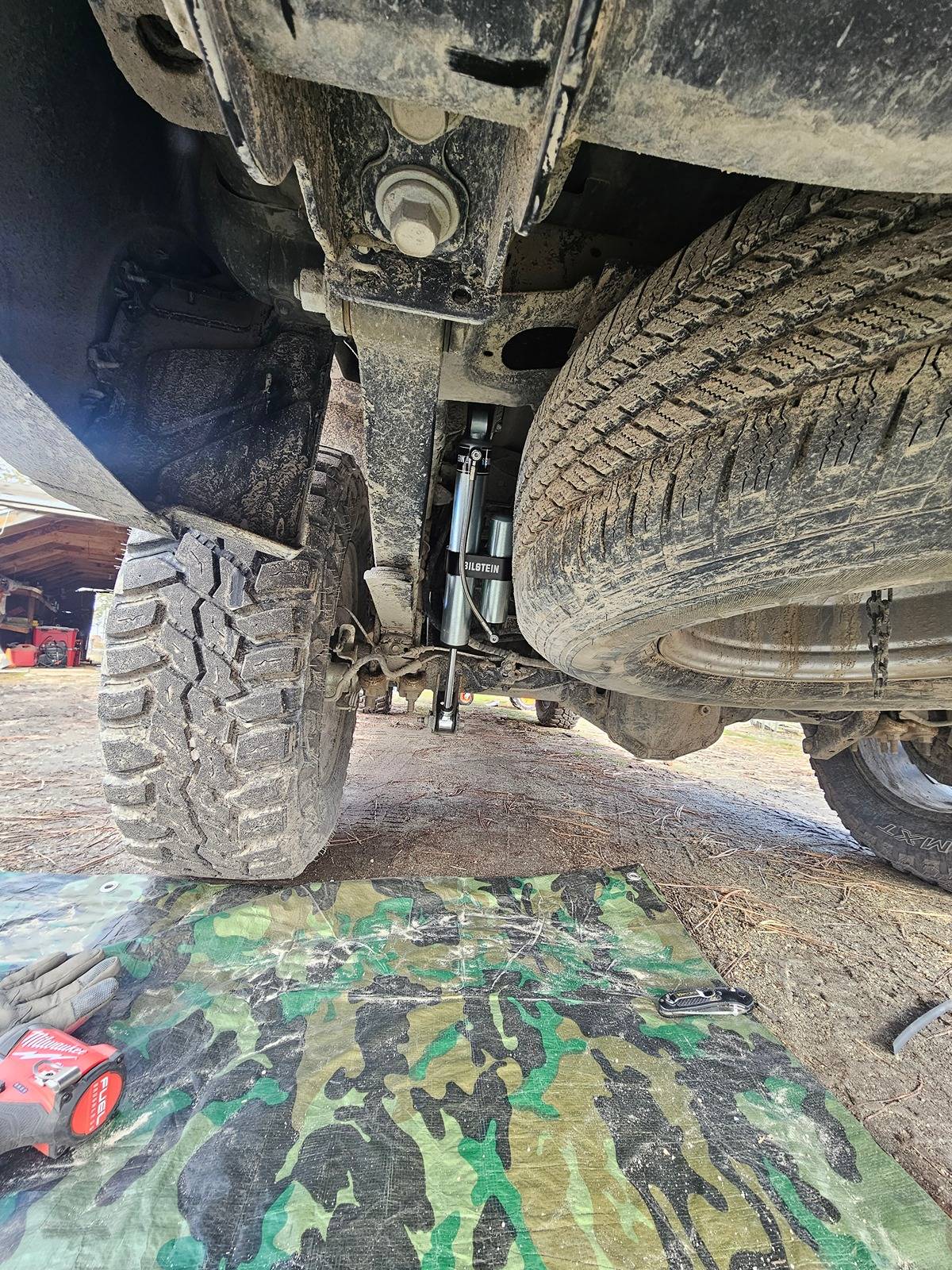

My recommendation- Mastercraft Courser MXT I got these in 265 70 r17 on stock sport rims at stock height. No issues or rubbing. 2inch level now and no issues. Almost 8k on them now. Load E. Noisy for sure but I live up a 3 mile dirt road and we get snow, mud washboards, moon dust and this cuts through it all. Pics are with 2 inch front level.
