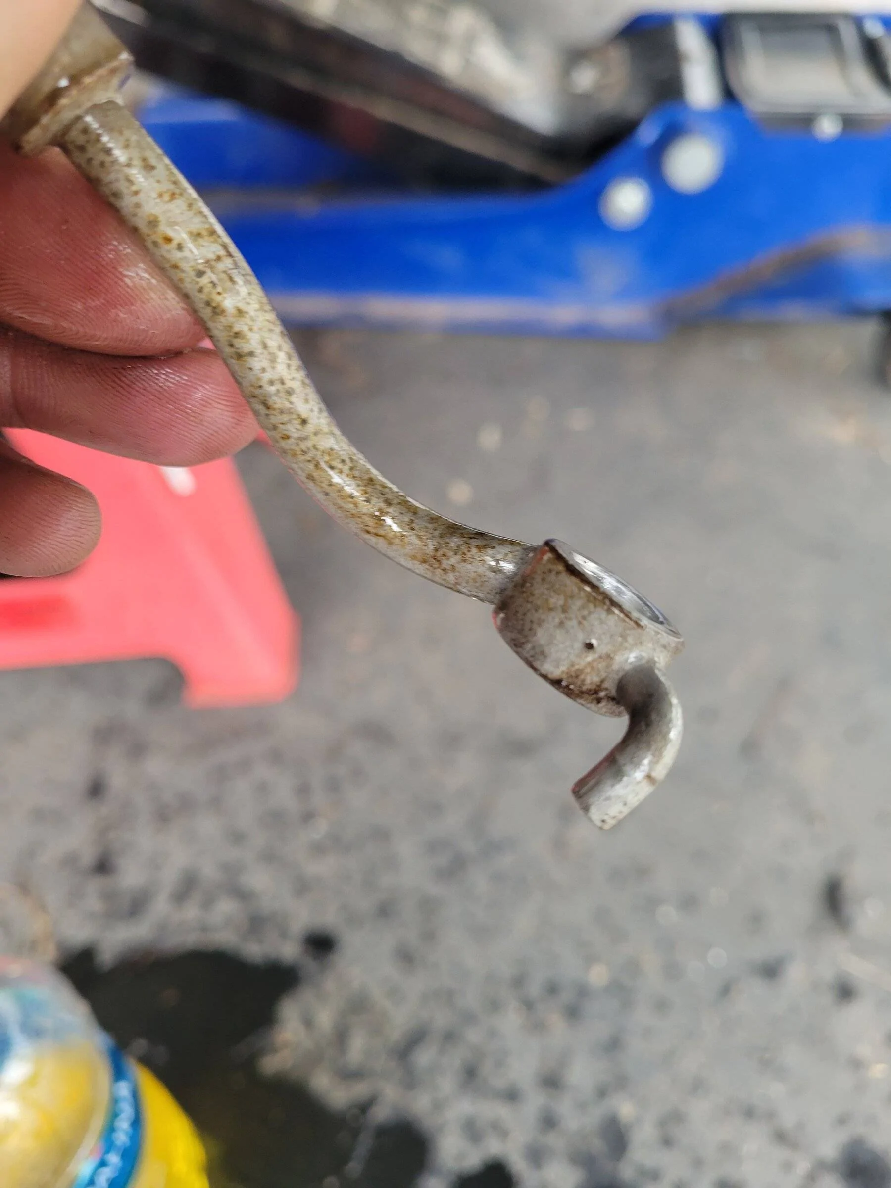

I will know for sure when the new brake fluid comes in (today) and I remove the bolt and brake line. My thought though is to use my tube bender (made for copper tubing, I work in HVAC/Refrigeration) to bend the metal tube. Then tighten the bolt with the tube perpendicular to the ground.

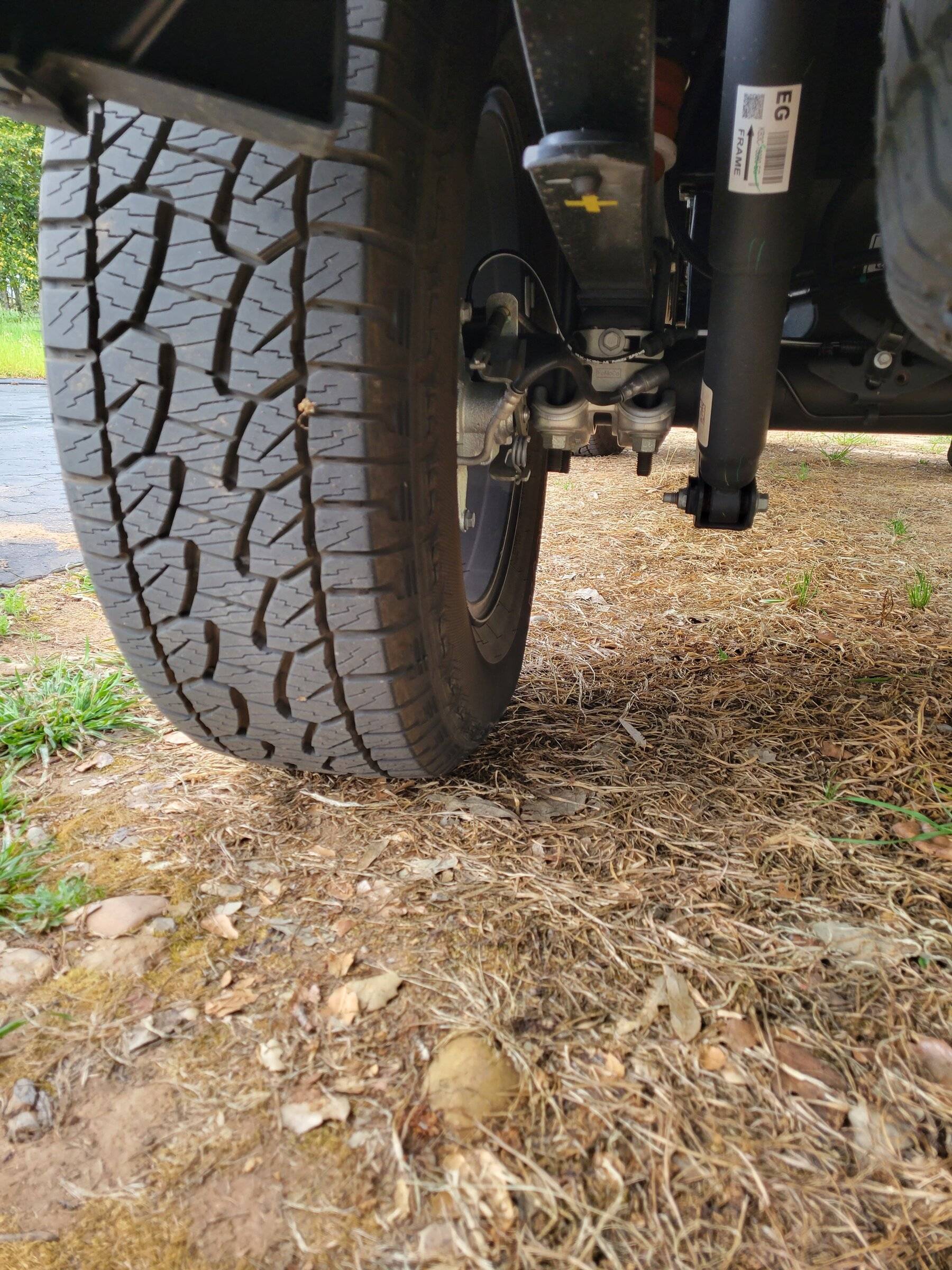

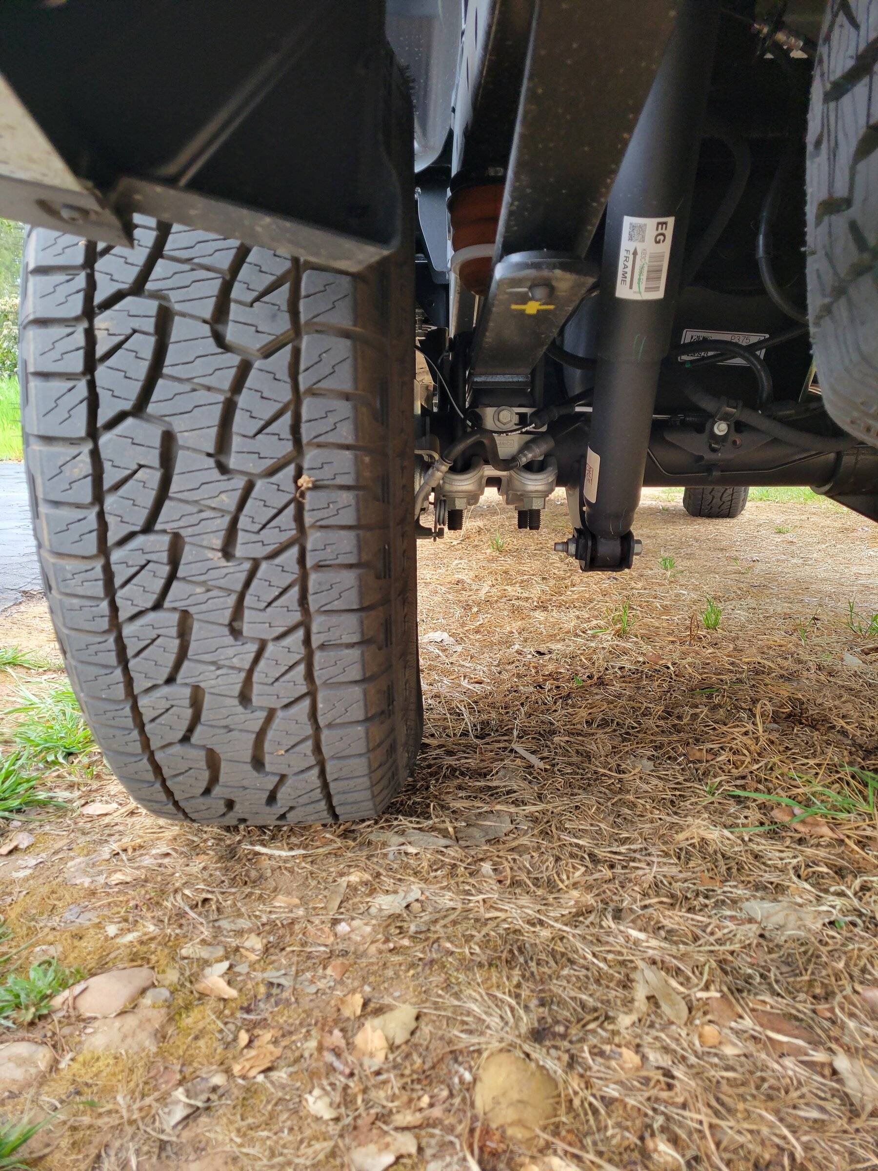

Also, I was curious how much diffence was made by having negative offset wheels. We have an unmodified ranger at the house, so I took some pictures. Although it looks like the issue could still happen with factory wheels, it would be MUCH less likely because the wheel covers the section that runs parallel to the ground. See below:
Just from the pictures you took I can tell that without changing the tire and wheel offset there wonr be an issue. Again I ran the factory pffset with bigger tires and a lift and went Offroad plenty. Never had an issue with that being hit.

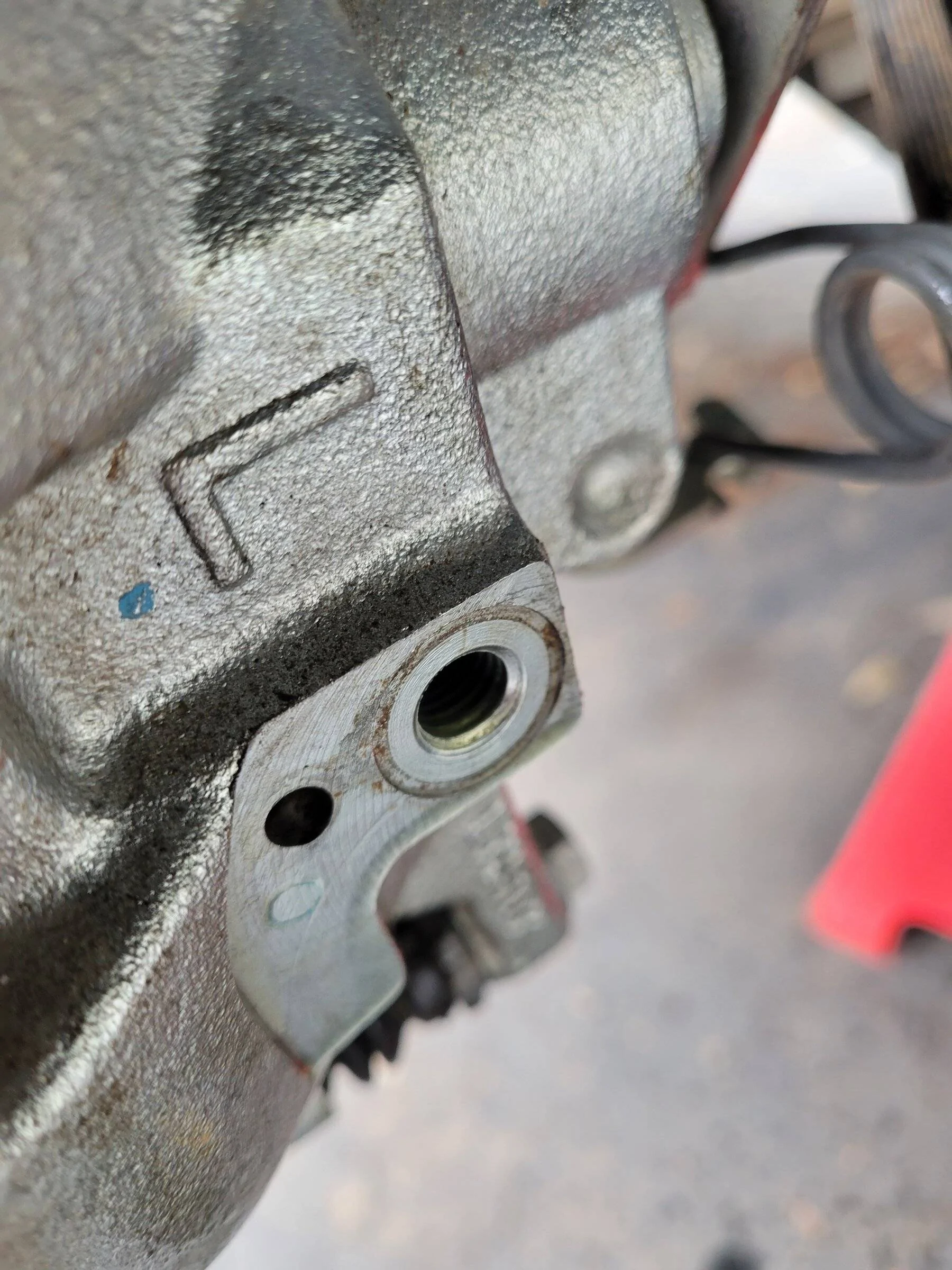

That being said, there is actually a pin designed to prevent it from turning, as you can see in these pictures:

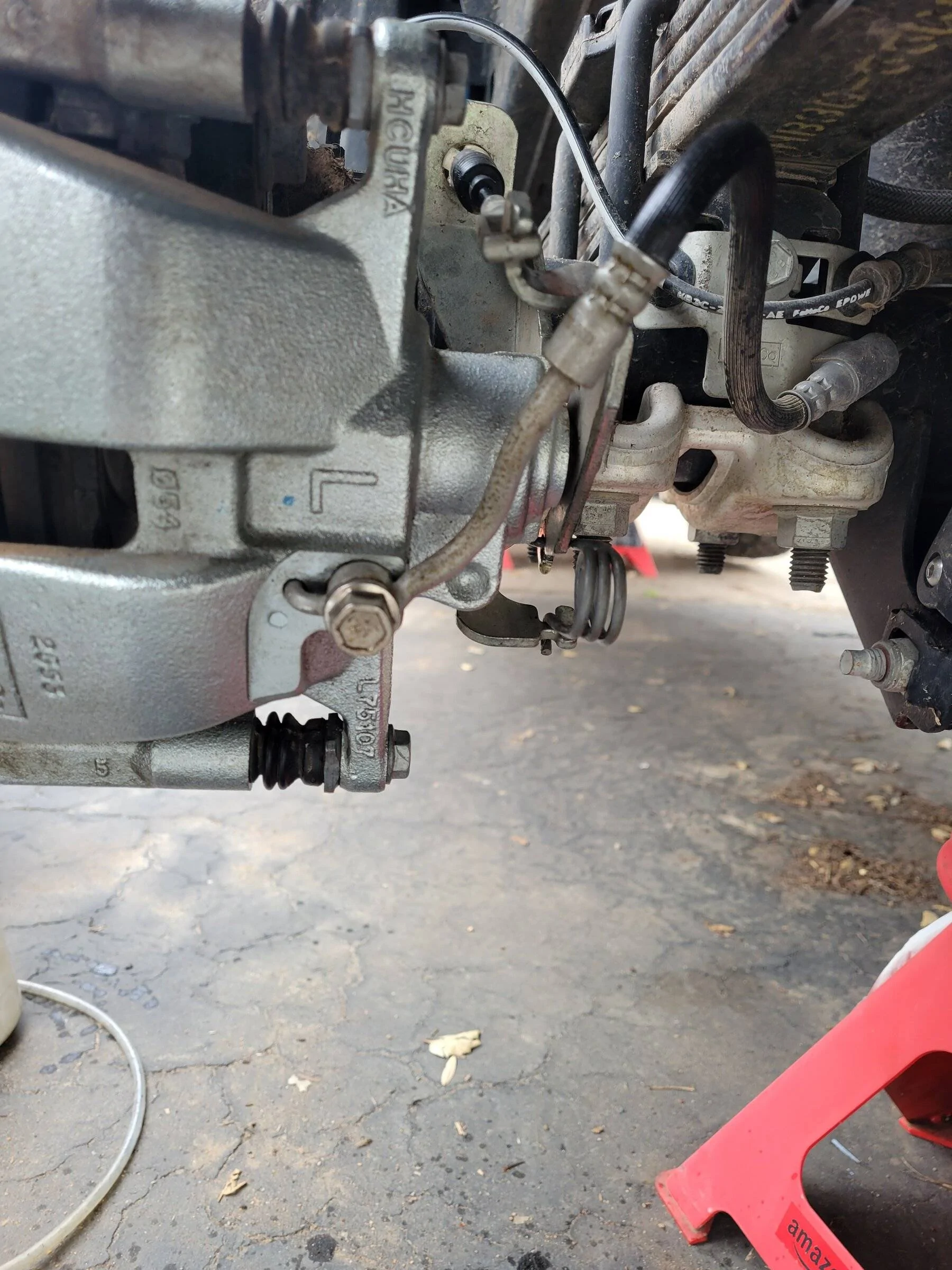

I did end up using my tube bender to bend the metal into a slightly better position (see pic below), and also tightened the bolt very snug, so I dont think it'll be an issue again, but as stated before, I now have brake fluid as part of my recovery gear.
