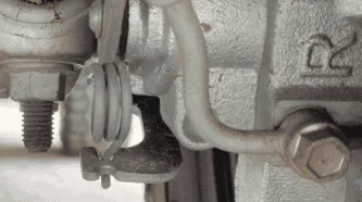

I am not crazy how exposed the torsion springs are on the rear brakes, they are just hanging out in the open. I can see how those can be tweaked or popped off by hitting the right object off road. Saw this after inspecting following an off road trip to Black Canyon near Hinkley.
Thought of putting a non interfering keeper wire to hold the spring in case it did pop off and then would be able to pop back on.
Just need to catch on the spring end at the lower end to pop it off. (Maybe a parking brake return spring?)
Understanding your concern I can say I never had a single issue on my Ranger Taking It Off Road hitting anything near those brakes. It probably helped that I still have the factory wheels with no spacers

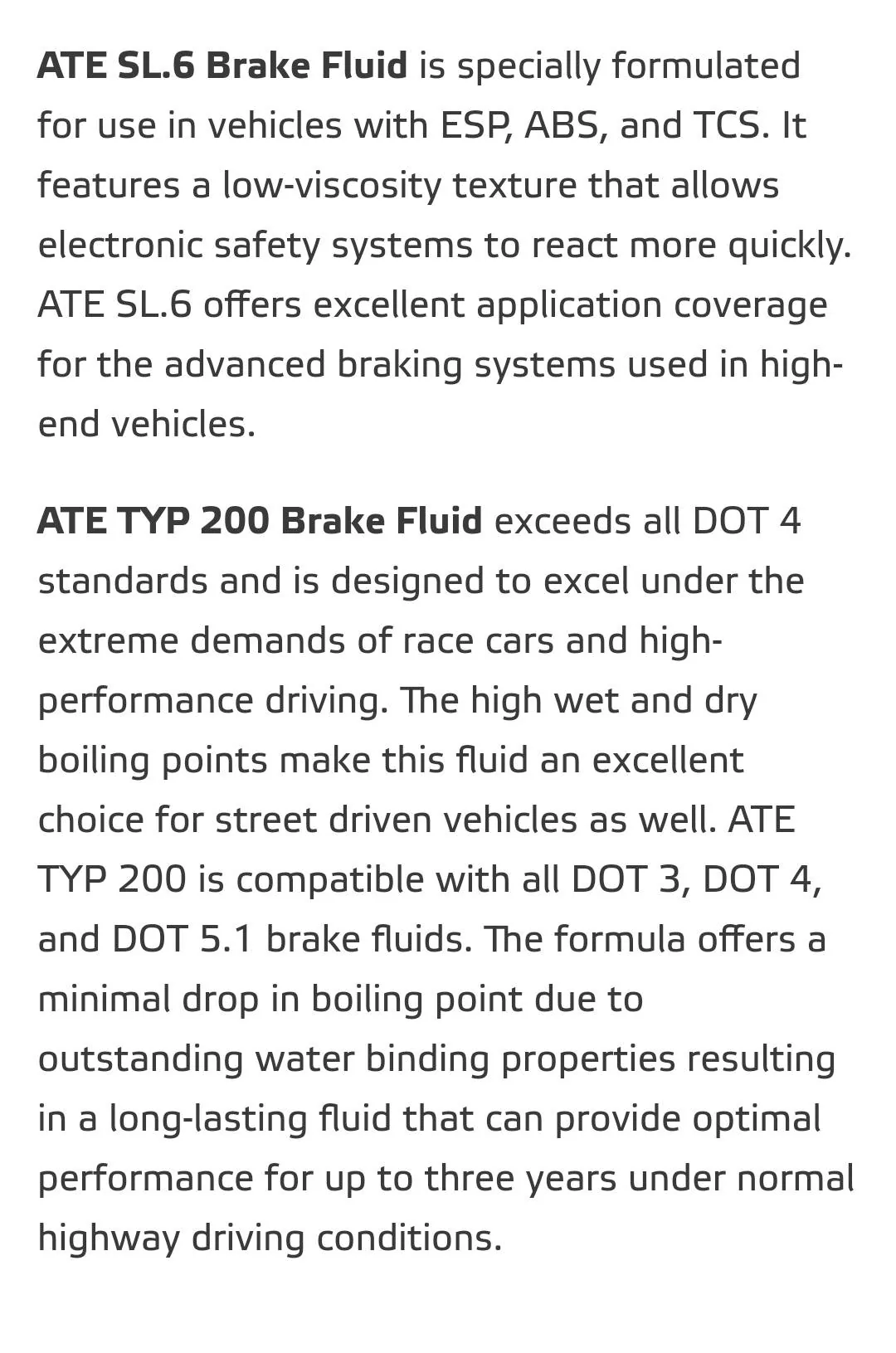

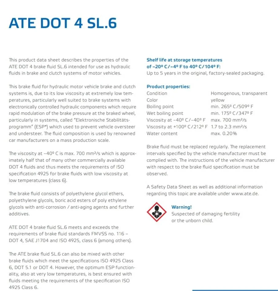

What I normally use is the typ 200, which says is compatible with all dot 4 brake fluids, but they also have the SL.6, which is LV.
I think the typ 200 is an upgrade, but wanted to ask for opinions since we are talking about it.

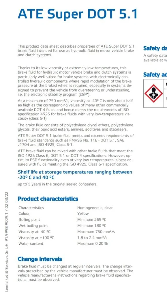

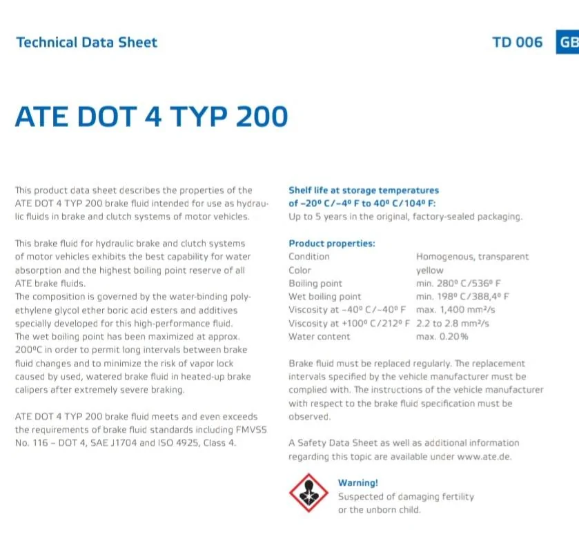

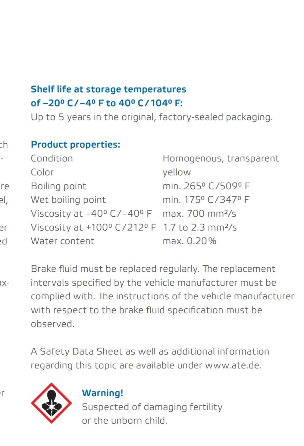

I found the technical data on their website. The sl.6 is indeed thinner than the typ 200 (700mm² max, compared to 1400mm² max), so I will switch over.
Here are the specs, for any who are interested:
Super Dot 5.1
Typ 200
sl.6
Super Dot 5.1
Typ 200
sl.6
Honestly I would just stay woth the factory stuff. Makes thing easier in the long run vs buying aftermarket stuff that may or may not be available later on
