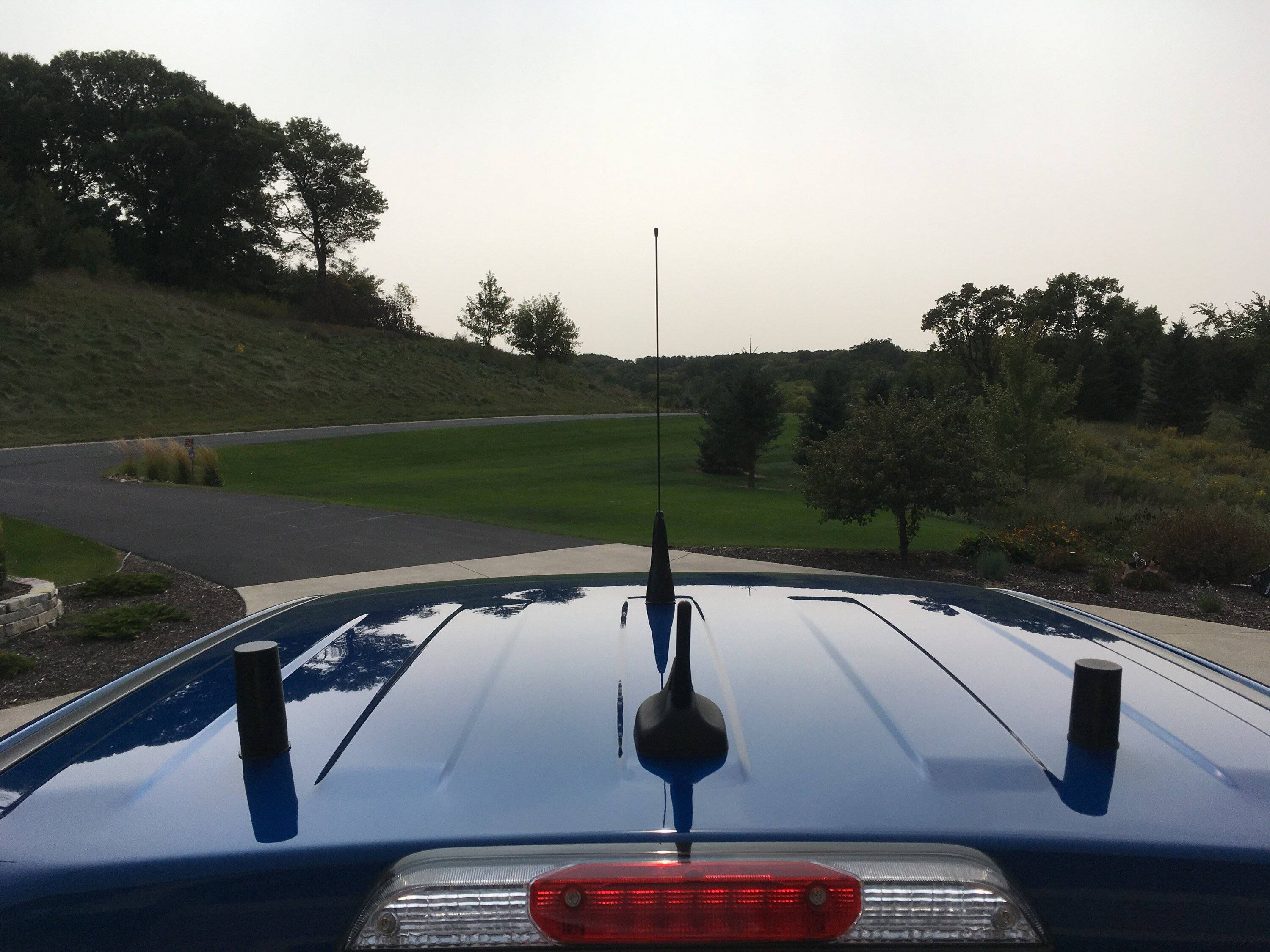

Personally (& professionally), I recommend roof-mount antennas whenever possible. For GMRS (which is a UHF radio), the available antennas run the gamut from about 1-1/4 inch high (Larsen LP450) all the way up to several feet. In this picture, in addition to the factory radio antenna, you will see three (3) drilled NMO (3/4ā€) antennas with the driver side rear antenna being for the UHF/GMRS radio (this ā€œcanā€ antenna is about 3-3/8 inches high & stays on even in the car wash, as do all of the antennas you see on the roof). This can antenna is also available in a ā€˜No Ground Plane’ model, which I might suggest for any model antenna if you are going to mount it where discussed on the far side/edge of the hood/cowl. As a sidebar, drilling on the roof will generally give you the requisite ground plane you need/want, will give you the best signal (hence the best distance), and will be practically invisible when plugged with a $5 black cap when you go to sell.

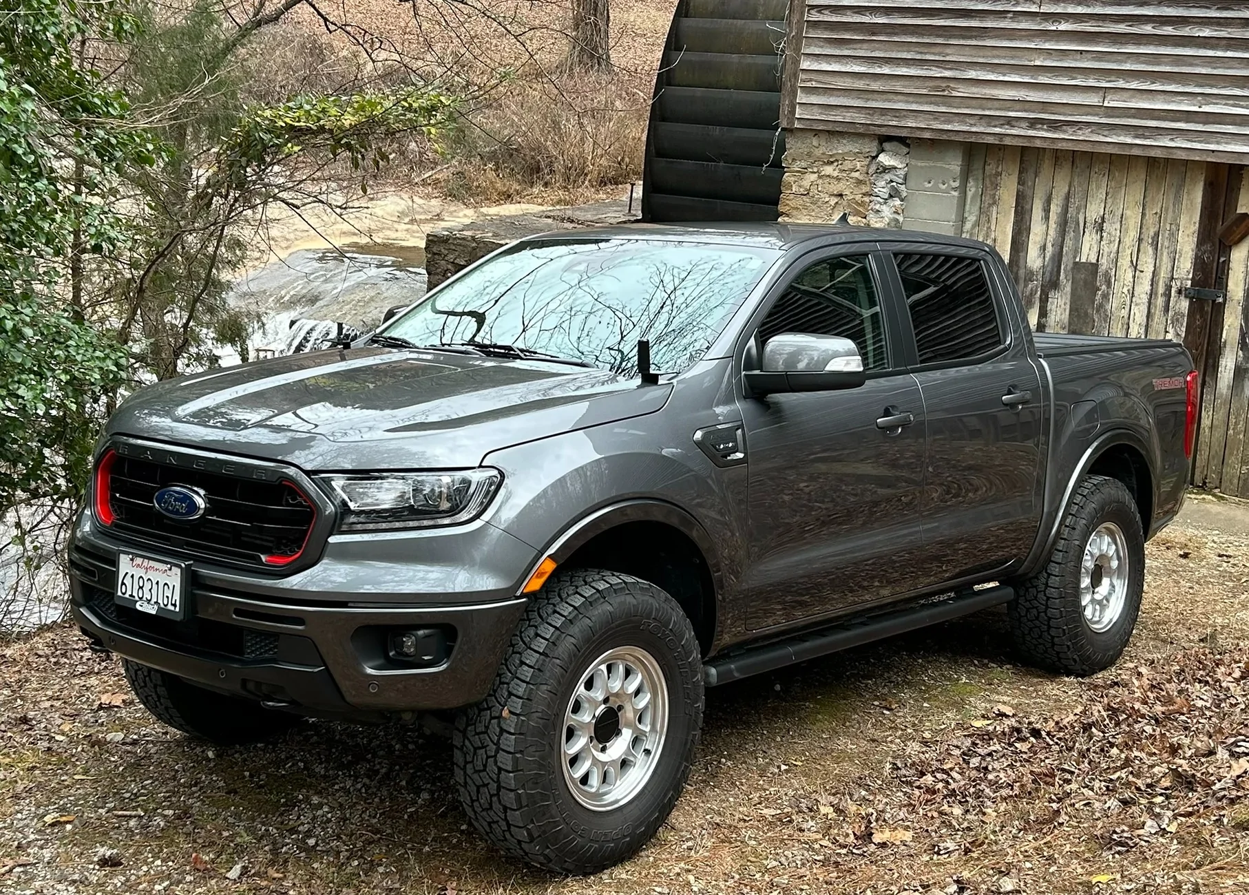

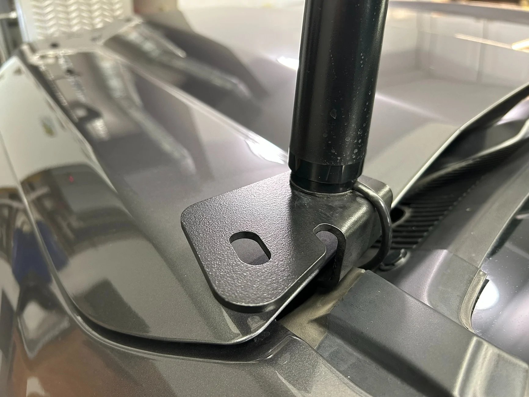

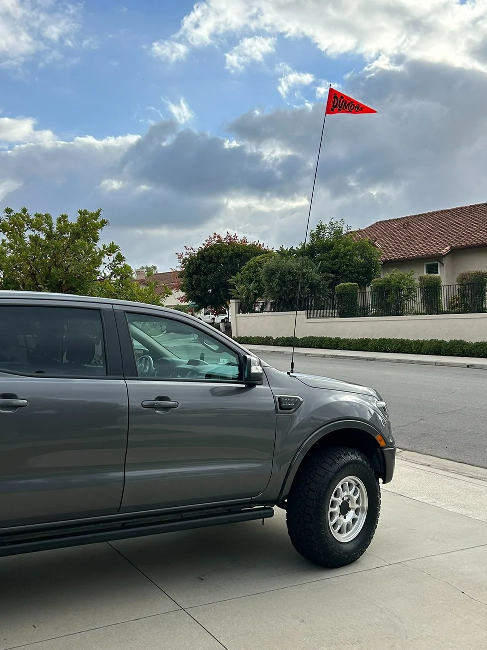

I have a GMRS antenna on one ditch light bracket and a whip attachments on the other. I don't recall which brand but the brackets have holes for two lights so in addition to the antenna and whip, I could mount one small light on each bracket later. They do not make any noise at speed and are super simple to install. I can get more pictures and find the brand if that would assist anyone.
That's a nice setup Jon. I like your truck.
nice truck and nice setup with the ditch light mount. if you could find the brand that would be great. I have been looking at some online.

Ok I found the brand. They did not come with the hole for the GMRS antenna but the flat spot was big enough to drill the holes and still have the antenna fit flat. There is still room for KC Flex Era 3 lights or other of similar size. The brand is Front Runner, the SKU is VACC040, there are avaialble from a number of on-line stores.
Thank you so much this is great. My radio just arrived yesterday so I’m going to have to order this week. I’m probably gonna hit you up for how you did the routing next. Thanks again.
