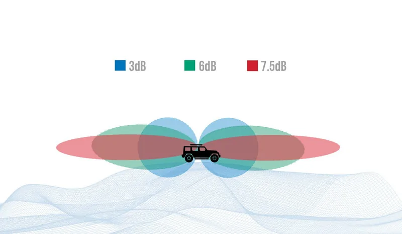

The higher the dB gain isn't always better. I say that because of the way the antenna projects it's beam. A higher dB is going to project further, but be narrower vs the smaller dB that sill project more of a ball. The attached picture helps give an idea of the general pattern for each dB rating.
Understanding-Decibel-Coverage_1_1720x1000_1_d45dcb70-624f-49d1-b748-ae76421d1770-176625_800x...webp
